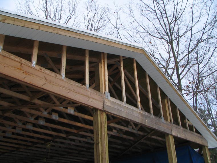

Things got pretty busy for me this summer and fall. I have been traveling around the country installing commercial food service equipment (mostly Taco Bells) for the last 16 years. My wife and daughter were fed up with my constant absence so I put in my 10-week notice. I am self-employed, but I did not want to leave my customers hanging. I ended up working about 14 weeks instead of 10, but then I had to hang it up. I have been working on the barn as much as possible since around Thanksgiving. My younger brother was in town for the holiday and he gave me a hand for a few days. He helped me hang all of my F-channel for the rest of the soffit as well as giving me a hand figuring out how much steel to order for the siding.
Here is a picture of the completed soffit on the front of the barn.

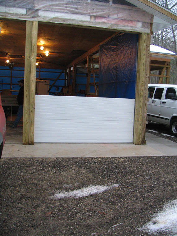

This picture is from inside the barn looking out towards the front where the three overhead doors will be. I also got the plywood up in this area before they showed up to install my new doors.

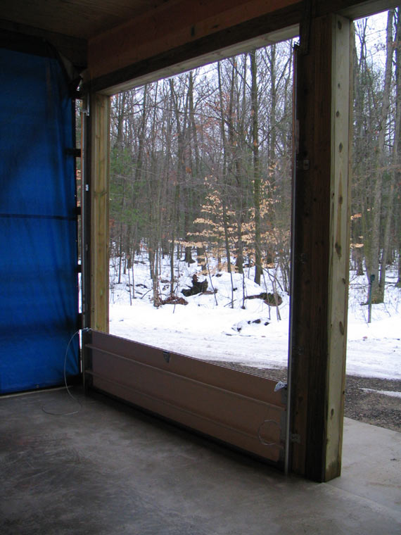

I was out there until almost 10 pm on Tuesday trying to get enough plywood up before my garage door guys showed up on Wednesday morning.
Here is the first door panel being installed.
