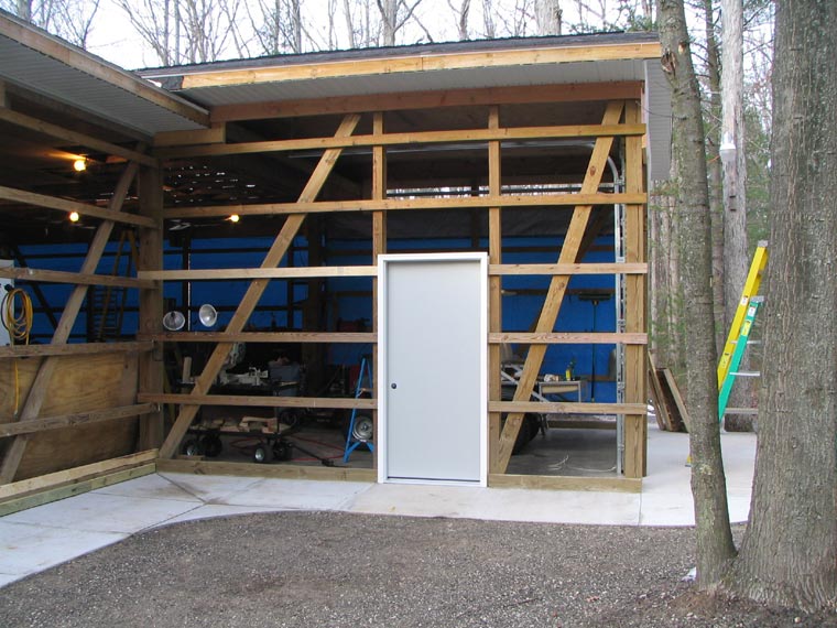

Re: Spencer\'s Pole Barn Project
One more picture to share this morning.
I installed a 36" by 80" entry door on the barn yesterday. This is the first entry door that I have ever installed so I am quite pleased with how it turned out. It is perfectly plumb and level and secured with 3 1/2" screws. I will probably go out and purchase a lockset for it today. Not that locking the door will do any good at this point, I just want to be able to use the door without it swinging around in the wind.
After the entry door was installed the barn really started to look more complete.

Spencer,
It looks great. There is a certain satisfaction that you get when the small pieces of a big project fit together.
On your entry door installation, did you follow the manufacturer's instructions and put a bunch of silicone under the threshold. My contractor did not and water is constantly coming under the door with every rain storm or snow melt. I installed the same type door in another building and followed the directions and have not had any rain or melted snow enter from under the door.
You are doing a beautiful job.
