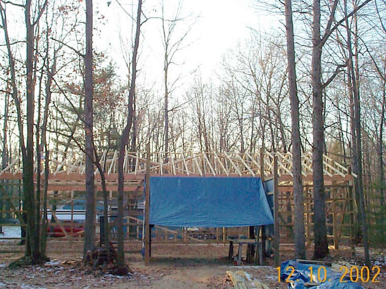

As most of you know I only have half of a roof on my pole building and a few tarps up for make shift walls. Of course I needed to mount my panel on the side of the barn that doesn't have a roof on it yet. So I made this enclosure to protect the panel from the elements. Now its not NEMA TYPE 3R rainproof but I think it will do.
By the way I am pushing to get power now instead of finishing the roof because I, and everybody around me, are tired of hearing my 7500 watt, 14 h.p. generator blaring away for hours and hours.
