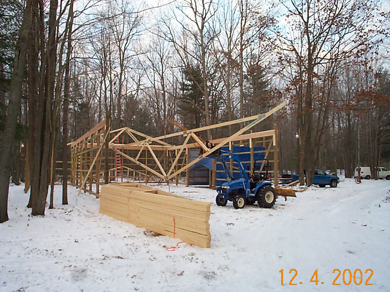

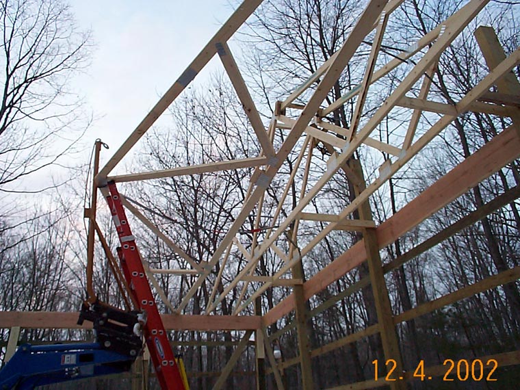

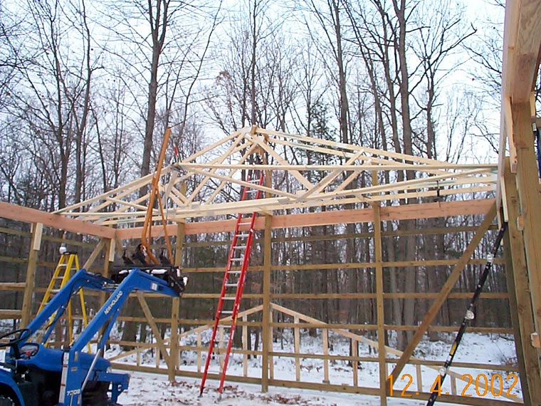

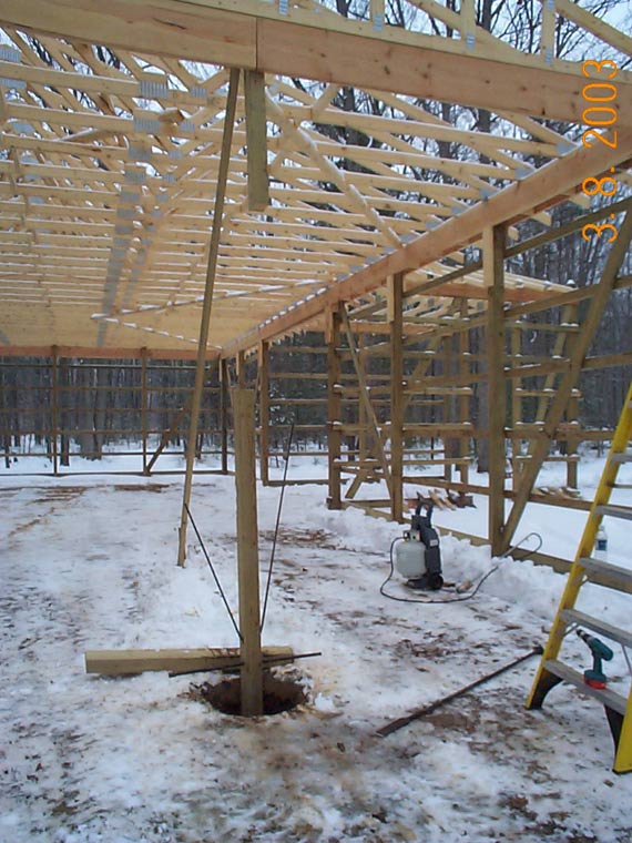

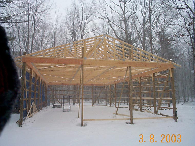

I haven't had much to post about lately. I set the last 32 foot span truss last weekend. The weekend before I set 8 of the 9 16 foot span trusses. To finish up the trusses all I had to do was set two more poles, nail a 2x10" truss carrier across them and then set the last truss. I was planning on setting those two last poles today so I went out last night to plow some snow around the pole barn. Well, I got to close to one of the poles /forums/images/graemlins/blush.gif. I had the fel raised up pretty high so that I could see the light from the front headlights. The next thing I heard wasn't a pretty sound. Here is the first attachment.

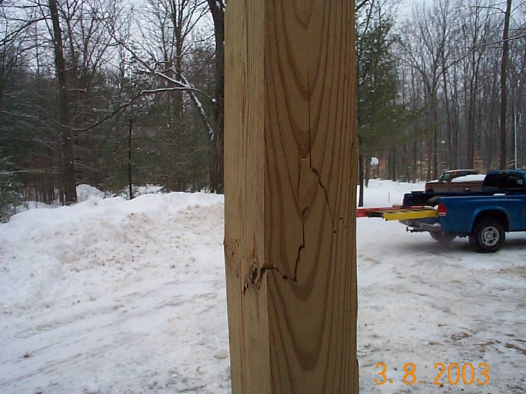

Close up shot.

I didn't enjoy taking the chainsaw to my pole barn but it had to be done.

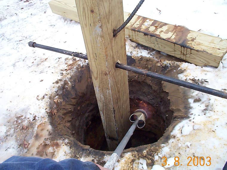

I drilled a hole through the pole and put some 1/2" rebar through it. Then I lifted up on the rebar with my forks. The concrete I had poured around the base of the post was larger than the diameter up the top of the hole. That piece of rebar held up pretty well but I later had to switch to a piece of 1/2" pipe.

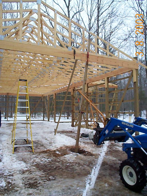

The ground was quite frozed so I had to take my propane torch to it to thaw it out. Then I chipped away at the ground to make the hole larger.

Ahh, its out.

New post going in.

All better now, just a wasted Saturday.
