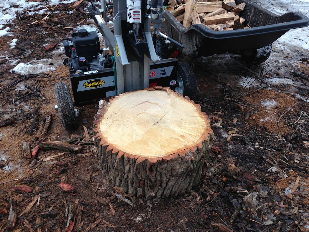

I have the 28 ton Speeco purchased from Farm and Fleet in Madison. No problems.
Edit: Here it is about to split a pretty big round. My brother counted 140 rings. These were *very* hard to get to the splitter, without vertical operation it would have been impossible to deal with them.

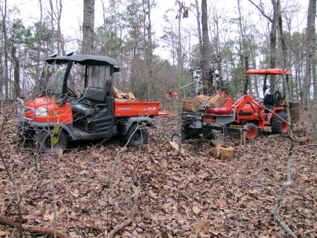

IMG_2307.jpgIMG_2309.jpgFor me, I back up my RTV on the side that I stand and operate. I can then just toss, reach over and stack, or hand to a helper for loading. On the other side where the very handy Speeco option of the shelf gizmo is, I bring up the big rounds and hold them with my tractor bucket. Makes for a great system for productivity. For lengths my Harman, TLC 300 top or front load, it's easy to use pretty much any length below 27" but I tend to use around 16" or so. The 35 ton Speeco/TSC just crunches through hickory forks just like it does with pine...........However it is done, it's a joy not to have to beat myself silly with a maul, sledge, or wedge..........Yes, getting old does give one an excuse to use the easy, NOT workout way of doing things...........God bless........Dennis
