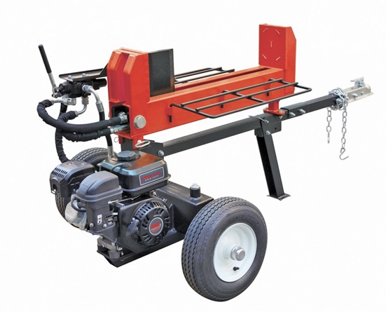

Take a look at the Harbor Freight 2 way splitter. I have the Northern Tool version which is no longer sold. The cylinder is below the work area, so it splits both ways, no retract stroke needed. I had a dual direction 4 way head made for mine which really increases productivity. Mine is a Powerhorse engine and always starts on first or second pull, even after sitting for months. I’ve heard good things about HF’s Predator engines.
I looked closely at that splitter. It's a good design; my only beef with it is the height. It's a bit low, which is hard on the back. I've seen workarounds (blocks under wheels). If it had been on sale, and/or carried in the HF retail store, I probably would have bought it.
I replaced a B&S 6.5 on my Husqvarna tiller with a similar Predator. Runs great. Wouldn't hesitate to use one again.
