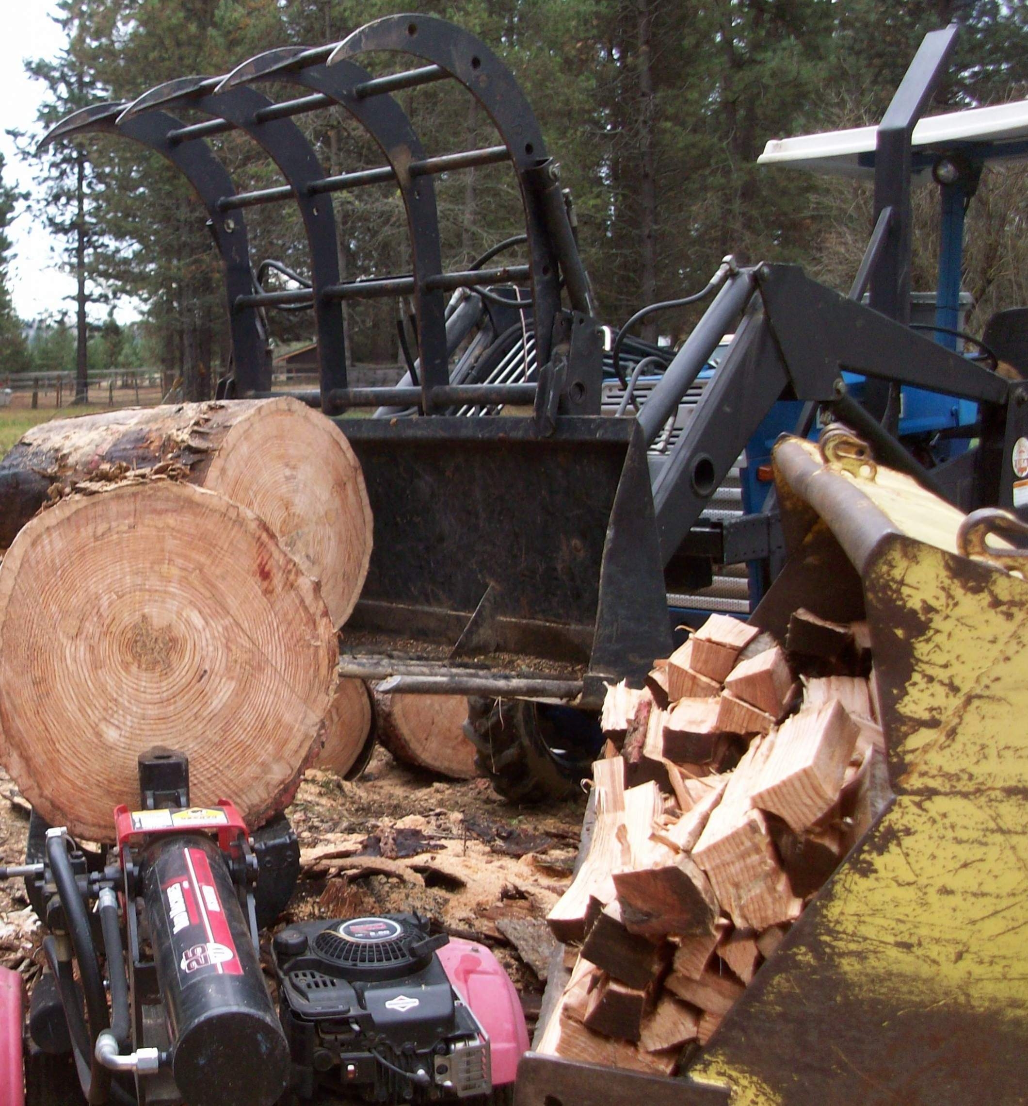

I've always wanted to go back to burning firewood. I have 100% Ponderosa pine here. I did burn firewood for the first ten years we were here. I liked everything about this. Except - the dirt and bugs that came into the house with the firewood.
That was 40 years ago. Now - I would need a larger splitter with log lift/log split catch systems. The pines here are all VERY large and not the easiest to man-handle. That's the reason we got away from firewood.

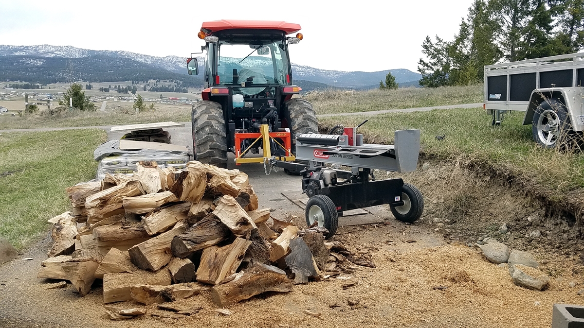

All I can add is that I have an Oregon 22 ton log splitter that I bought used for $1,200. It has a Honda engine and has split maple that I couldn't split with axes or with wedges and a sledge hammer. It's not fast, but it works well. I might not be as pleased with it if I'd bought it new for $2,500 or so. It was barely used so a good deal when I bought it in April of 2022. I didn't want one of those full-on Chinesium models that sit outside Home Depot or similar but wasn't keen on spending $3k or more on a really nice US made model.
I do plan on adding some additional protection for the engine, and a rain cover for the hydraulic oil filter and oil fill plug.

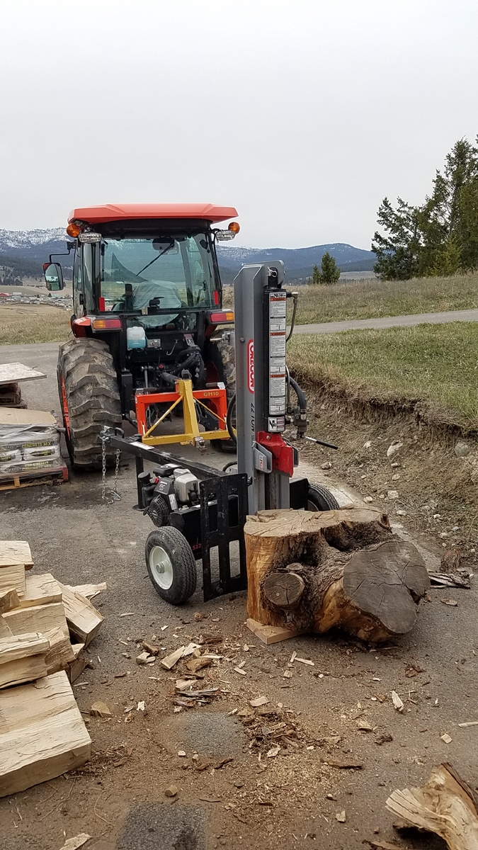

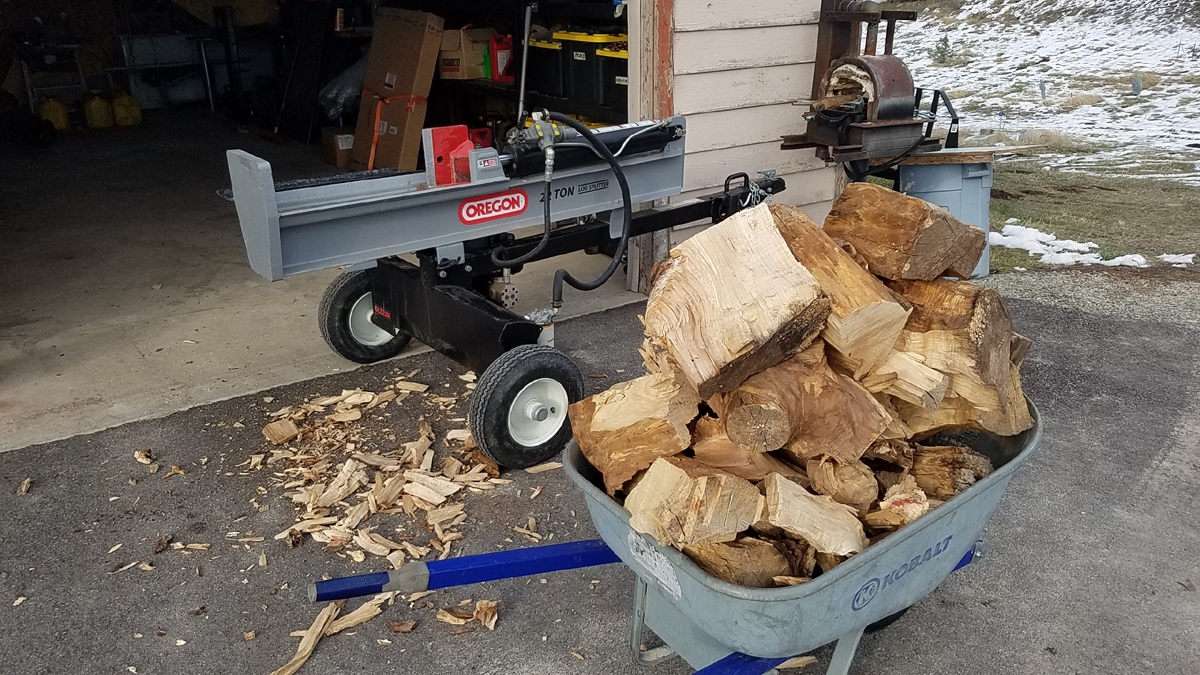

I see in your vertical position you use a spacer on the ground (middle picture) so the rounds lay flat to make it easier. (y) Out in the woods I can bury the end in a low spot to do the same. Also, it looks like the Oregon is made by the same people that made Speeco splitters. Good to know if you ever need parts.

My Oregon splitter has one serious drawback that I think a lot of H/V splitters share. Tree debris falls off the rounds on to the splitter. When retracting the ram the back of the wedge pushes them up the beam where they fall off and land on the hot muffler. I once quit a splitting session and then came back later to find that the tree litter on the ground around the splitter was smouldering! I was lucky that it didn't start a fire.
After that I made a shield for the muffler out of a scrap cookie sheet. It's ugly but it works. It catches the litter that falls off the beam and is cool enough that litter on it does not smoulder.
