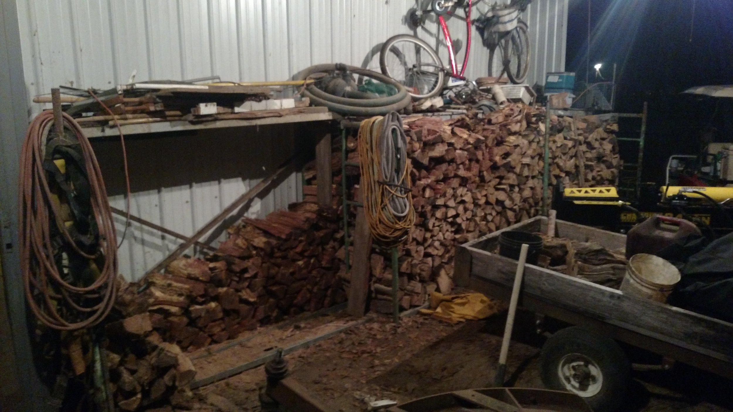

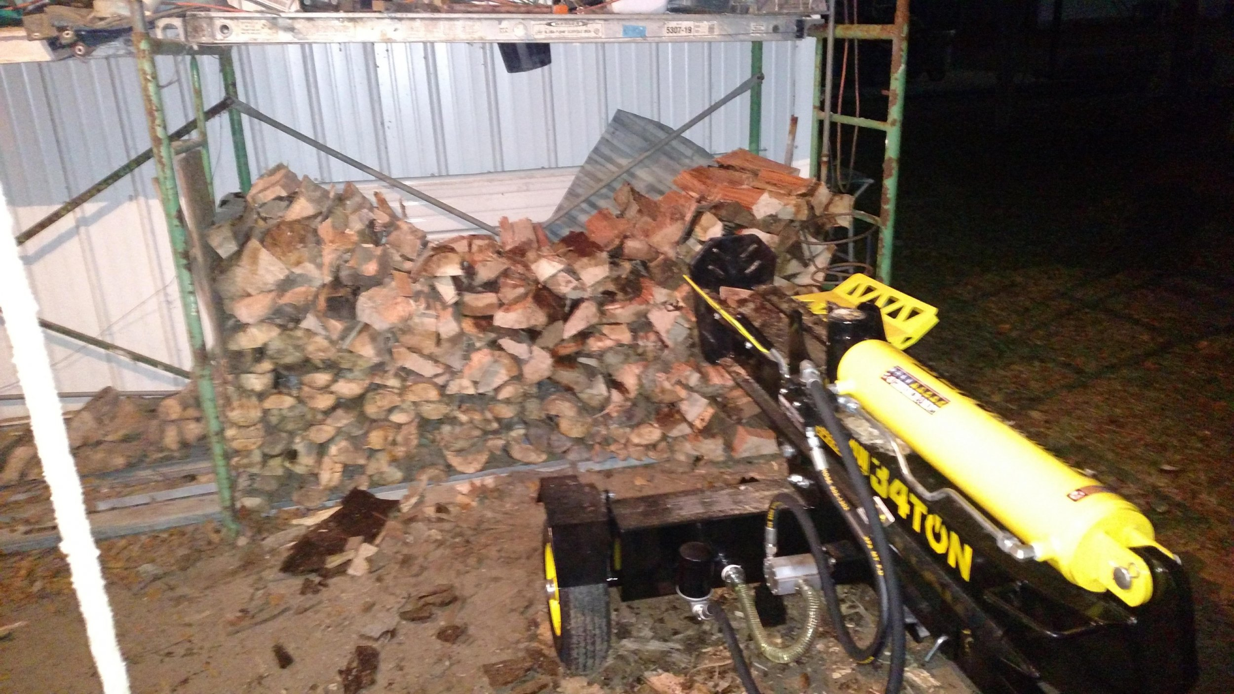

The Timber Wolf looks like a very nice splitter to me. I got lucky a got a used splitter about a year ago from a guy moving, I think a gave $800. I know what you mean about stuff being in the way. I included a picture of mine. When I’m splitting with it horizontal I’m working around the tire, I’ve gotten used to it but it is in the way. The only thing I see wrong with the Timber Woof is the cost, not cheap but the log lift looks nice.
