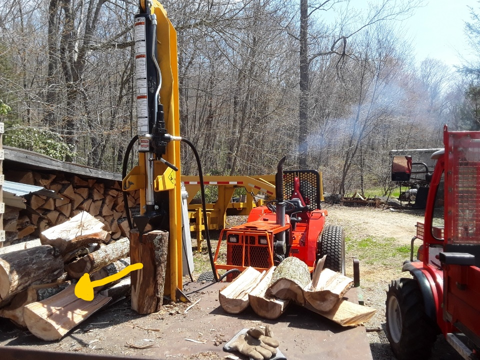

One question Code54, did the wood fly (this is hard to explain) away from the wedge as the blade cuts through like when an axe is used to split, and the wood goes right and left of the axe head? (picture 1)
Or did it fly straight out along the path of the edge? (picture 2)

To answer a few questions. I was splitting Pin Oak and it was cut a month ago. I have used the splitter since the "incident," and it is working perfectly, and the ram is moving slowly and smoothly. Nothing flew out and it is the same batch of wood. I believe it is an 11-second cycle time, so it is nothing too special. The wedge is sharp - actually sharpened the night before the incident along with a engine oil change. I found the split that hit me (it was easy since every other piece was stacked in the log rack) - no knots and no forks - just very straight grain. At the time, I did not hear the machine bog at all. I split around 4 cords so far this year and understand the bogging sound and always step back and away when I hear it. This was running smoothly. I did notice that one end was not perfectly straight but nothing too crazy.
I often wear a logging helmet, but honestly, this one hit me so hard that I am pretty sure the face screen would have easily folded in (still would not mind having it on). I told my wife I think I am going to wear my full-face motocross helmet from now on!
After going to the facial surgery center yesterday I found out I actually "shattered" the lower orbital and broken the sinus cavity a bit, but nothing too bad and luckly do not need surgery. The stiches are out and that will leave a scar above my eye but hey I am old and married so oh well. They even said my eyes are both still even so I would say all for all it turned out pretty well.
