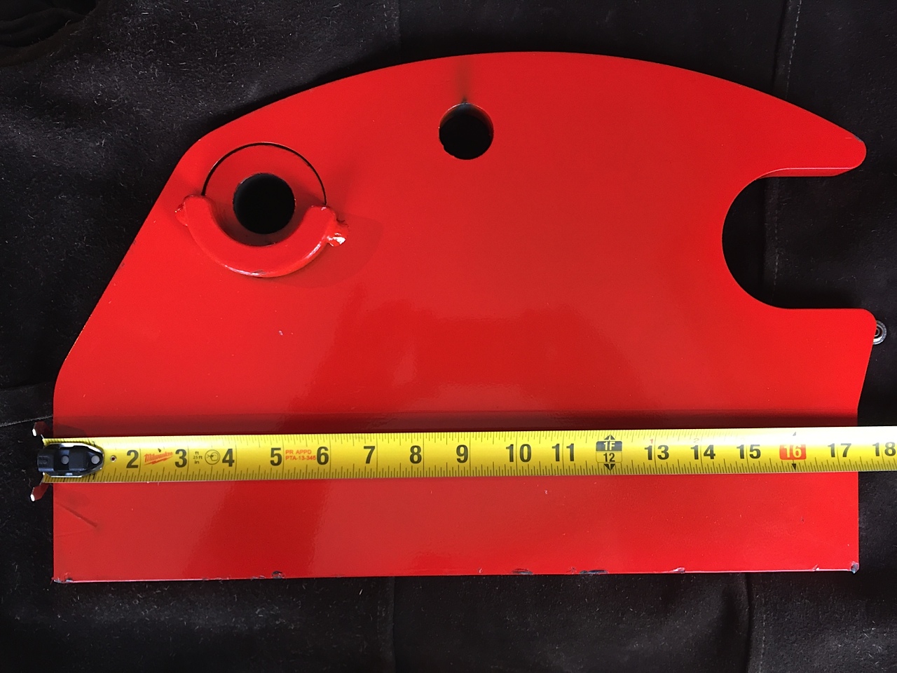

A friend built a ripper for his M59 and was surprised to find out how much $$ he had into it when done. Here's a photo of one of the QA ears he ordered from Kubota for the project.
Nice build! The primary (and weighty) reason to steer away from a narrow bucket is the difficulty of unloading them in sticky soil.

Those ears do not look at all like the ones on my L48.
I love the ones I have.
Same as mini ex I think.
My M59 buckets are different from my KX-040. BTW practically every different class mini takes a different bucket.
