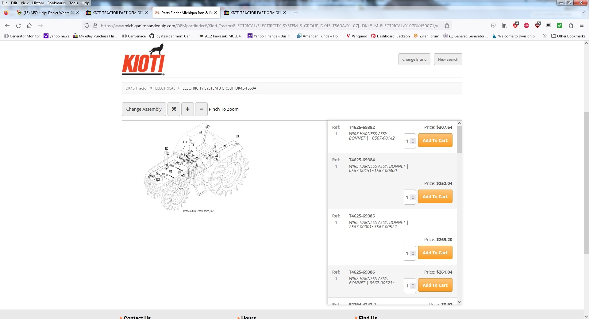

Well, first off, the OP opined that the dealer was getting sick of working on his tractor, so likely the price was inflated.
Secondly, $295 sounds woefully inadequate for a wiring harness on a tractor that was built in this century. An 8N, OK.
Similarly, I can promise you that even if a factory trainer Kubota tech could replace it (mind all the grime that is in the pics) in 3 hours, ain't no way that is the published labor cost (no doubt in part because of the anticipated grime).
Nevertheless, $6k is over the top. Most likely due to my original point.
dont bet on it. mine was replaced several years ago....heres an equivalent kioti dk45 harness
heres michiganiron site for dk45 wiring harness

who would pay $6k for a repair to a 12K tractor, when its only a simple wiring harness. there plug and play install. start at one end and replace like for like as you wrap around tractor. mine tool me about 3 hours as i was being very careful and securing loom as i went along.
they list a JD1023e wiring harness kits from $525-750 new
That doesn't tell me anything. Do you need ONE of those things, or TEN of them?
.? Only one. There are 3 variations depending on options like cab or cab with air, etc.
