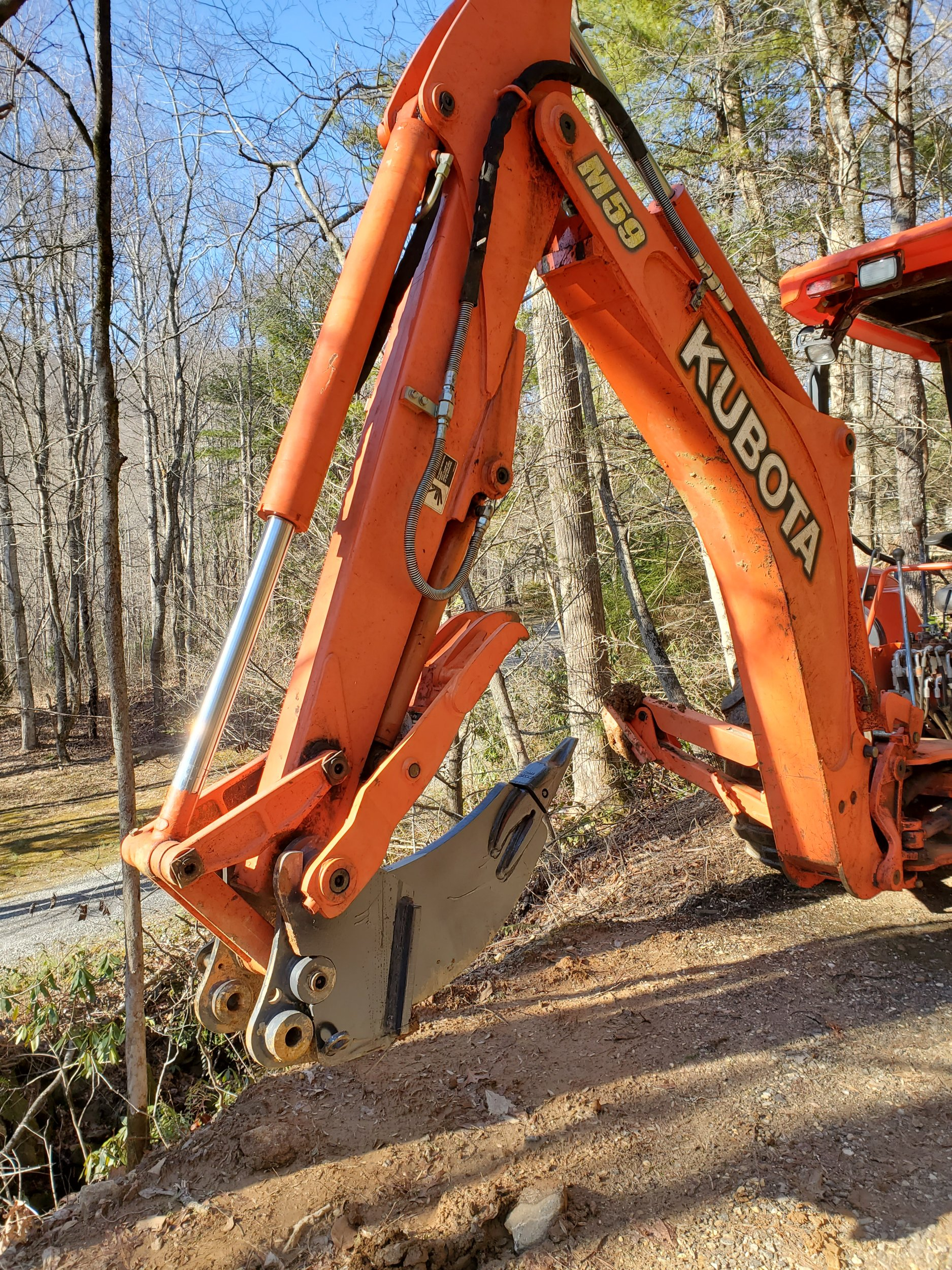

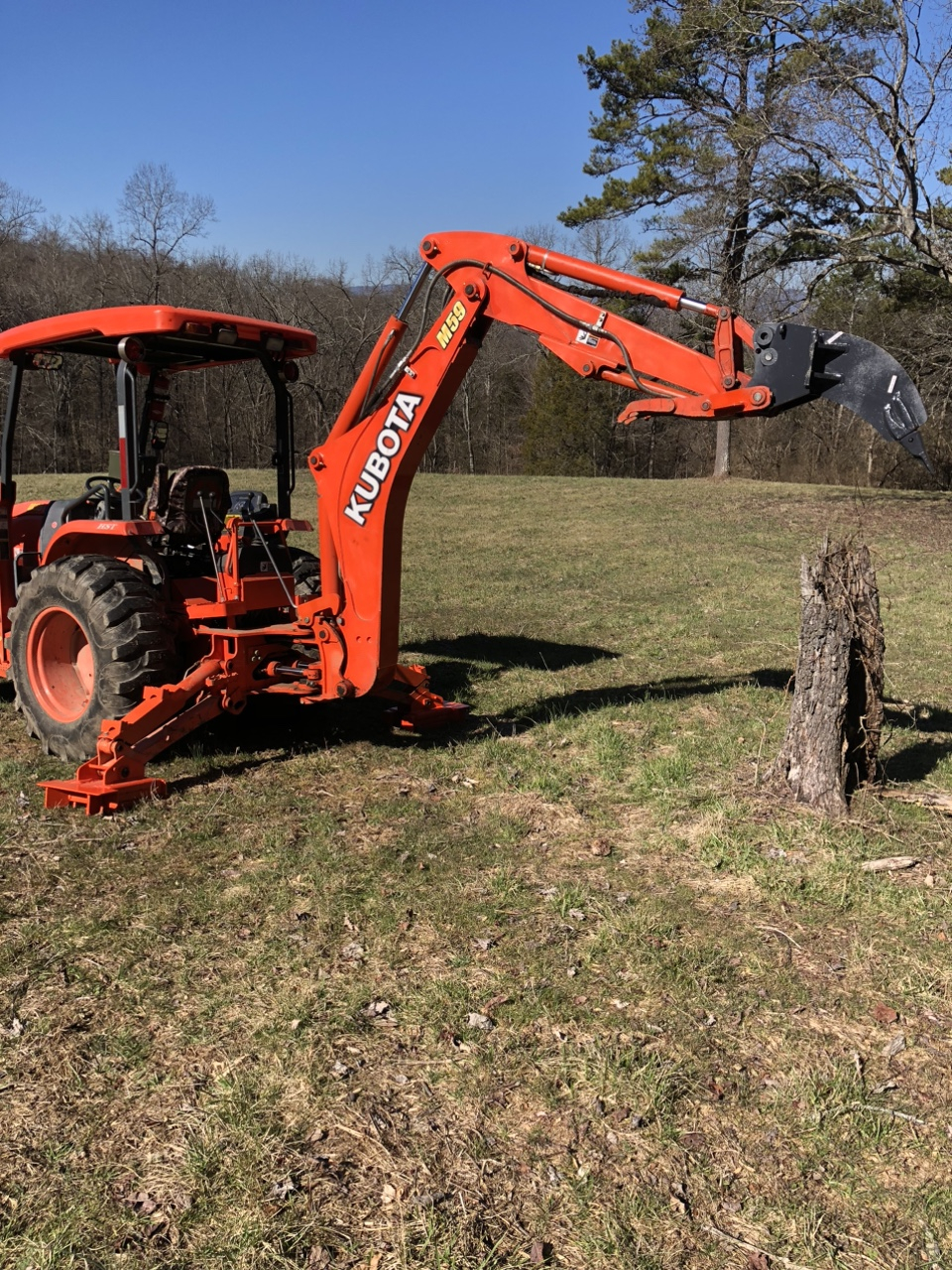

Just received and installed a root/ frost ripper onto Kubota M59 TLB modified with quick coupler that mates to the Kubota KX excavator series of buckets and tools and was mentioned in earlier thread ( Backhoe - M59 backhoe quick attach) started by Smokeydog.

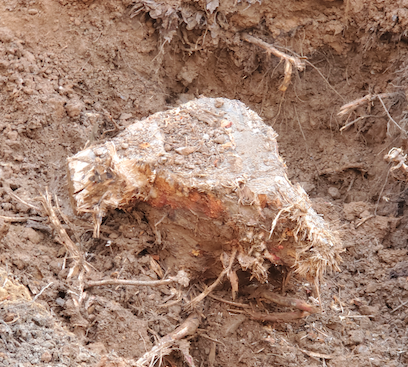

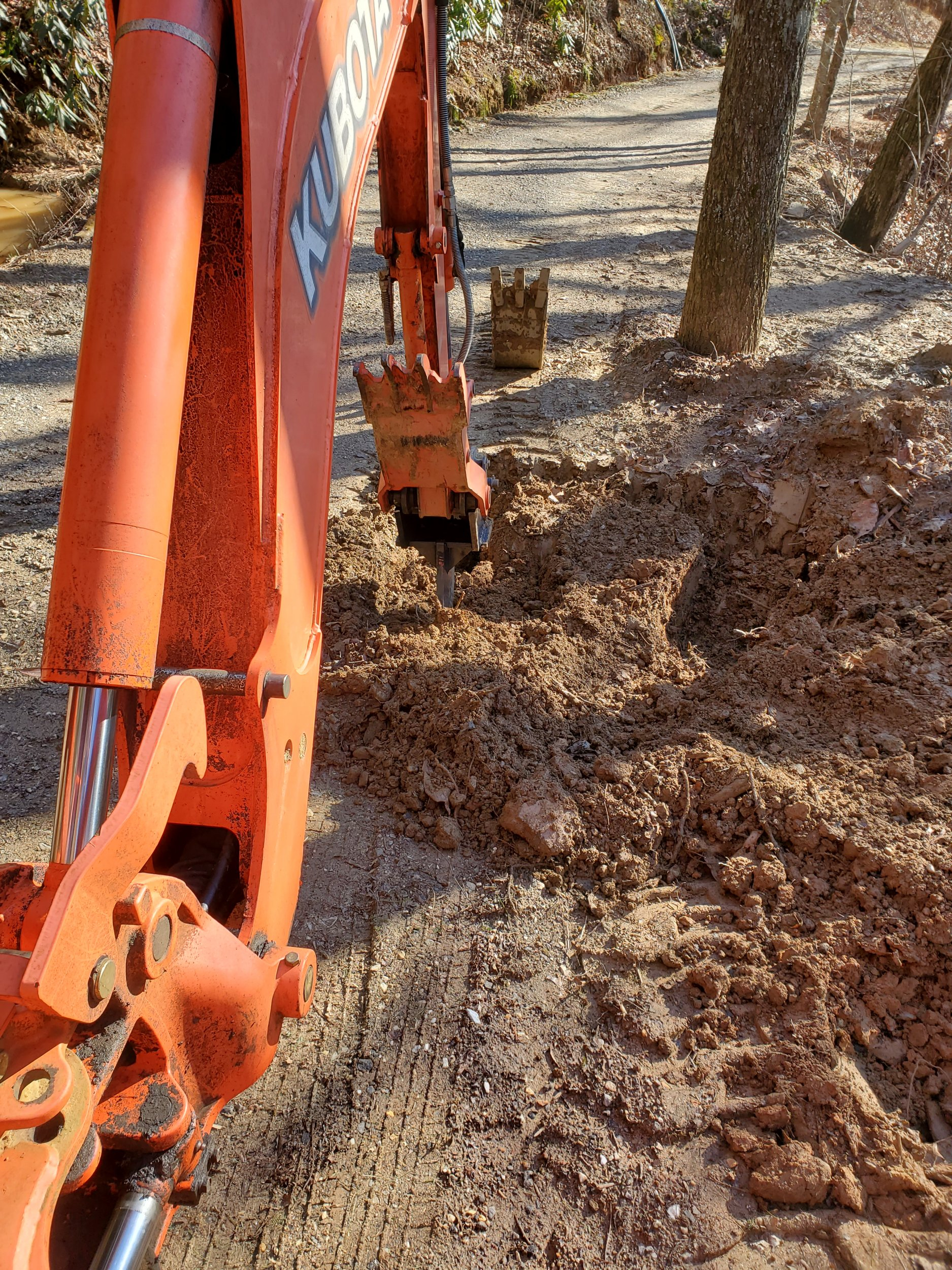

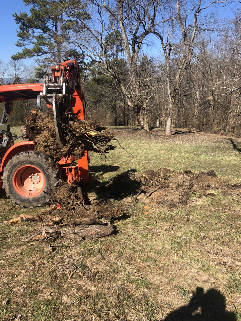

In another thread ( Digging stumps SA425) started by Scott440 I mentioned I spent two hours trying to remove a 20+ inch stump and gave up after making poor headway. The 12 inch excavator bucket couldn't break the roots and I didn't want to dig a 10-12 foot dia hole to get stump out.

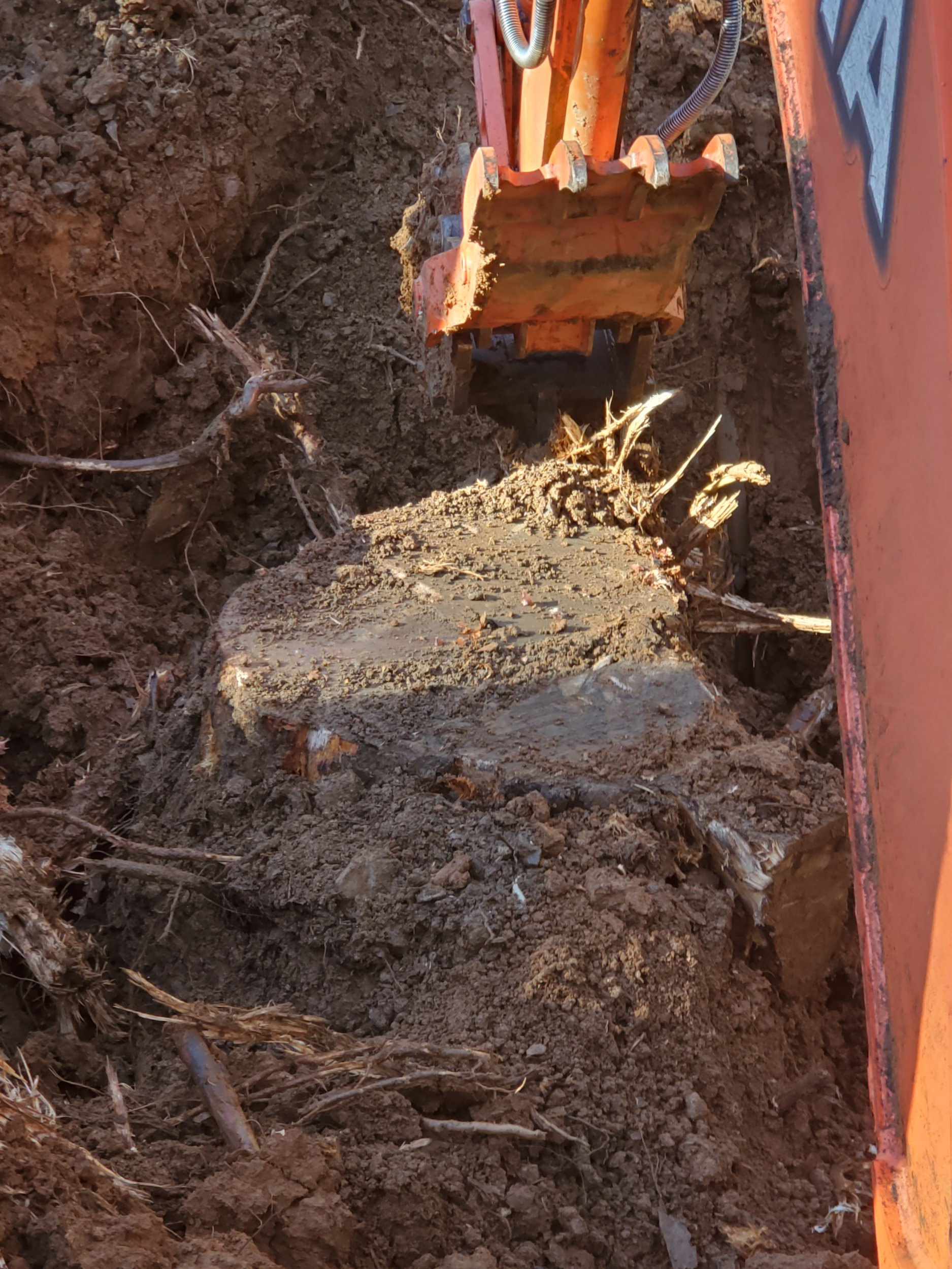

Spent two hours and stump is out of the hole. Hole ended up about 5-6 feet in dia and 5 feet deep. Broke 5-6 side roots of 4-6 inch dia and tap was massive.
More fun with quick attach backhoe tools.

I will compare the M59 to the KX40 which you running. Kubota indicates the M59 has 7600 Lbs of bucket curl force and the KX 40 has 9500 Lbs of force.
I spent 2 hours using the KX40 bucket and was unable to break roots at/ close to the stump. Gave up and came back at it with the root ripper. Two hours later had stump out of the ground and only added about 10-16 inches of extra space to all sides of the stump.
Had I continued with the 12" bucket, I figure I would have spent 5+ hours and had a hole 10 feet in dia. in order to break/ loosen roots further away from stump.
Bottom line. Root ripper saved more than 50% of the expected bucket time and the amount of excavated dirt was less than 1/3 of what would have come out using bucket. Ripper absolutely worth the money to me.

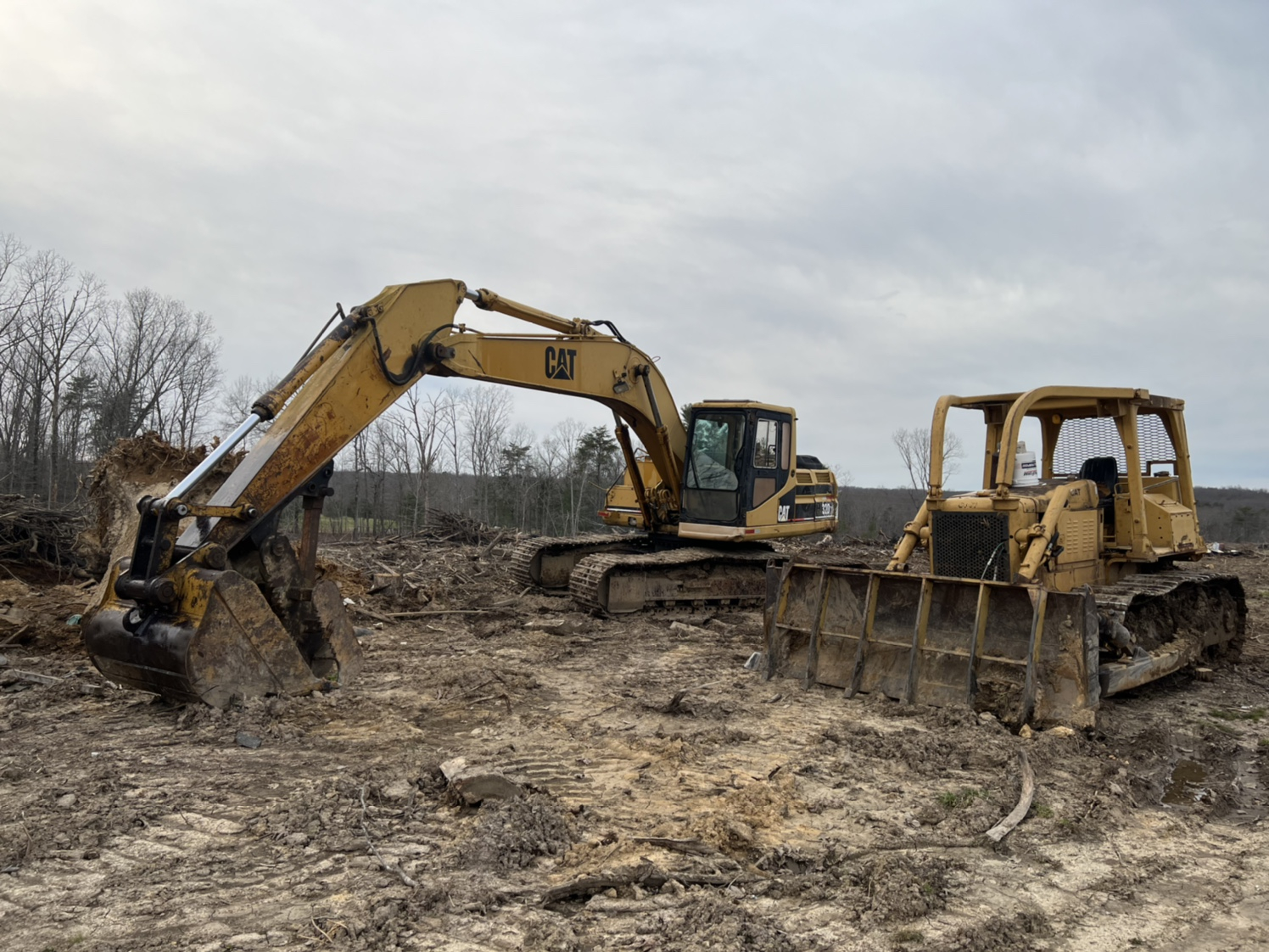

I’ve got a Cat320L and a D5 dozer. I wouldn’t count on the D3 to do much with a stump. If you had a ripper on the back you might could bust up a stump but the dirt blade won’t do much.

I needed something to dig 25 acres of hardwood stumps.

I’m probably going to order a stump ripper for the 320. You can pretty well move the 320 in one piece with a regular semi and you could probably do the same with a 330 but much bigger and things get considerably more difficult.

I’ve got a 20 ton machine on the job.

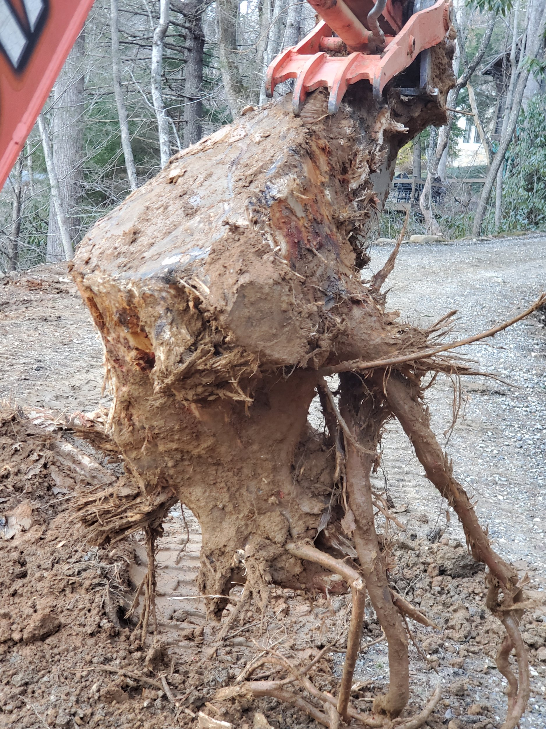

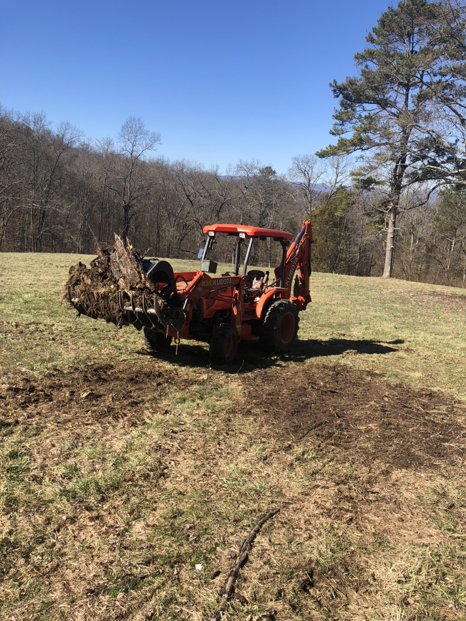

First stump with ripper. 14” Persimmon, 24” at base.
Used the front grapple to rake and wheels to compact hole spoils several times.
Stump moved to gully digester. 30 minutes total time.
Agree considerable less time and ground disturbance over a bucket. Good attachment for this little machine. Much use in its future.
Mega outrigger pads, outrigger steps, hand thumb control and KX quick attach made for an easy and fun job.

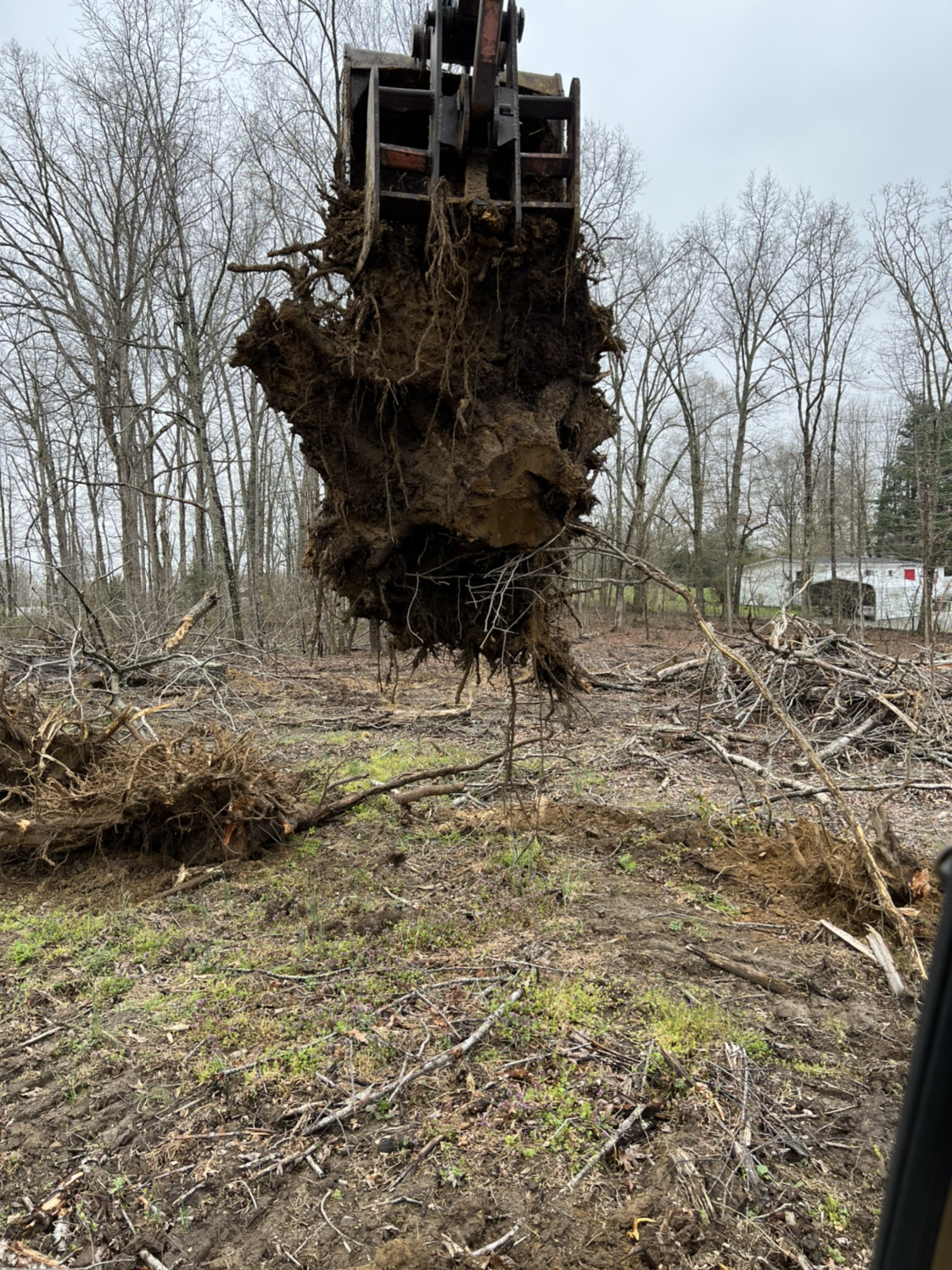

I wanted a root ripper for the same reasons.so I welded some old pieces together and stuck a Cat sticker on. It really does speed up stump removal, but I concerned about my windshield or I just have to remember to open them out of the way.
