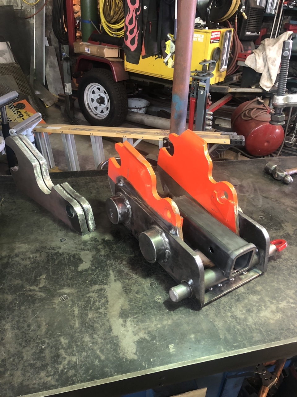

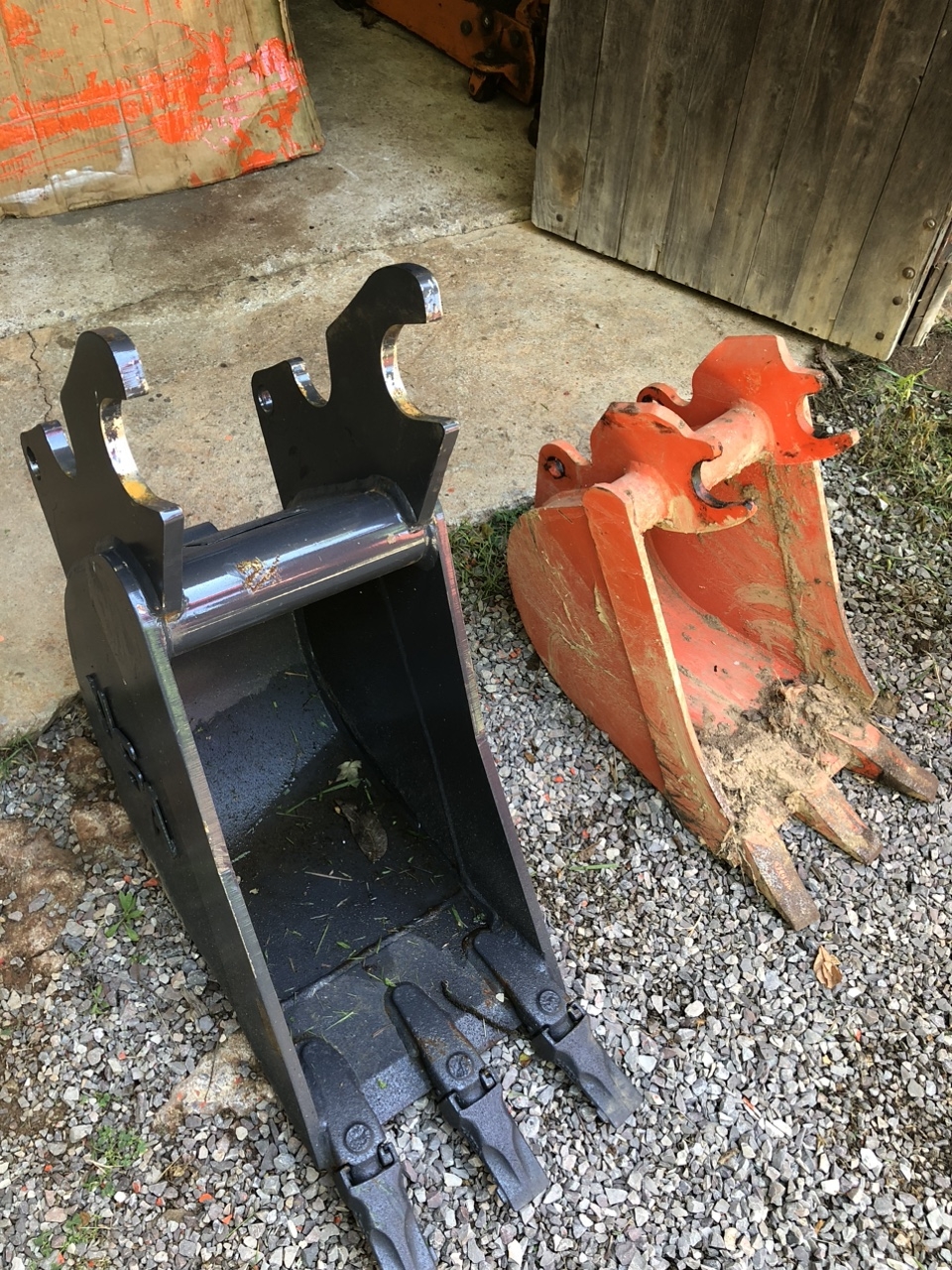

Working slowly on making an attachment that will allow the backhoe to share attachments with the M59 with KX- miniX attachments. Most will probably be too big but hoping the ripper could help with some delicate maintenance. Also there is wide assortment of tools and cheap ears for other tools.

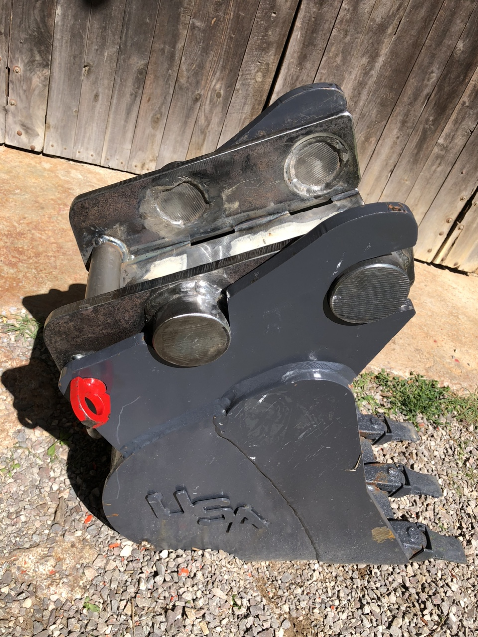

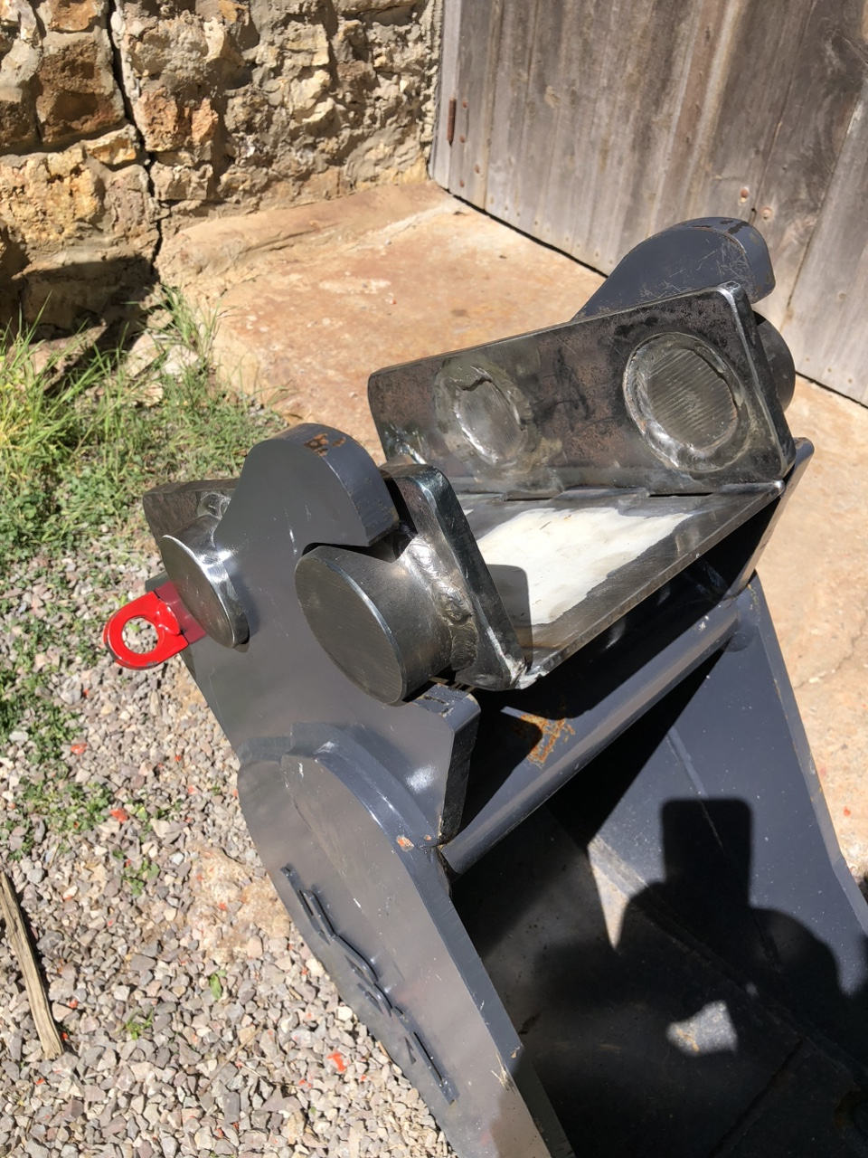

First made a coupler to fit the KX- attachments.
Not a machinist or professional welder. To give the pucks greater strength, inset into holes in the side plates and that doubled the weld area while giving mechanical strength. Rear DOM tube for attachment pin. Great design but does require all six circles to line up properly. If making more than one, a jig to position and weld would be time well spent.

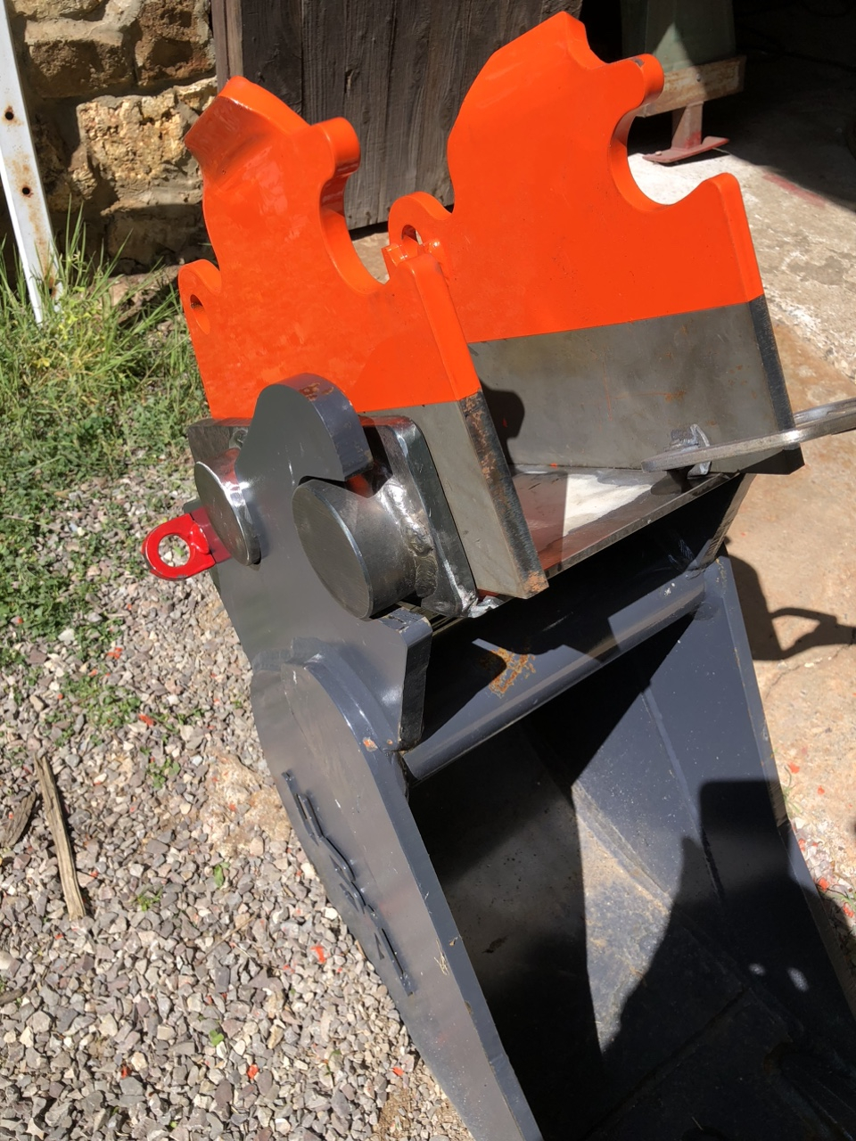

Now to locate, trim and mount the B26 ears. Probably clamp or tack to check operation with machine.

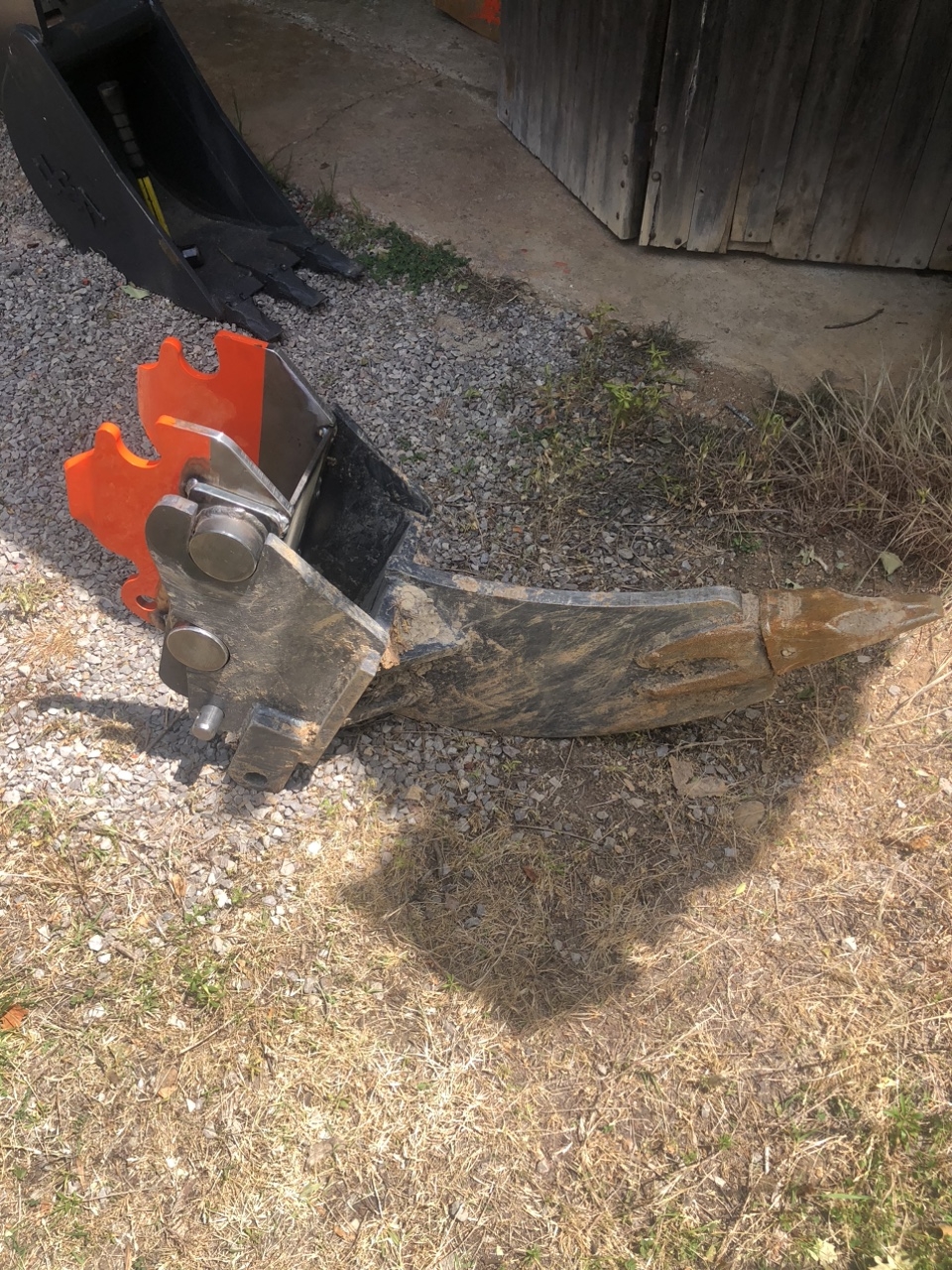

Building a dedicated ripper for the B26 VS this adapter not much added material. KX- ripper not too heavy but maybe too long? Leverage and possible boom strikes a concern.
The 3 OEM buckets I have for the B26 vary only by width. 12” KX- is taller compared to B26 12”. How useful shared attachments other than the ripper?? TBD. Innovative tooling has already improved our abilities to maintain the farm. Just like some SSQA attachments are too big for the B.
Making the KX- coupler portion was much harder than welding the ears. Challenged my limited skills. Heavy weldments with precision alignment with holes and pucks. I would try some fabrication steps differently if a next one. The ears on three different attachments from the same manufacturer vary slightly but all hook up easily.

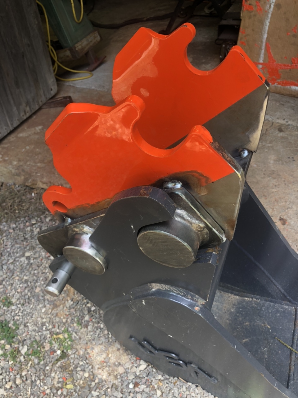

Trimmed the ears yesterday. Optimistically sitting them back closer to KX- ear’s attachment points. Tack and evaluate thumb function. Hope the attachment geometry works out.

Tacked the ears on for fitment test. Waiting on wife to finish mowing to mount backhoe.

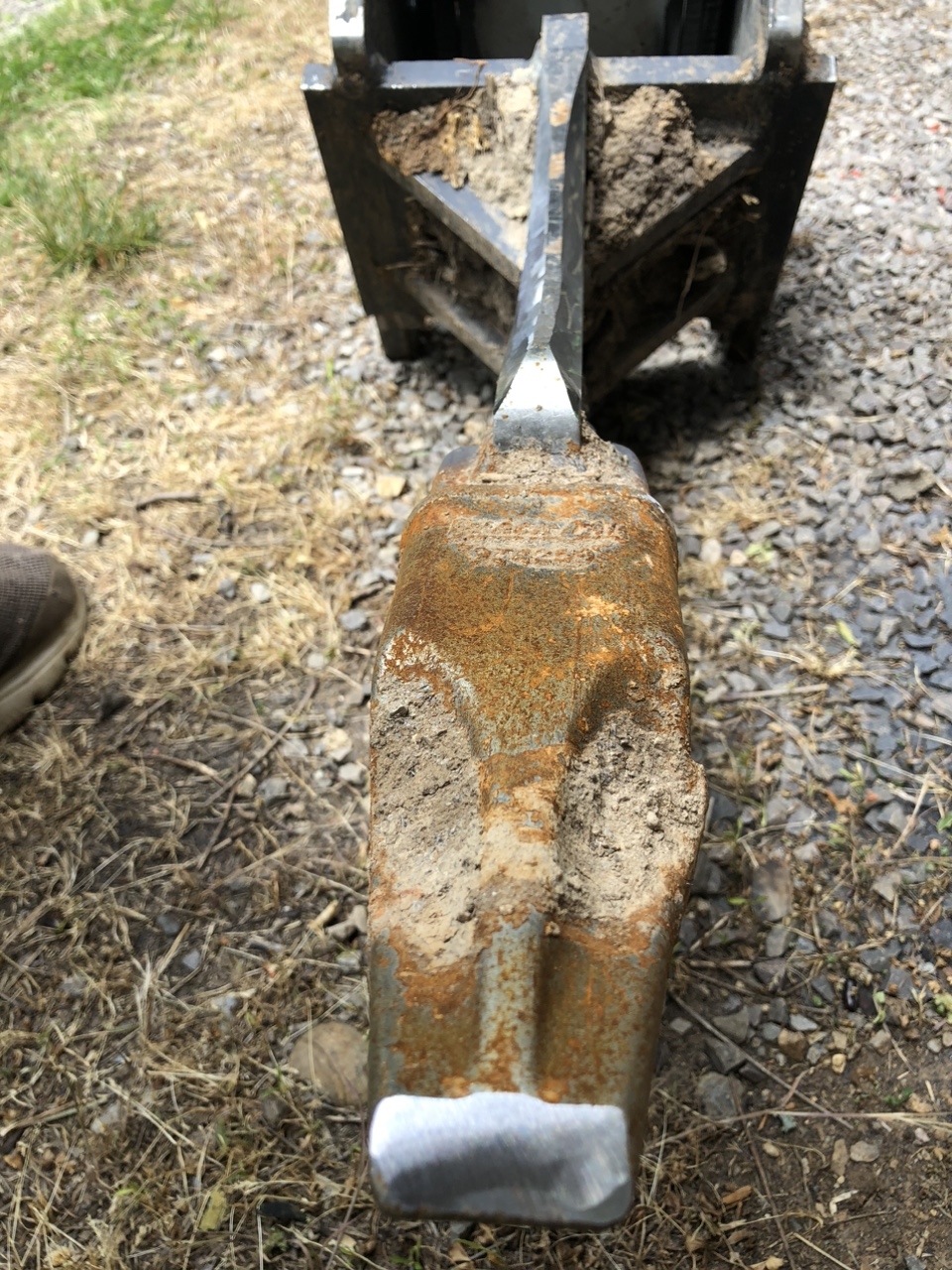

While waiting tried out a new grinding wheel recommended by another poster to sharpen the leading edge of the ripper.
Pferd 61201 5" CC-Grind-Solid 7/8" A.H. - SG for Steel https://a.co/d/fFEgIEN
Cuts quickly and requires little pressure. Reduced 1” AR400 edge to 1/4” in about 20 minutes. Old bones appreciated less strain

Kubota 12” excavator bucket compared to 12” B26 bucket.

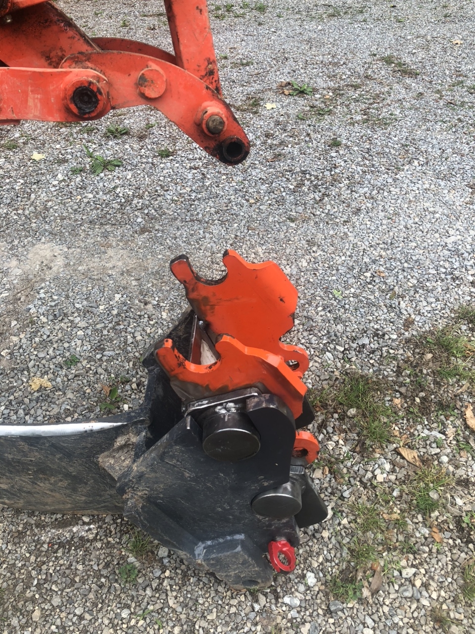

Tried test fit, no go. OEM ears interference with thumb. Need to trim front of ears to similar profile as bucket. Typical prototype progress.

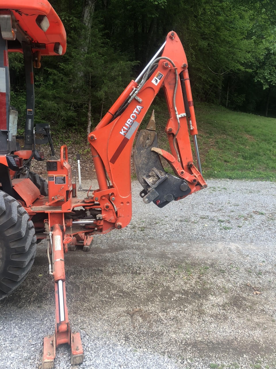

Got it on. Thumb has limited range from interference. It is a large ripper for this size of machine. Chewing on how better to move the ears for better geometry?
/ B26 backhoe attachment
Third time measuring, guessing, cutting and tack welding got a good fit. Full articulation of the thumb. Easier coupling and better fit overall. Craved a couple pounds off the steel plates.
Better thoughts that this might work. The ripper can hit boom if crowded all in. Working carefully shouldn’t be much of a problem. Sharpened the shank leading edge some more.
Next lay in a couple of good welds and test dig.

Now complete.
Adjusted one ear plate with 0.060” to 0.085” shims to allow hand insertion of pins. Several more tacking and installing checks. Trim sides and fabricate receiver hitch parts.
Welded. Pins fit but are tight. Fitment might loosen some with use. This is where I really appreciate fabrication manufacturers skill of making large weldments. Invest in jigs, weld procedures, go, no-go gauges to make repeatable parts.
Now to paint.

RScotty, The quick attach pins are fully supported and pass through the respective side plates. Sees no rotational force. OEM 1” on the B26 ears and 1.19” on the excavator ears. These see forces at the extreme range of motion with an extension, anti curling movement of the attachment. The pins are not cheap but expect wear or breakage to be rare. The 3” pucks and front pivot point see most of the load.

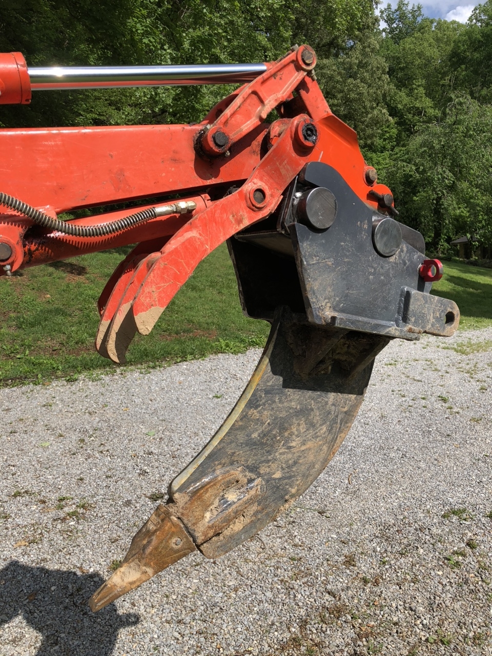

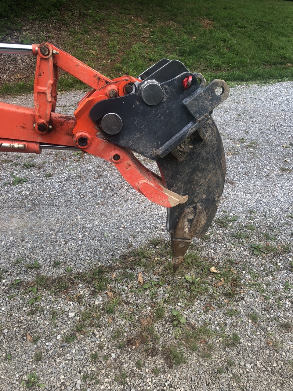

Ready to dig.
Whittling on this blow downed oak root ball.
Good power to break 2-3” roots. Bigger roots take time but tooth and shank do their job.
Ripper 150#, adapter 60#. B26 handles like a champ. Call this a successful venture.
