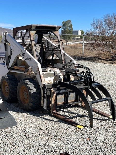

I had an extra set of 42" forks from the lift, replaced them with 48". So I bought this little rig from Titan minus the forks pretty cheap.
