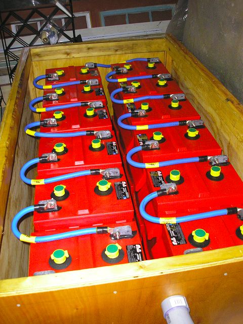

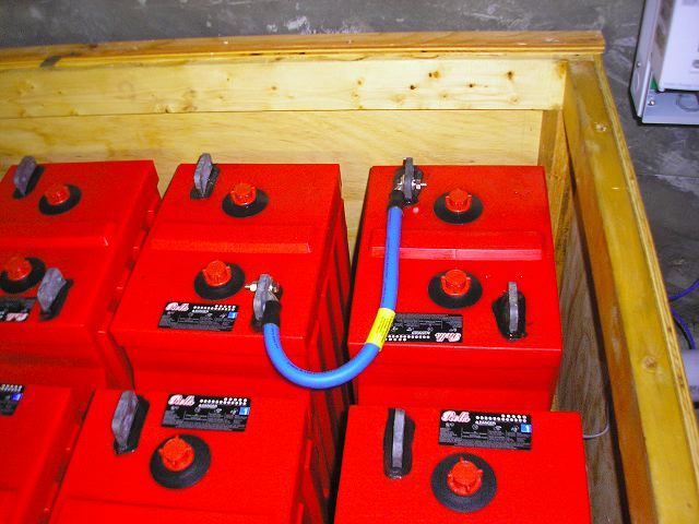

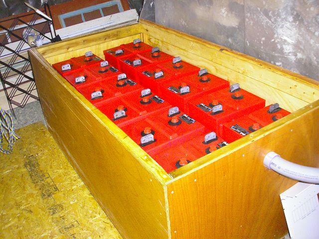

It's been raining like crazy here, but the other day it broke for long enough to get the remaining batteries around to the basement outside entrance. I ended up take three at a time which lightened the load enough to keep from sinking. It also enabled me to drive over a drier, but more sloped section of the yard without fear of tipping over. Finally, they are all in as you can see in the first picture.
The next shot shows the first interconnect cable. I was playing around with how to best route them to be neat, but keep clear of the fill caps. The routing you see is what I settled on.
Next shows them all interconnected. 12 batteries wired in series with 4V each gives the required 48v. You can also see that I've replaced the fill caps with hydrogen recovery vent caps. These help reduce water loss subsequent filling.
Other than running the main cables up to the wiring panel and breakers, then only thing left is to install the power vent. I'll be sure to do that before hooking up the panels or other charge device.

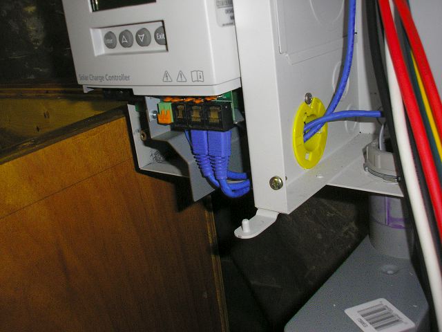

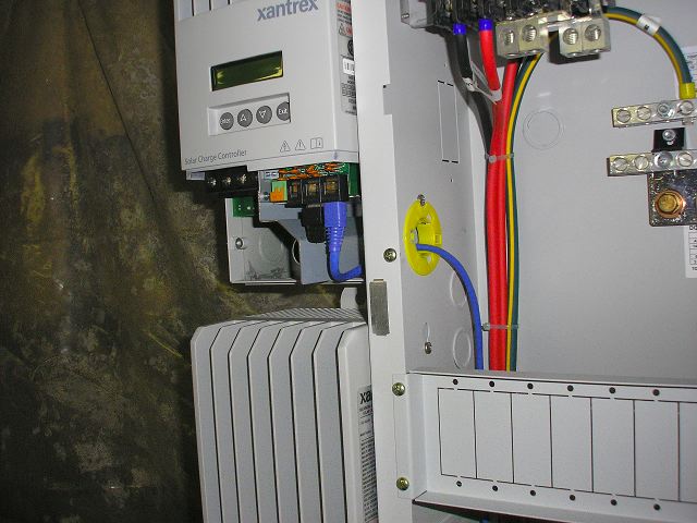

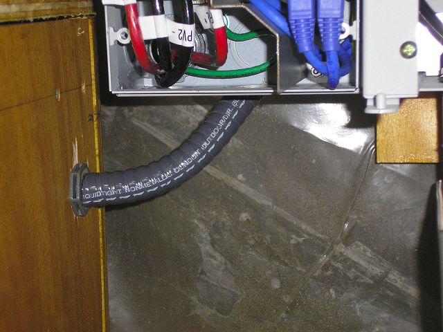

Now on to wiring the panel. The first thing they recommend is to run all the low voltage communications and battery temp sensor wires. There are shielded chases in the back of the wiring panels that aid in keeping the wires isolated from the AC and high voltage DC. However, to get up to the charge controllers they have to venture out into the wiring space. In these pictures you can see the blue wires running into the two charge controllers, then the same blue wires connecting into the inverter. They are standard Cat5 cables, though the electrical protocol isn't ethernet. The silver covers in the lower back of the wiring boxed are the chases.
I also realized that I should not have the battery sensor wire running in the main battery cable conduit, so I ran a second small flex conduit from the panel to the battery box. You can see it in the last picture.

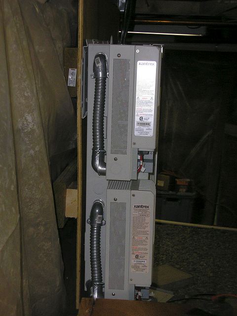

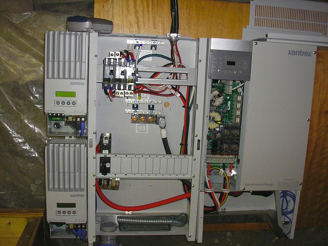

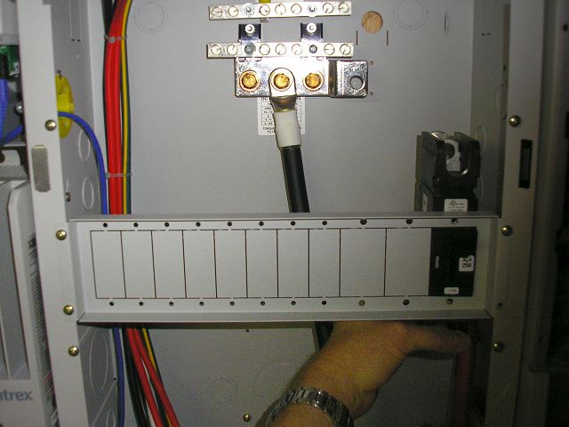

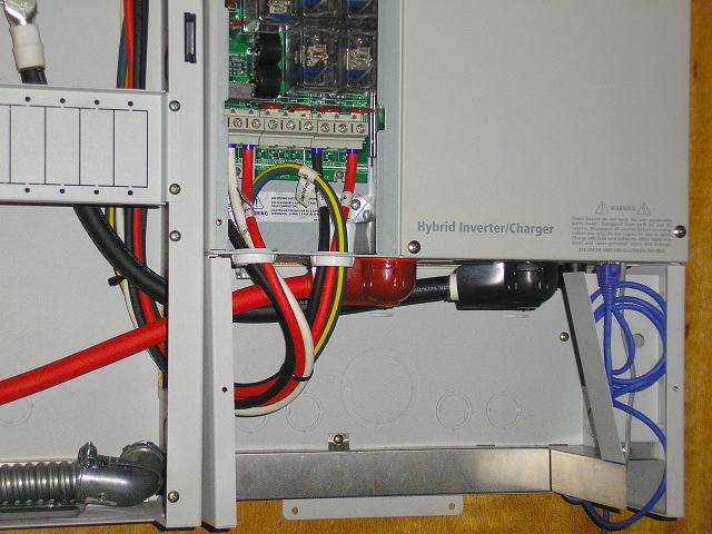

Next step was to hook up the AC. The panel comes with breakers for the generator, inverter, and bypass, and it's all prewired for connecting to the inverter so hookup is a breeze - sort of.
From the factory the panel is wired to have the inverter on the left and the charge controllers on the right. In my config I'm reversing it so I can get the panel closer to the batteries and keep the cable run to 5' rather than 10'.
The first thing I needed to do was move the 200A DC breaker for the inverter from the right to the left of the box. You can see it's original position in the first picture.
In the second picture you can see it's been moved to the left closer to the battery box and directly over the conduit entrance. Then I hooked up all the AC lines to the inverter. The idea was to keep all the AC lines grouped in the upper right and along the right side. You can see this in the picture.
The last picture shows the AC connections to the inverter. You can also see the inverter DC cables which also come pre-wired in the panel. Hook up was a bit touchy, again because everything is focused on being set up reverse to what I did.

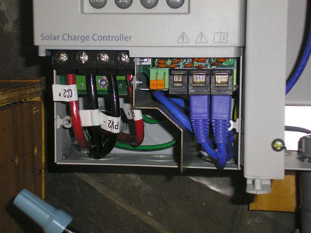

And now for the DC wiring.

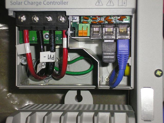

When I went to hook up the charge controllers, I had a bit of a surprise. Even though the controllers are designed to mount directly to the side of the wiring panel, and even though there are matching knockouts for running wires, you still need to fabricate and install external conduit between the panel and controllers :( . The wiring box of the controllers is split into two sections; the DC connections and the control/communications connections, and they are separated by a shield. The knockouts let you access only one of the two sections of the wiring box, and you have to run conduit for the other part. Given my left-side attachment, this meant my coms cables had a natural passage, but I needed to fabricate conduit for the DC cables. What a pain. This of course resulted in two trips to town for parts at about 3 hrs per trip :mad: .
Finally, the results are visible in the first picture. I pre-cut and labeled the wires and fished them all through before assembling the conduit ends. I don't know if you've ever tried to thread #6 THHN copper wire through 1" conduit with 90 deg elbows on each end, but it's not a happening thing. Now try 4 wires plus a #10 ground:eek: . Threading it ahead of time is the way to go.
The next pictures show each of the controllers all wired up. It's a pretty tight fit, but it works.
