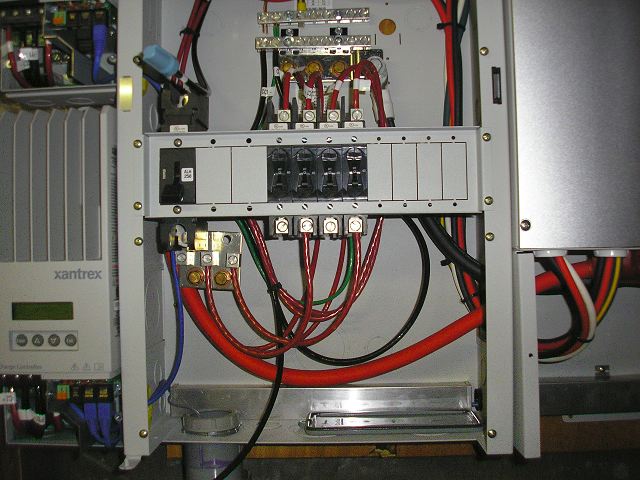

OK, getting towards the home stretch. Next is to terminate all those wires coming out of the charge controllers. There are 2 60A DC breakers for each controller, for a total of 4 breakers. One disconnects the solar array from the controller, and the other disconnects the controller from the battery.
The first picture shows the 4 breakers and all the wires hooked up.

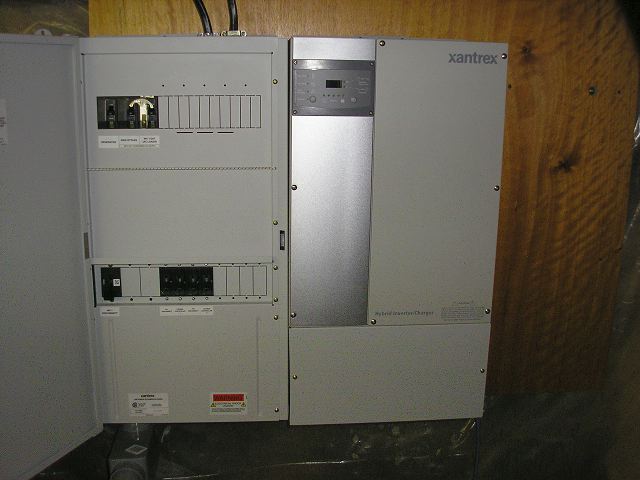

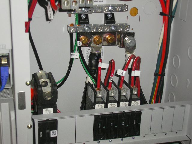

Then, the batteries. It too a lot of wiggling and pushing to the the cables through the conduit and into place (they are 4/0 THHN with end lugs). In the second picture you can see the negative cable bolted to the negative bus bar. It's the cable on the left. The one on the right goes to the inverter. The bus bar slightly above is the ground bar - not to be confused with the negative bar (visible) or the AC neutral bar (not visible). All are different and isolated in this wiring box. In the main breaker panel, and only in the main breaker panel, the ground and neutral are bonded together. This is all per NEC.
In the last picture you can see the Positive battery cable mounted to the bus plate. The other 4/0 cable in the forground is the inverter + cable.

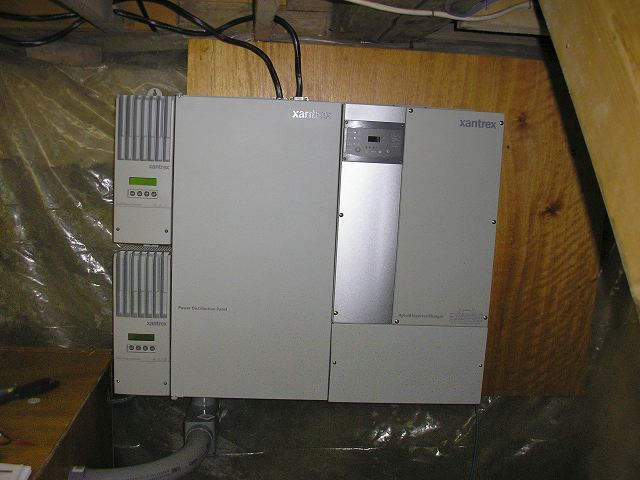

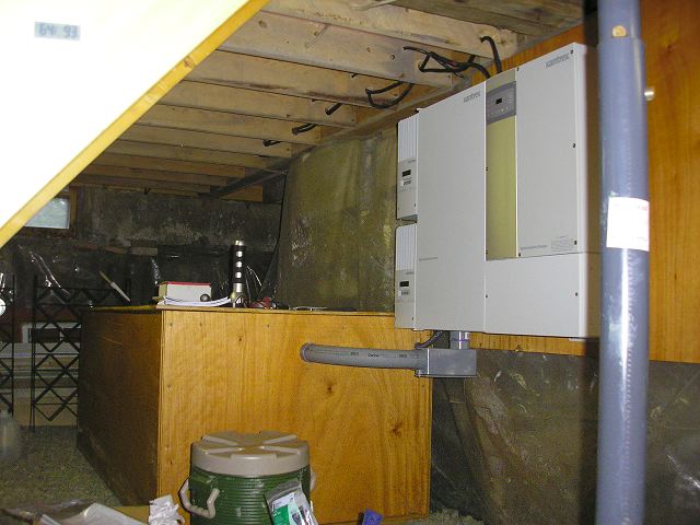

After checking voltages and checking for shorts, I ducked behind the battery box and touched the final battery cable to the battery. No sparks:D . Next, I flipped the main breaker for the inverter and presto - on it came. After taking it out of standby, I was able to measure 120V on both sides of the 240V circuit, and 240V across it. All good :) .
But, when I threw the breaker to apply the house load, the inverter buzzed and shut down.:( . A little probing revield the one leg of the AC was shorted somewhere. I was luck to find it quickly - on of the cable clamps had pinched too tight and gone through the insulation on the red wire. This is exactly why everything has a safety ground!!! After rerouting the cable, we were in business. With careful throwing of breakers, I can run the house off the old or new inverter.
These last pictures show things getting buttoned up. The next major step is to get the solar arrays assembled and attached, but I'll be taking a break from this for a couple of weeks. The array mounts are still a couple of weeks away from delivery anyway, so there is not much more to do in the mean time. Then I need to get the generator set up, but I'll be waiting on the shop for that. Hopefully, with 3200W of solar, I won't need the generator for a while.....
