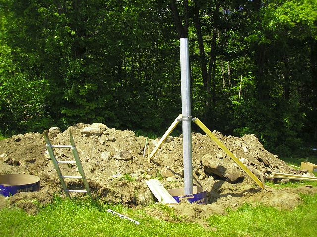

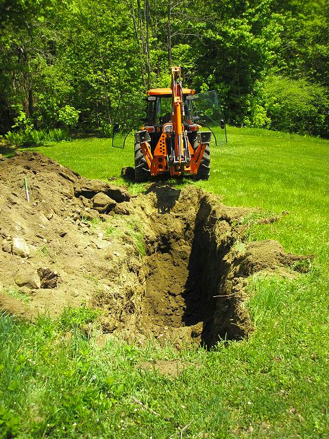

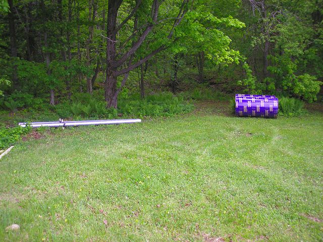

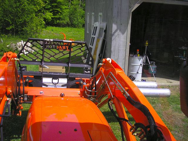

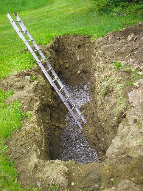

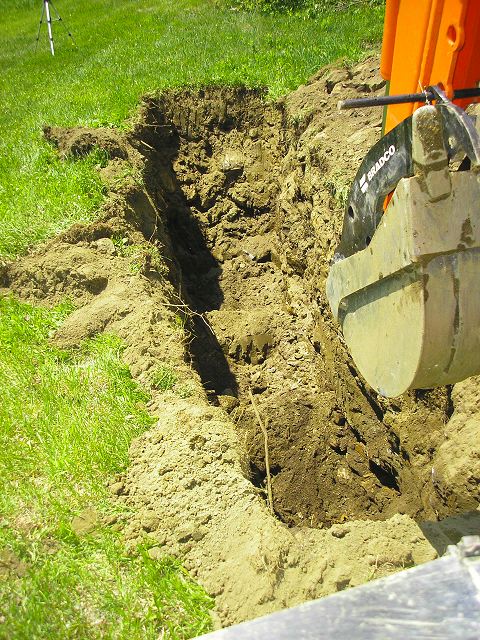

Since I have a concrete truck coming for my shop foundation, I decided to set the solar panel mounting poles and footings. The first pictures are of the trench I dug for the footings. These babies are 6' deep and will be formed with 36" diameter Sonotubes. There will be two poles spaced 10-11' apart. The poles are aligned E-W so the panels face due south without shading each other.

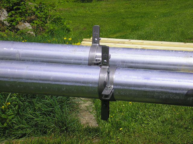

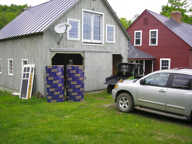

Here are the sonotubes and the poles being prepped. The tube was 12' long and I cut it in half for the two footings. These things are huge, and you can get a sense of it by the way they fill the garage door.
The poles are 16' long, 6' schedule 40 galvanized pipes. Holly molly steel has gotten expensive. The 21' pipes these were cut from cost almost $600 each! Yikes.
I put two riser clamps on each pipe offset by 90 deg. On each clamp I replaced one of the bolts with a much longer bolt that I could use to attach prop poles. I also shackled a lifting chain to the other side of one clamp.

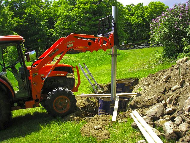

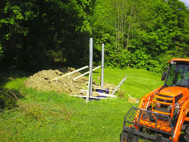

/ Solar Electric Project

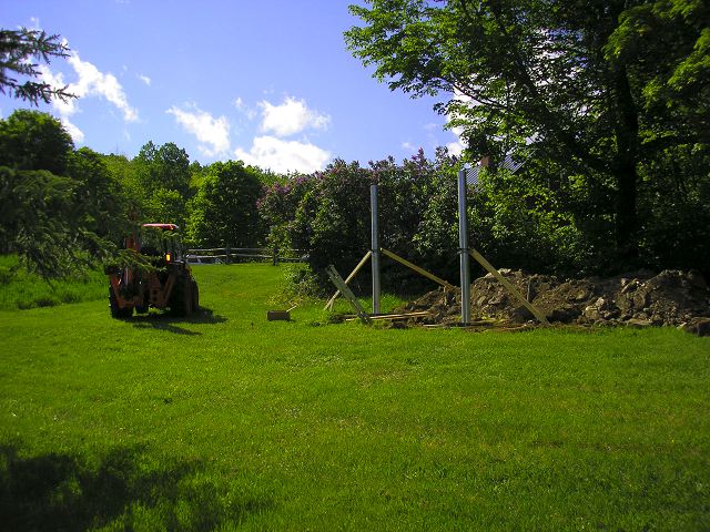

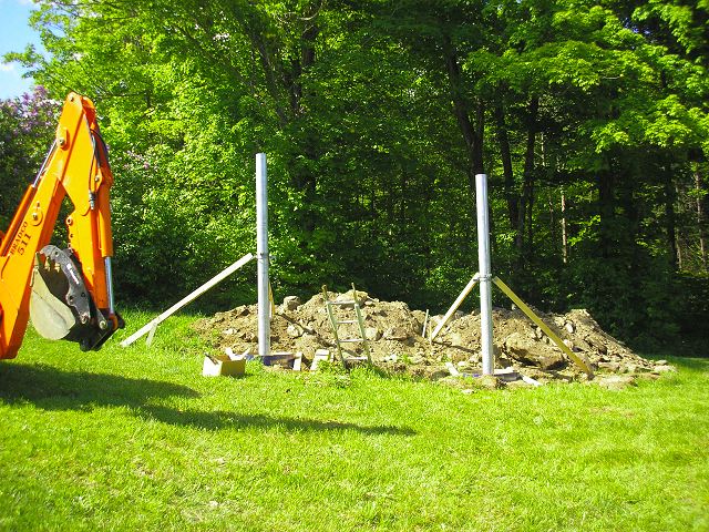

And here are the poles and sonotubes getting set in position. I put the tubes in the hole first, then worked the pole into the tube, It was a bit tricky doing it. My tractor was about 2' short of being able to lift the poles high enough to just drive them over the tubes and lower them down. As a result, I lifted them as far as I could with the forks, then hefted the end into the tube by hand. I used the forks because the frame has a nice D-ring that I was able to shackle my lifting chain to. The forks also provided side guards just in case the pole got a way somehow, though it would have been difficult because the chain was shacked at both ends.
Once the pole was down in the hole I could edge the tractor into position to set the pole. I pushed the pole to center the end in the hole, then my wife lowered the pole until the lifting chain went slack. Once the weight of the pole was on the ground, I bolted my braces to those long bolts on the clamps and worked the pole until it was plumb. After the pole was set and braced, I climbed into the hole and leveled the sonotube, then back filled around it with a few inches of crushed stone to keep it from walking around while it's being poured.

/ Solar Electric Project #4
Peter, nice project...I was just reading your updates on your other thread too.
I guess it's too late now, but I was going to recommend putting those poles farther apart. It's Summer now and the Sun is high, but as Winter comes around and the shadows get low, you might be surprise as to where the shadows are cast. And that's when you need them to work best since there's less daylight. I don't know if you've seen my thread about my solar project, so I went through all that already.
Will you have the ability to rotate or move the direction your panels are facing? Mine are dual axis but my neighbor sets his manually about 2 or 3 times a year to get the best angles.
I'm not planning to use trackers. Up here at the north pole (Vermont) they don't have the advantage that they do further south. If I was using trackers I'd likely have a problem with shading, but the panels will always be facing due south and the two arrays are in the same plane at all times. Right now I adjust the tilt manually twice a year.
I checked the site with a solar pathfinder to be sure my exposure was good, so I'm pretty sure I'm OK. The only issue might be that one pole stand a bit higher than the other so late in the day I might get some shading of the eastern array. However, I've got trees that will shade everything later in the day for much of the year. I'm planning to leave the poles at different heights for now. If it's a problem I can always cut the pole down to match the height of the lower pole.
My fingers are crossed...

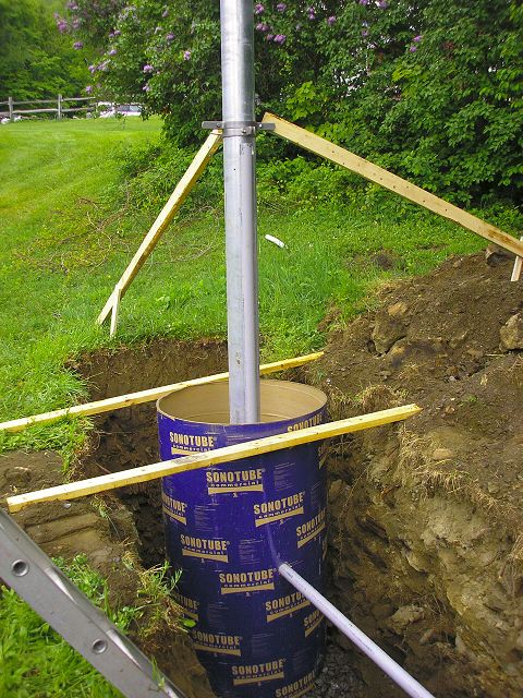

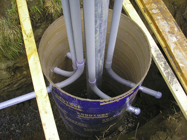

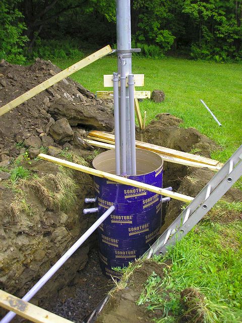

In between rain showers I managed to get all the electrical conduit in place where it will be embedded in the concrete footings. This approach will take some of the strength away from the concrete, but I think there will still be plenty to hold the main pole.
As you can see from the pictures, there are quite a few pipes. Some of it is for the solar arrays, and some is in anticipation of a hydro shed another 150' down the hill. I figured I'd use the conduit run from the panels to the house for both devices, even though I'm only putting in the solar now. I also have two conduits running in parallel. One for high voltage DC from the panels and ultimately the hydro generator. Code requires that these be in their own conduit and not be shared with other cables. The second parallel pipe is for low voltage control wires. Right now I don't need any for the panels, but some day I might put in a tracker or other monitoring device. I'm also considering relocating my TV dish to the side of the pole so I might need to run coax. Both the high and low voltage conduits then continue on to the eventual hydro shed. For now they will be capped off and burried.
There is also one pipe that runs between the solar mount poles to consolidate the power at one pole before running up to the house.
The pipes running to the house are capped off too for now. Later I'll trench and extend them into the house, but for now I wanted to jump on the poles (actually the concrete footings) while I have concrete tucks coming through.
Finally, I'm ready to pour and hope to tag onto a footing pour tomorrow.
