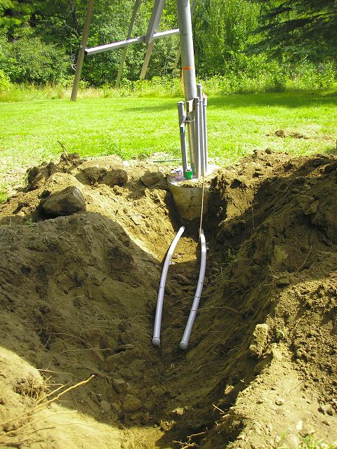

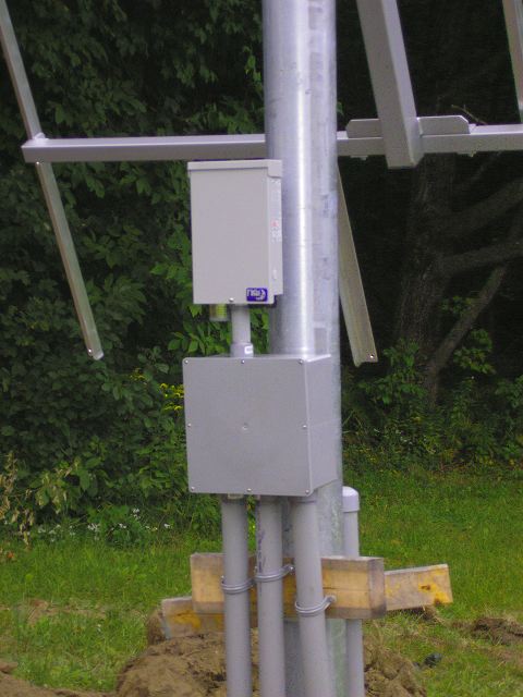

Since you guys have so many good ideas, any thoughts on how to best pull a additional wire through the conduit? I need to add an additional safety ground. I pulled a string through in anticipation of this, but managed to drop it down the conduit. I'm also worried about it being wrapped all around the existing wires and binding up when I pull the extra ground.
Maybe I can blow it out with a shop vac?

Just pull the string out, tie a baggy on the end and suck it back through with the shop vac. Be careful though the string can go screaming through there so either don't touch the string or wear gloves or both. Once you see how effective this is you won't touch a fishtape for conduit pulls again :D

Bad news...You'll probably have to play with the string as it'll be twisted around the existing wires. I'd try pulling a light rope through first.

seems like once you get the wires in they powers that be change their minds on me :D dang it anyhow.

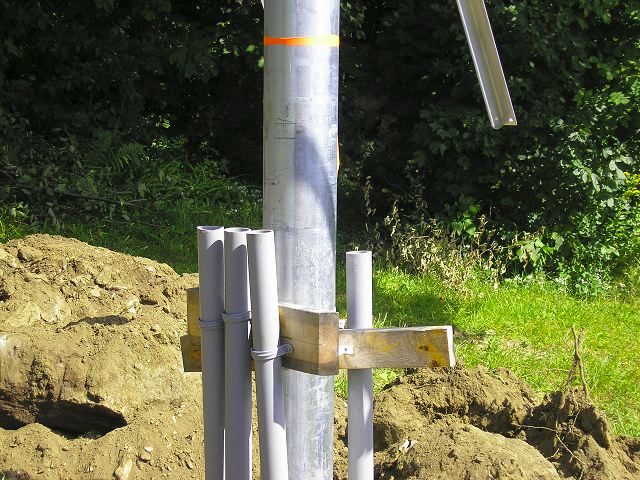

one question you have std 2x4 conduit support are you planning on replacing that one with something better i hope?

Are you refering to the 2x4's that are holding the conduit to the poles? Yes, those will go away and I'll secure the boxes to the poles some better way - haven't figured out exactly how yet - need to visit the supply store to see what's available.

Thanks for the suggestions. The string is still accessible at one end of the conduit so unless it's totally wrapped around the wires I should be able to get it out.
Now that I have something through the conduit repulling the wires wouldn't be the end of the world, mostly because I could pull them down hill.
I think I'll try to remove the old string first, then try to blow a new string/rope through to pull the new wire. If that doesn't work then I'll pull them out and do it again.
