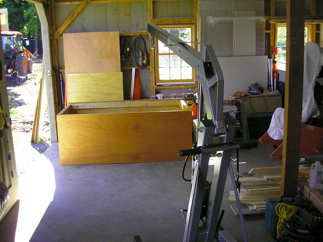

After a few weeks doing other things I'm finally getting back to this project. Part of the system revamp includes a new generator. My old one is 120V (no 240V), only 4000 watts, and has racked up about 2500 hrs. My new system is 240V and will load the generator to about 6000 watts just charging. To power loads at the same time requires even more. The inverter can pass a max of 60A, so that sets the upper limit of usable power. I figure something in the 10-12KW range is about right.
I'm currently running off propane, but decided to switch to diesel with the new system. Ultimately I'd like it to be biodiesel. I didn't stick with propane for two reasons.
First is overall efficiency, especially at partial load. For comparison, a diesel generator at 1/4 load is about 20% effecient and at full load it goes up to over 30%. A propane (or gas) engine is only about 13% efficient at 1/4 load and 23% at full load. The efficiency numbers are simply the BTU value of the electric output divided by the BTU value of the fuel consumed.
Second is that nobody seems to make an 1800 RPM propane generator that's less than 20KW. The smaller ones are all 3600 RPM which is a non-starter from a noise and longevity perspective.
I looked at Kohler and Cumins/Onan. I liked the Cumins product, but they apparently have no interest in doing business with me. I couldn't get call backs, and when I finally did the rep kept promising a quote an not delivering it. I heard every salesman line of BS in the book. I finally called the sales manager and asked if my needs were a match for them since nobody seems to want to sell me a generator. He appologized and 24hrs later I got a quote for $25,000 for a 10KW generator :eek:. I got the sales engineer on the phone and got the quote down to $10k by getting rid of all the stuff I didn't need or ask for. I followed up a week later with a couple of questions and again for no reply. After several unanswered phone calls and emails, I decided Cumins was not the company for me. With that kind of support/service when I'm trying to buy something, just imagin what it would be like when something doesn't work!
Then, I came across Kubota's line of commercial generators. They are very effecient and VERY quite. One call and I got my questions answered, another call and it was ordered, two days later it was at the local dealer ready for me to pick it up. That's how I like to do business.
I hate it when an American company drives customers to foreign alternatives. Oh well, I tried.
Anyway, here are some pictures of the generator being unloaded and then it's temporary home in the shop. I've got a temp hookup rigged to manually charge the batteries. I'm now switched over to the new inverter and batteries and with about 2hrs of gen time each evening things are working great. Tomorrow my son and I are going to start setting up the solar panels so I can stop running the generator every day.

Then, I came across Kubota's line of commercial generators. They are very efficient and VERY quite. One call and I got my questions answered, another call and it was ordered, two days later it was at the local dealer ready for me to pick it up. That's how I like to do business.
Sweet! Mind if I ask how big it is and what it cost?
/ Solar Electric Project
#87
The generator is an SQ1140 which is 14KW. It's on the big side of what I need, but is the smallest they make in the SQ series. The SQ stands for Super Quiet. It's completely stand-alone with a built in fuel tank, meters, etc, and the engine is the same as in the L3240 tractor.
I'll be doing a permanent installation with the exhaust and hot air piped/ducted outside. I also expect to connect it directly to my bulk diesel tank. If you look at KUBOTA GENERATORS you can see spec sheets etc. For some reason they list it as the SQ14, but it's same thing. I paid $12,500. A 10kw Cumins is about $10k and a 12kw is about $11k, so the pricing is right in range.
