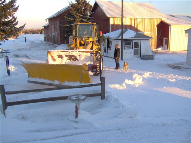

Then I gave up and got some real power.
Before I got the blower I rented a 624H for moving banks back and I have a friend that has a 644J that I use in his pit for loading gravel. Hands down John Deere has got to be the best operating quietest loaders I have been in. [the newer ones!] CJ

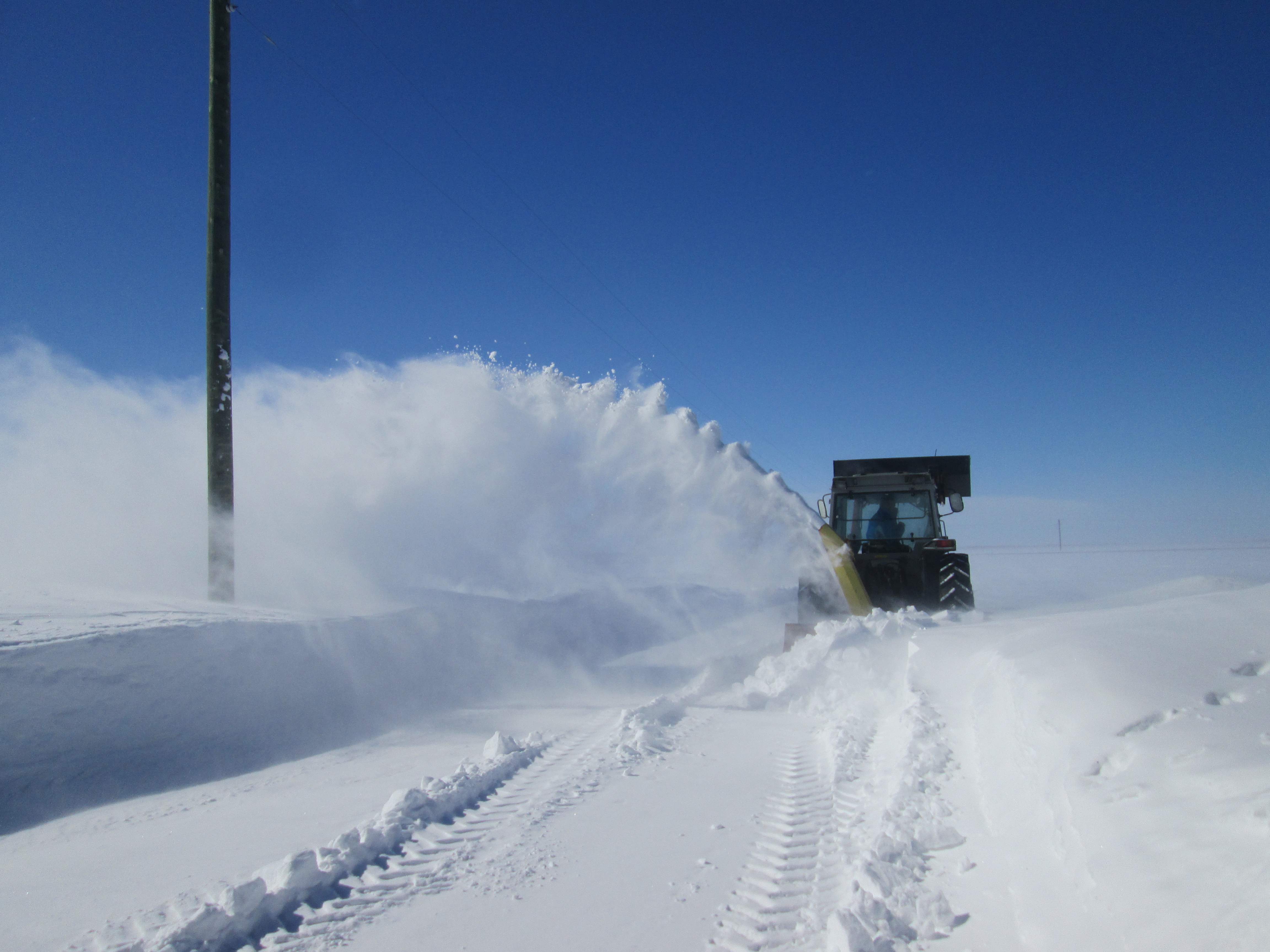

85hp on 84inch really wouldn't want any less

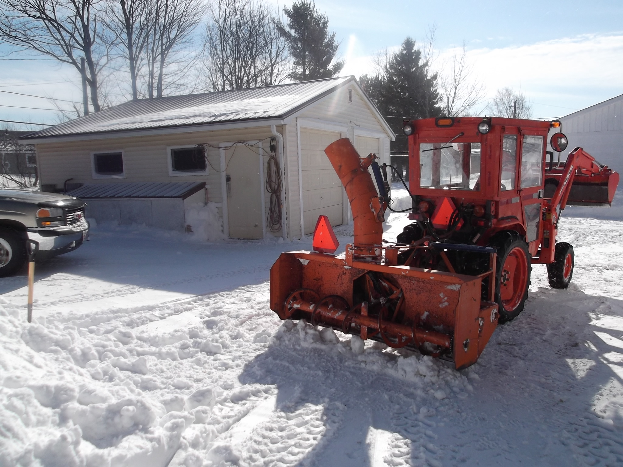

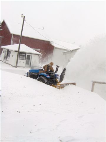

I am not saying they do not work. Just the snowblowers I have used always seemed underpowered. Maybe they are too much for garden tractors.
The old garden tractors worked well with 48" blowers . Here's my old 16hp simplicity hydro last year

Koja, the hydro and 16hp would help. My old Simplicitys are only 10hp and gear driven.

84" with pto 100hp. Used to have 115 pto hp but a fast reverse gear. Looking forward to some big snow this year. Mine is a double auger also. Someone mentioned they run a similar blower on 30 something hp. Wow I would have never thought that would do much.

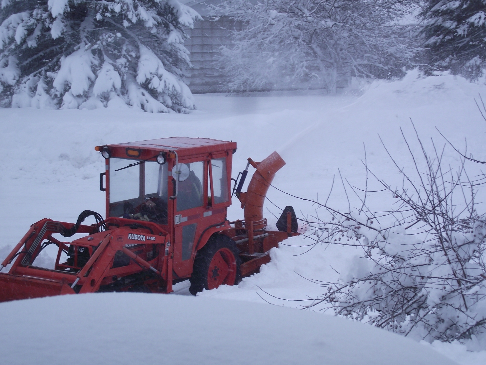

I am not sure if this is sized right as I just got it new this summer. The tractor is a Kubota B2920 HST (21 PTO HP) with a FEL and the blower is a Pronovost Puma 72.
The dealer sized it as said that the 2920 will handle it and told me to try it for the first couple storms. If I am not happy I can have the next size down (Puma-64) no questions asked.
I thought it was large for the tractor at the time and just put it on the other day and still think it is large but I have been surprised at how much heart this little unit has.

64" on a B3300. Can't have any less blower and still cover the tracks and certainly wouldn't want any wider or I'd be underpowered
