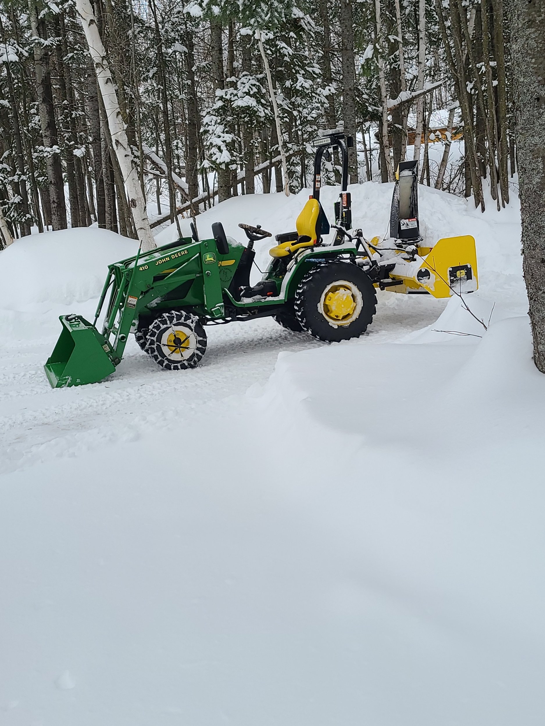

I would be forever grateful if someone can solve this problem I have.
I have an older Erskine Rear PTO snowblower. I refurbished and painted it to kinda match my 4115 John Deere.
Problem is I can snowblower all afternoon no problem. If I turn off the PTO for 2 - 3 minutes then back on , starts up great.when I stop the blower for 5 minutes or so while cleaning up with the bucket. When I turn the blower back on , SNAP , there goes another driveshaft shear cut bolt. The unit is garaged at 56 °f
So now , obviously, everything is locked up tight. I return to the garage and an hour or 2 later go examine it and find No rocks and now everything spins freely with no sounds of rubbing anywhere. There are drain holes behind the impeller.
I bought this from my brother who run it 3 years and never cut a shear pin ! What's happening ?

You need to check it right after the shear pin breaks (not after it has thawed out) to see what is blocking it. One theory is that maybe you aren't giving it a chance to clear out fully when you stop blowing and then it gets stuck on a chunk of ice.

Leave it parked outside. Its the warm garage melting some schmutz of the chute, falls into the cold impeller, maybe refreezes, and locks it up.

Another option is to raise the blower a bit and keep the PTO on while you're doing your bucket work.

Two possible issues:
1. Shear pins you are using may be the wrong grade (too weak). Check the manual to see what grade they shoukd be.
2. The slight moisture that builds up around the fan that shoots the snow up through the chute while it’s running (melting particles of snow due to friction ) can freeze up quickly when you stop for a minute while you’re snowblowing. That happens to the blower on my skidsteer (which is all hydraulic; no shear pins). I carry a small ten pound hammer in the cab and give the fan blades a few quick heavy whacks to break the ice bond. It works.
My guess your main issue is the quick freeze up described in #2 since it only happens when you engage the pto after having run it for awhile. Keep a hammer under your seat and give the fans blades some strong whacks; it won’t hurt them.

My thought is something is freezing once you stop long enough for it to freeze. If your stop is short enough it does not have a chance to refreeze. When you park it inside again it has a chance to thaw out again.

grade two bolts will work as shear pins. I agree with the ice problem, keep it spinning until you get back to the heat.

With the Ford, you can ramp it slowly up to speed. Does your Deere have an electric PTO clutch? Do you drop the RPMs down before engaging the PTO? Does the blower rotate easily by hand (tractor off) ?

I Always lower rpm to about 1500 and lower blower to the group. Once it starts working , I bring it up to 2500 rpm. Right now, thawed out, every in neutral spins very nice. No rubbing anywhere. And yes , electric pto. Thanks for your input

When you shut it down to use the bucket - water/slush refreezes - - somewhere. Don't shut it down. Does not hurt a thing to keep it running.
I use to have a 3-point blower. Any time I had to blow anything less than dry, fluffy snow - I could have the same experience. Just about anything would blow a shear pin on mine. Ice chunk, frozen slush, limb, stick, frozen pocket gopher - you get the idea.
Going to a higher grade shear pin IS NOT the answer.

Hi, using grade 3 bolts, no oval to bolt holes, gotta tap em in gently with a hammer. I never turn on in raised position and always drop rpm to almost idle
