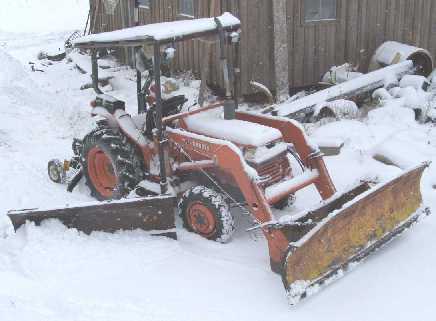

This winter has dropped around 50+ inches of snow.
The plow repair has held up without any further mishaps. As the driveway has been frozen, the plow works as designed, I have adjusted my speed to minimize any further problems. When the edge catches, I stop and curl the plow "up" to continue moving snow instead of gravel.
I see that you run chains on the front tires. The 7' plow will push the front tires around when it fills with snow.
Some of the problems with this set-up is the distance that the plow extends from the loader Q/A point. It causes negative leverage that moves the front end around. But it is not enough to cause me to find another way. I just adjust to the conditions found.
While pushing back the snow banks, I had the tractor front go over the edge due to the 2" under ice layer on the drive, 2nd time this year at the same spot, think I would have learned from the first time. I was able to chain and pull it back with my truck. I have put off buying chains for the L-39, but 2x proves it's time for the purchase. Its a bad feeling sliding over the bank when it happens. No damage to the tractor, but gravity can't be outsmarted. In the 5 years I've lived here, this is the worst icing that I've encountered.
Numerous winter rains & melting snow seem to instantly ice the gravel driveway. That comes with a 400'+ driveway in New England. It is now raining, with 2" predicted. I have been using the boxblade with the scarafiers down on my BX 2200 to break up the ice. I have rear V-bar chains that work well on the BX 2200.
I don't know the make of the plow, beyond "dump" brand. It's heavy enough to make me struggle when removing it from the plow frame.
WALT

Have you considered adding casters?
I built one of these and added the casters to keep
the blade above the gravel. It has worked great.

Walt you could save some $$ and get front chains only, old truck chains might fit just fine. That might help with the sliding around too.
Jim
