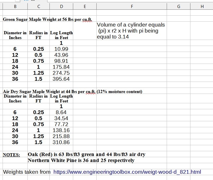

For anyone interested just out of curiosity about how much a given log weighs I would refer you to this website - Wood Species - Moisture Content and Weight Several years ago I put a spreadsheet together when I was curios as to why I couldn't manhandle 16 inch long piece of an old sugar maple I had cut down. It was about 50"'s in diameter. Once I saw the results I got out my sledge hammer and wedges so I could make the pieces small enough to get them to my vertical splitter. Nothing like good old exercise and fresh air on the side of a Vermont mountain in the frosty days of November. That wood kept me warm more than once. 😊I have attached a couple of screen shots of my spread sheet. Any questions feel free to message me however. Oh, by the way I now have a winch on the back of my tractor and have pulled out a good many logs. Bought it 2nd hand since I have been retired for over 17 years. Now wood I used to manhandle when I was young I now have to try to work smart even if this old brain doesn't want to.

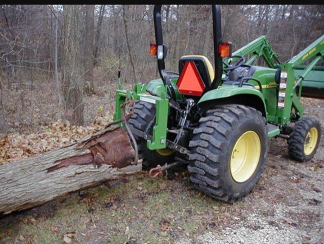

We had several oak trees blow over this year and block trails so now I need to move them out. I was thinking of building something but then I saw this picture using a quick hitch and tongs. I have tongs so I could do this for free. any reason why I should build/buy something rather than just do this?
This setup works like a dream and is about as low cost as one can get without fabricating something.
For extra long hauls, throw a log chain around the log using the tongs to lift the log to get the chain underneath.

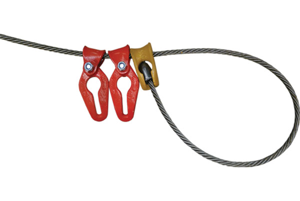

Can someone explain to me how you use this style choker, I understand about the chain hook wrapping around log but fail to see how you attach choker to tractor to pull....
Weld grab hooks onto your quick hitch to secure and pull on the chain.
BECAUSE YOU OBVIOUSLY DONT KNOW WHAT YOU ARE DOING, HIRE IT DONE...BETTER THAT THAN TEARING UP YOUR TRACTOR...CHEAPER IN THE LONG RUN...
Yup. With that setup I would just want to minimize the log hitting the back of the machine. The log only needs the front to be barely lifted off the ground and not as high as that picture. Use a longer chain to distance the log away from the machine. Then maybe throw a tow bar on the quick hitch to protect the tractor and call it good.
