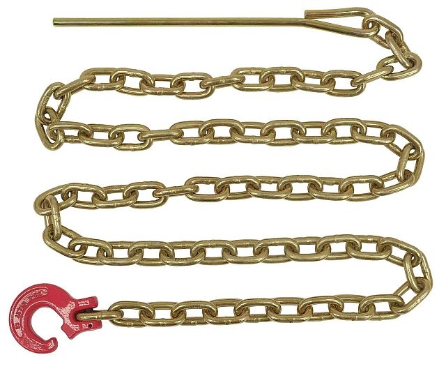

Can someone explain to me how you use this style choker, I understand about the chain hook wrapping around log but fail to see how you attach choker to tractor to pull....
You mount a grab hook on your tractor, or plate with slots cut into it that the chain will drop in to
It's actually designed to be used with a logging winch. You would put the choker on the log then grab the chain with the hook on the end of the winch line or one of the sliders on the winch cable. If you are interested you can see it in use this video I made a while back. The description of the set up for log winching starts at about the 3:00 minute mark, with a bit of detail of the choker on a log starting at about 3:40 and a better shot of the keyhole slider on the cable for grabbing an additional choker starting at about 6:00. (No fancy videography or editing here, and I'm not looking for subscriptions to my YouTube channel. This was just made for a friend who was curious about a Crop Tree Release project I was working on in my woods.)
/ skidding logs #43
Yes, normally used with a skidding winch, but you can get creative with them. The long "stick" on the end allows you to thread it under the log easily and then you hook the chain back through the slide hook and the tail hangs out with some chain and the stick that you can either hook onto a skidding winch cable hook or grab with a grab hook on another chain or cable. Just make sure you orient the slide hook so the chain doesn't want to fall out when you pull it. A lot of times the hook has a crook bent in it so it wants to poke back up after threading under the log and not dig into the ground too much. Trying to get a plain old chain under a log that doesn't have a gap below it is very difficult...
