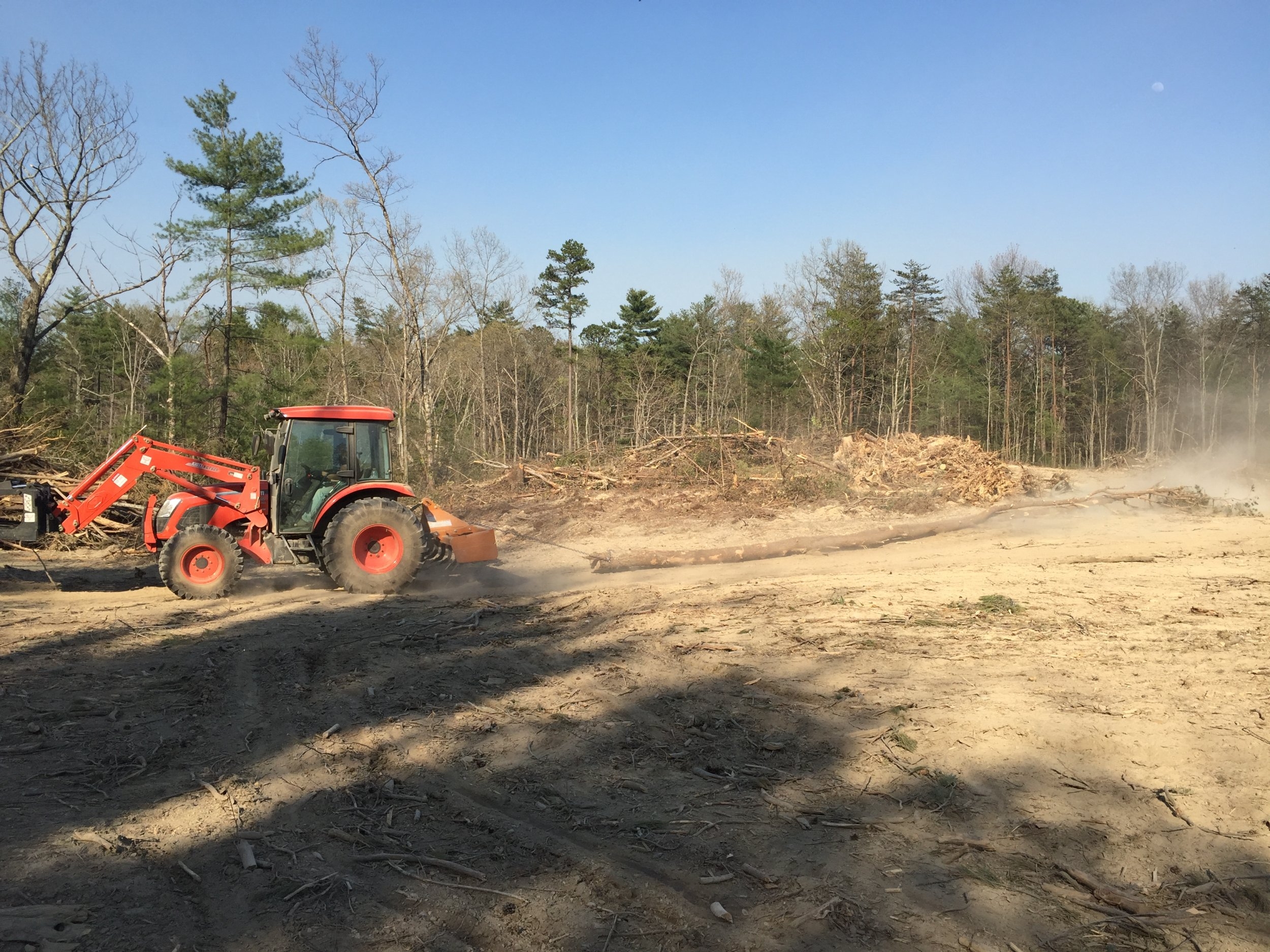

I wrap a log chain around the frame of a 3 pt hay spear and have pulled a 32" x 23' green red oak log up a grade with an RK55. I needed to fill the bucket to keep the front end down. Most of what I pull is smaller and longer and down hill. I've never had a log push me. It surprises me how much a tractor will drag. If your 3 pt will lift it, the tractor should pull it.

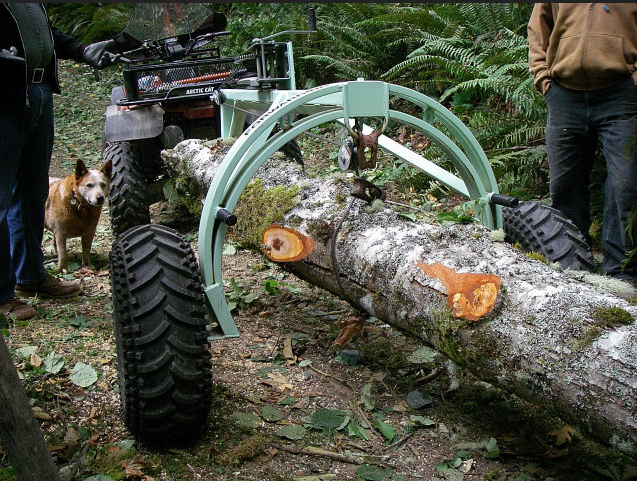

I think that for those who are not willing or want to drop coin on fancy smancy forestry winch setup. A 3 point logging tong setup is cheap and easy, together with a possible solution like this with a heavy set of wheels and an arch like construction was on my mind. But my fabrication skills are not up to this level quite yet.
/ skidding logs #89
Might be time to push the envelope, fabrication wise....
/ skidding logs #90
You can't just use hvy duty chain with a hook on the end? It'd be a bit of work tunneling it under the end you're lifting but I would think it would offer similar lifting/dragging dynamics to tongs.
Right.The chain is slid under the log, brought up around it and hooked to itself - forming a noose. "Tunneling" under the log, when it's flat on the ground is often accomplished by sliding a branch where you'd like to put the chain. The sma diameter of the flexible (green) branch makes it rather easy to bore a 'tunnel' large enough to slip my chain through - only need about a 1" diameter hole. Then use the branch/stick to push teh hook and chain through. Remember, a 24" diameter log is only tangent to the ground for a short distance (technically one point) so it ain't like boring for a highway or RR!
/ skidding logs #92
Man! I would love one of those right now. I've got a dozen hemlock sections that I could like to move about a mile down the way to a neighbor with a band saw mill just to get a stock of 1 inch boards out of. Not worth the price of a log truck, And too far to carry cross wise on the bucket .
That and a half dozen of them need to go across the grass yard. Not looking good to the wife on that front ;-)

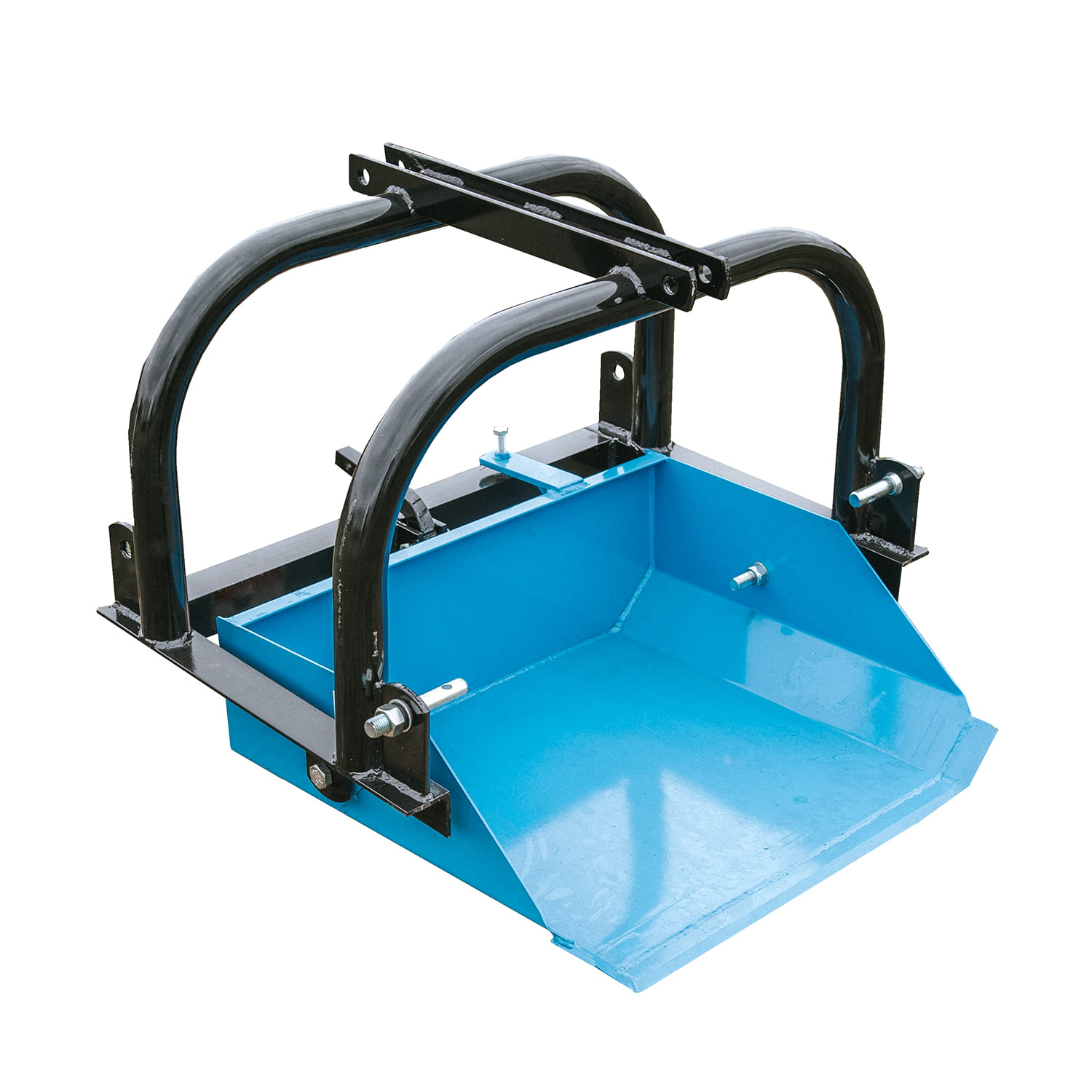

I once used a middle buster, mounted backwards with the blade removed to bring out an 8 cord load of tree length fir, using 3 chokers hooked into grab hooks mounted on the implememt. It worked very well,except that I had to back up to each tree.
I've removed the bucket from the scrape bucket from time to time and used the arches to lift the log butts using chains.
/ skidding logs #100
Anything to get the end of the log up is helpful. My winch works best for me, yet a lot of people including the OP can't justify that expense.
