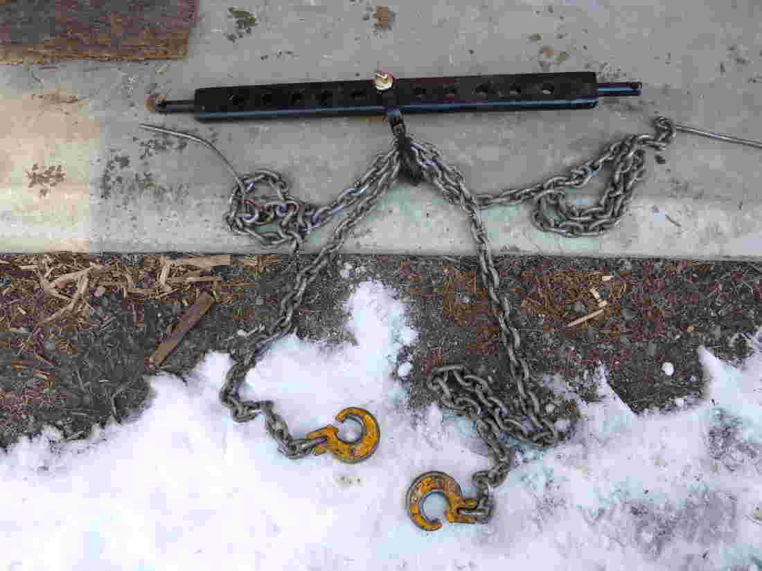

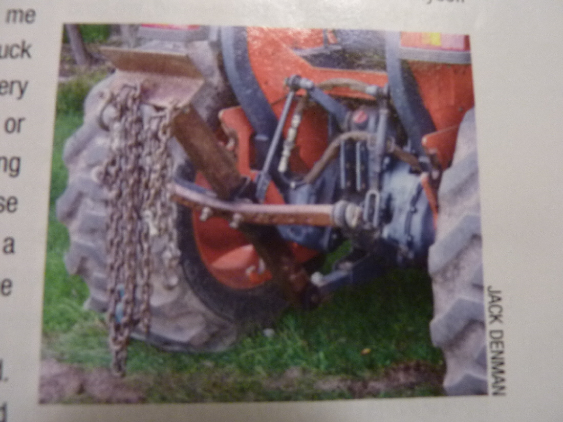

Agreed but they are my most favorite kind of pictures and I can look at skidding and firewood making pictures all day long. I especially like yours Ken. This is the method I've used for almost 30 years and it has proven to be a safe, effective use for tractor stem skidding.
