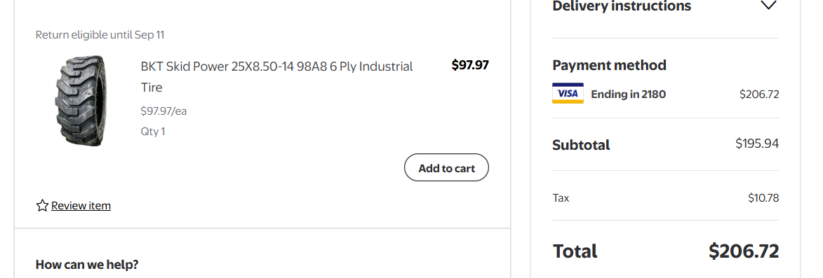

I just ordered a pair of these for my 4310. The total is for a pair with free shipping with Walmart+.
They seem like a pretty good match for the Carlisle tires that were on it.
The old ones were a bear to dismount. Mounting the new ones was worse. After I did one I called Discount Tire. They mounted the second one for $10 including a new valve stem. I wish I let them do the whole job.
i looked at those, but they are 6 ply, i want 10, so the loadmaxx for $115 ish seemed like a good option. i too was looking at walmart as i also get free shipping. i think priority tire also had free shipping. i was just going to cut the old ones off, one is garbage any way, but i didn't know if i would be able to get them on. my dad thinks we can (he did his, but were a little bigger diameter which seems like might be easier). my local repair shop guy, who would probably charge about $10 each, doesn't know if his machine can do it - depends on how rigid they are. the local tire shops wants $25 each to do it.
