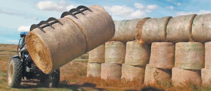

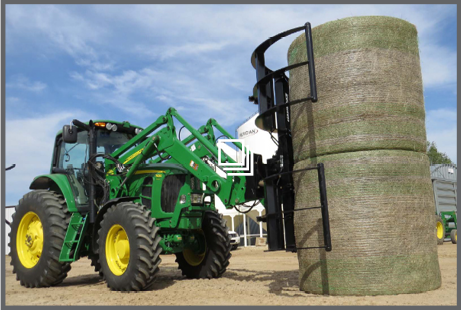

We are still old school, 4x5 and 5 x 6. 4x5 average is 900 each and a 4x6 average is 1450. Need a pretty big loader to lift 2 at a time. We use a rotating bale clamp and Ive never seen one that can do 2 at a time.
/ Skid steer vs loader tractor vs telehandler #45
3x3x8 bales 750 to 800 each
/ Skid steer vs loader tractor vs telehandler #46
An Image Search found one: Grapple And: Grapple allows formushroom stacking | The Western Producer

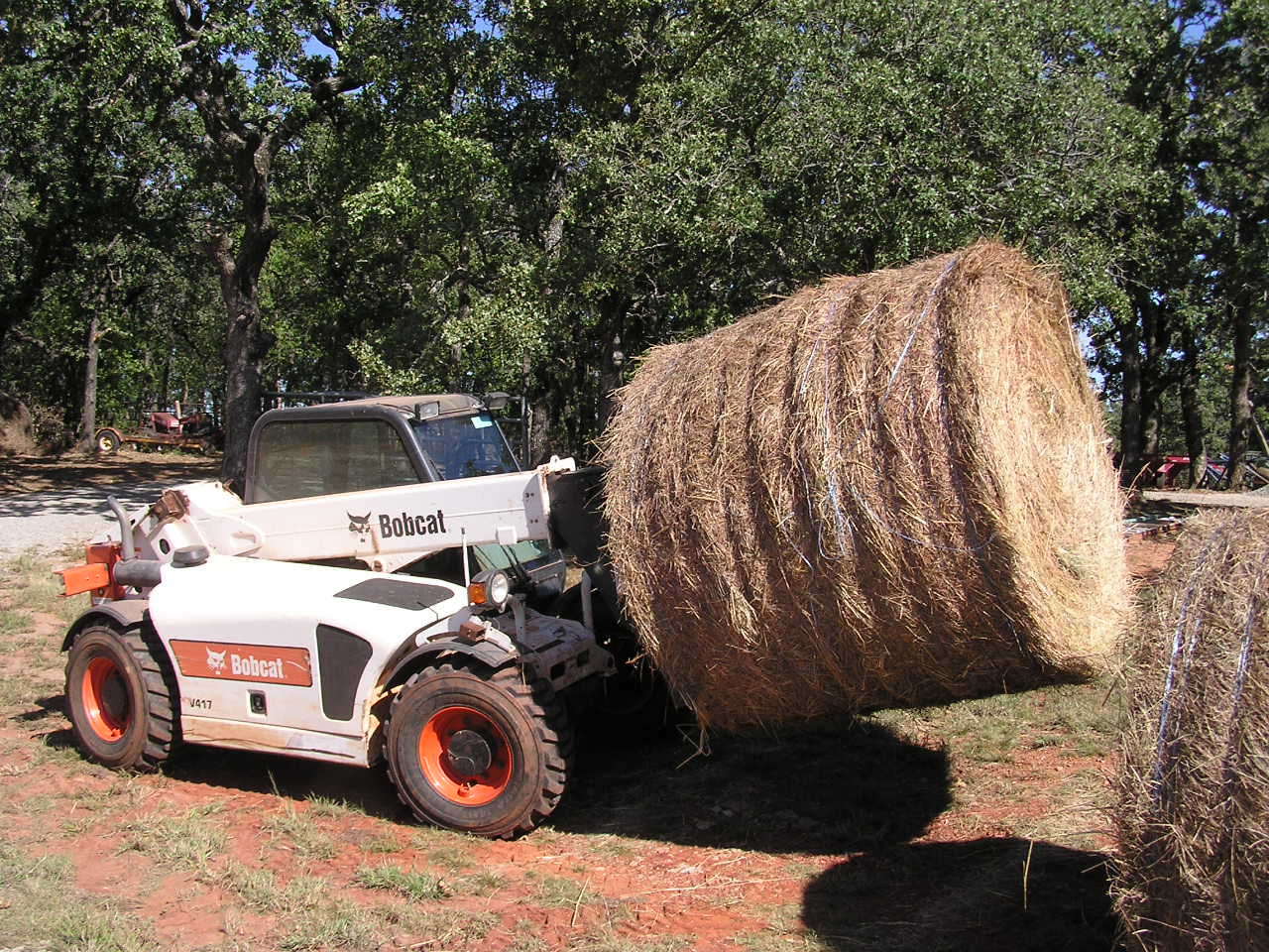

Evidently you haven't seen what my compact telehandler can do, or you would have one :D.
The old JCB Loadall will do it but it is big and heavy. Most compact telehandlers come with aux hydraulics on the boom and SSQA or can be fitted with an adapter to SSQA.
At 6.5' to the top of the cab mine is very stable on side hills. 4 wheel steering and crab steering are awesome and very handy.

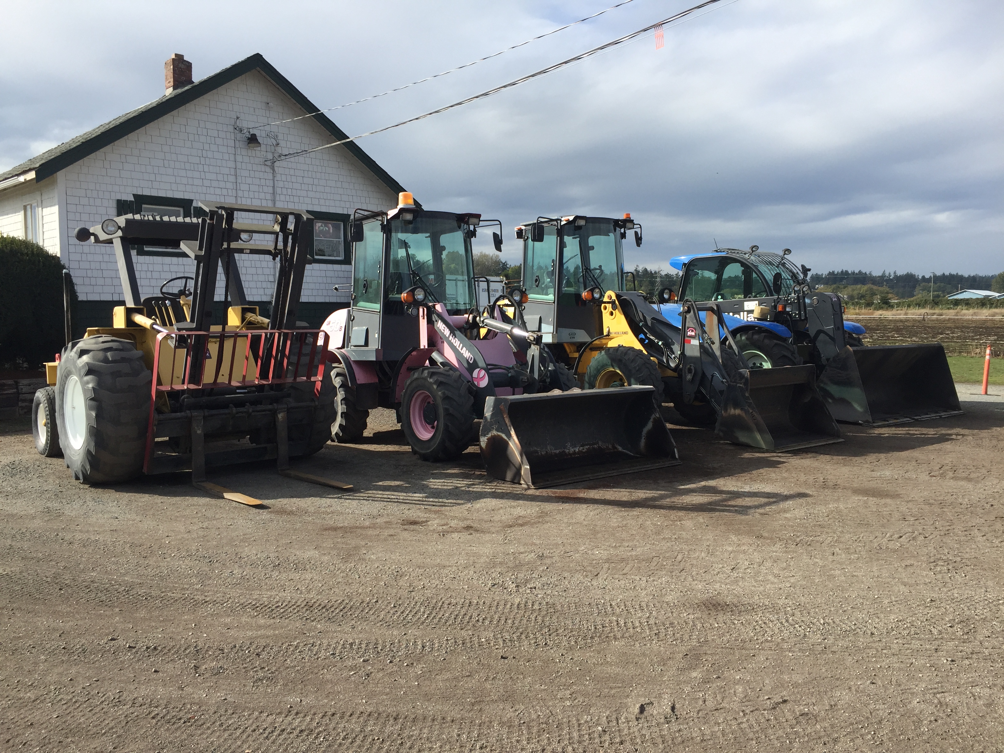

/ Skid steer vs loader tractor vs telehandler #58
Nice forklift! Got any more info on it?
It’s a rough terrain forklift made by Mastercraft Corp out of Georgia
Custom Built Rough Terrain Forklifts - Tifton, Georgia - Master Craft Industrial Equipment
I bought mine new in 1991. It was the first one ever shipped into Canada. Mine is based on a Ford backhoe frame, power and running gear. I ordered it deliberately with the low 10 foot mast as it was only going to be used for loading trailers. I didn’t want the extra mast weight in the field.
We still use it every day.
I demoed one on my mountain property. Very stable. Much more so than a SS or Tractor or CTL. You can still roll a CTL end over end, and that cant happen with a Telehandler if you use the boom properly.
OP I hope you have tons of room to maneuver the JCB. For me even the Bobcat Telehandlers were really large machines to zip around in. I cant imagine a JCB Loadall!
