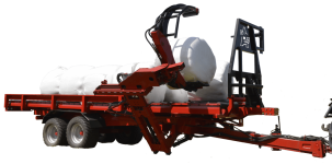

contest? A tractor loader can move 2 bales, one front, one (or more, size dependent) on rear. Of course, you could use just a trailer.
The moving of bales is only to take them from a stack to feed out so trailer like that wouldn’t really be suitable

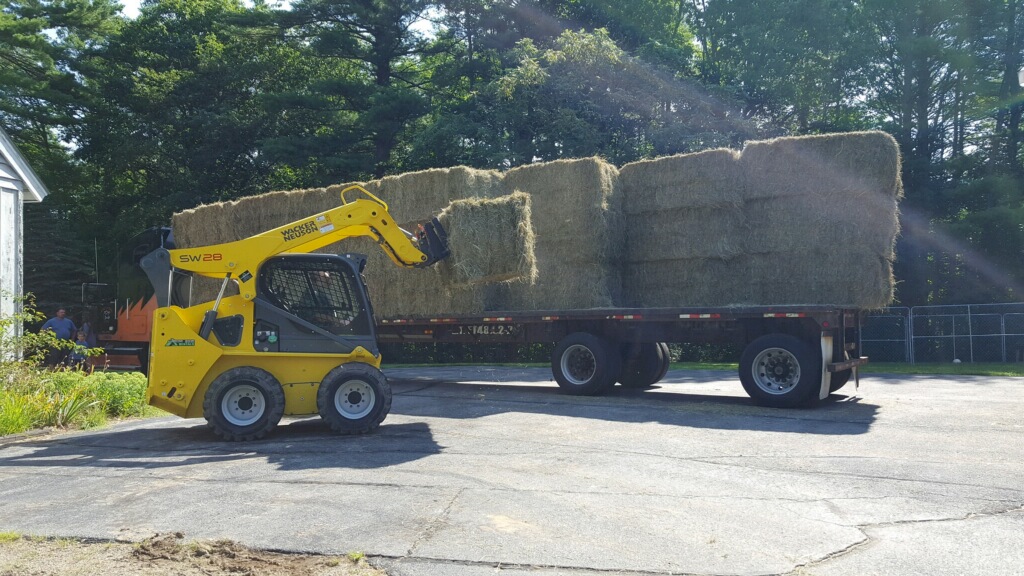

If you feel so inclined to move bales 2 at a time build a double fork for the CTL. The rear of the tractor can’t put bales in a bale ring, load/unload wagons or stack them in a barn so you’re pretty limited with that option.
/ Skid steer vs loader tractor vs telehandler #32
If you feel so inclined to move bales 2 at a time build a double fork for the CTL. The rear of the tractor can稚 put bales in a bale ring, load/unload wagons or stack them in a barn so you?*e pretty limited with that option.
