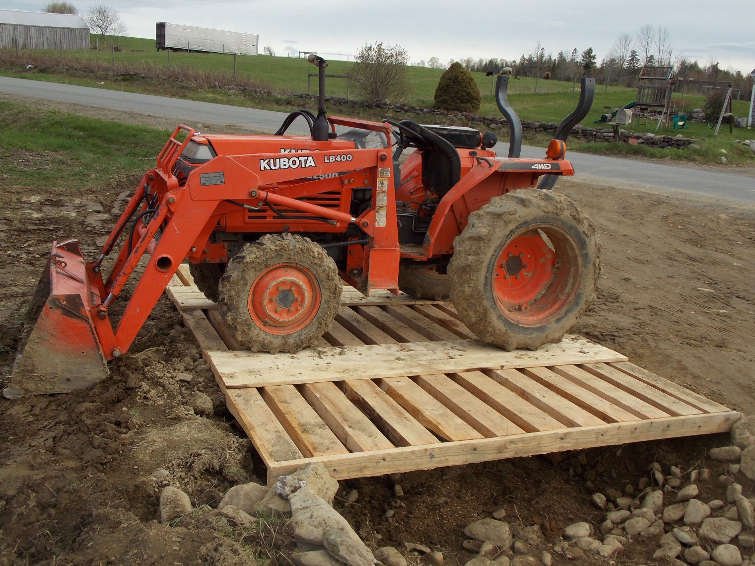

I have been redoing an old house that I have, and redid the driveway with gravel and such. It was no big deal, but I wanted a way to get across the new ditch. I thought about a culvert, but they are ugly, and cost money, so I decided to go with a bridge instead.
I admit that it took me 8 hours to build, but in the end it holds up my tractor/truck just fine, and only cost $16.50 for the long spikes I had to buy. Gathering up the logs did not take too long, but sawing the logs into lumber kind of did, taking the most time. But by noon I was starting to build the bridge.
It is 8 feet long, and 12 feet wide, the bridge resting on cedar supports, with the main beams being 5"x10". These I spaced at 5'-6" wide because my tractor has a 5 foot wide wheel base, and my truck has a 6 foot wheel base, so I split the difference. Over that I put down 3"x6" Hemlock planting, with a 2x4 hemlock spanning the outside edges to keep them from flexing. Over that I put 1 inch spruce boards so I know where to drive and have the main beams under me.
Overall, it was a rewarding project that turned out nice (I think anyway). I have used it now almost daily for a few months and have had no issues with it.
So if anyone has a stream or ditch they need to cross, his might be a cheap and easy way to do it.

Cedar base will last (relatively speaking) with moderate weights...... excellent performance, esp. given how little $ you have in it.
Counting your time, of course it's worth more, but most of us don't pay ourselves on projects like this :).
Things I don't like about small dia. culverts:
1) Debris, dead critters etc..... often easily accumulates, sometimes not easy to clear out.....
2) Early Spring Melt - often the culvert is frozen solid, to the top.
Your bridge BT, much like what would have been farm-built years-past, does the job for low dollars, and mostly bypasses the problems I just listed.....
:thumbsup: Rgds, D.

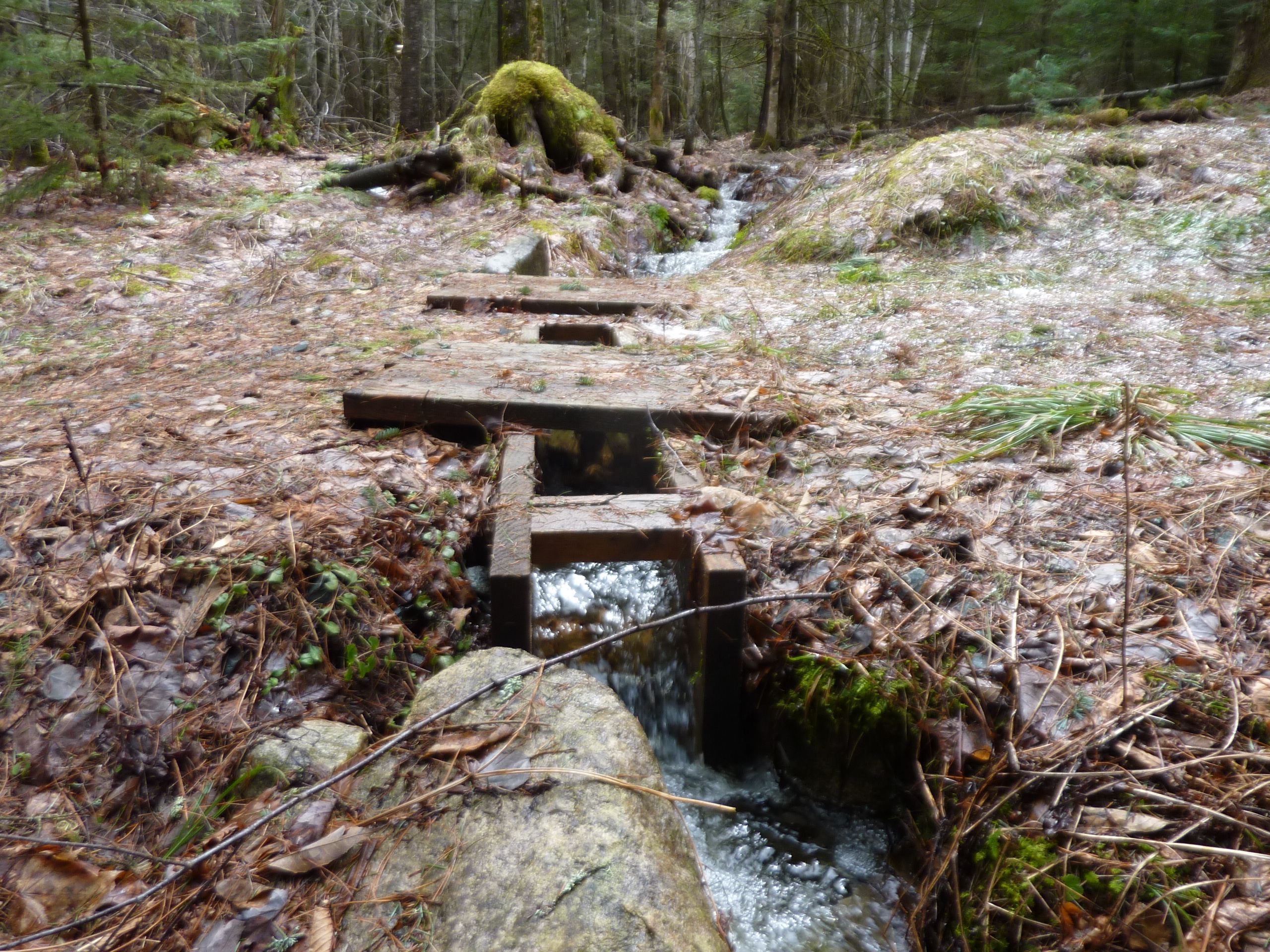

I like that and it is a nice job especially seeing that you sawed out your own lumber. I build stuff out of wood too. Never a bridge yet though but I could use a couple. Wood doesn't last forever but it lasts longer than you would think. These open culverts are good on woods roads because are easy to keep clean.

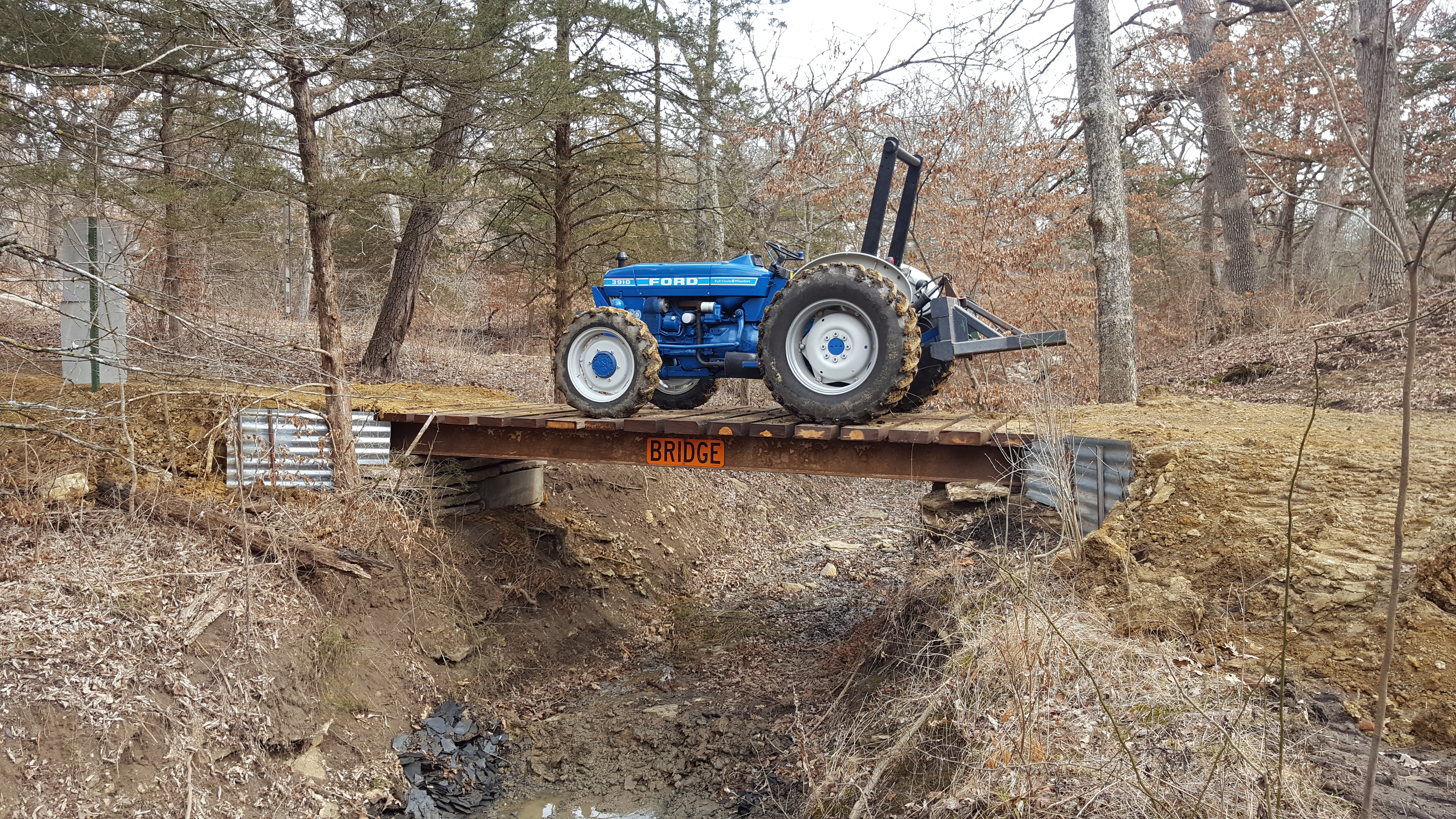

here i one i rebuilt two summers ago, i was able to obtain old light poles for material then took them to a sawmill and they make them into 5 inch thick slabs to put down as the floor across the steel beams - this old bridge is on an abandoned road that connects land that used to be my mothers when she was a child and was sold after her parents died, i am fortunate to have gotten to use the land and maintain it for the lady that now owns it for many years - this was very neat for me to get to do as its kind of sentimental and i was able to take my mom down to the old creek/bridge where she used to play as a kid 70 yrs ago - yes we cried and hugged in the middle of the bridge ;-)
15 x 13 feet i believe it was and it was about 12 feet deep in the deepest spot from the bridge to the creek bed.

With concrete abutments and steel support beams, searcyfarms, you were halfway there! I wish my project was starting from that same point...I need abutments, beams and deck, so a lot more work. Your finished bridge looks really nice.
