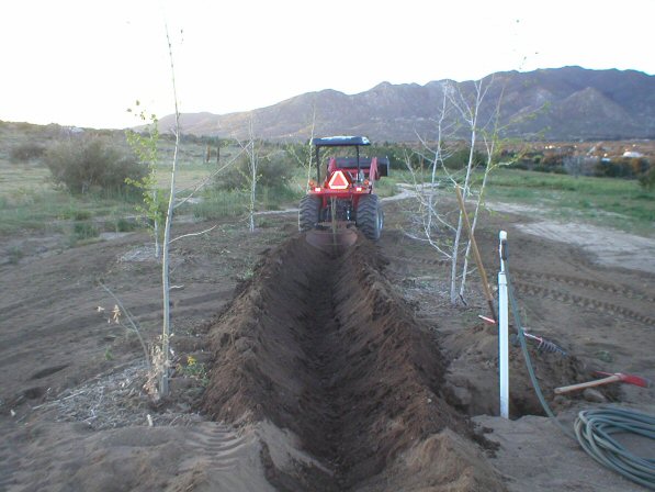

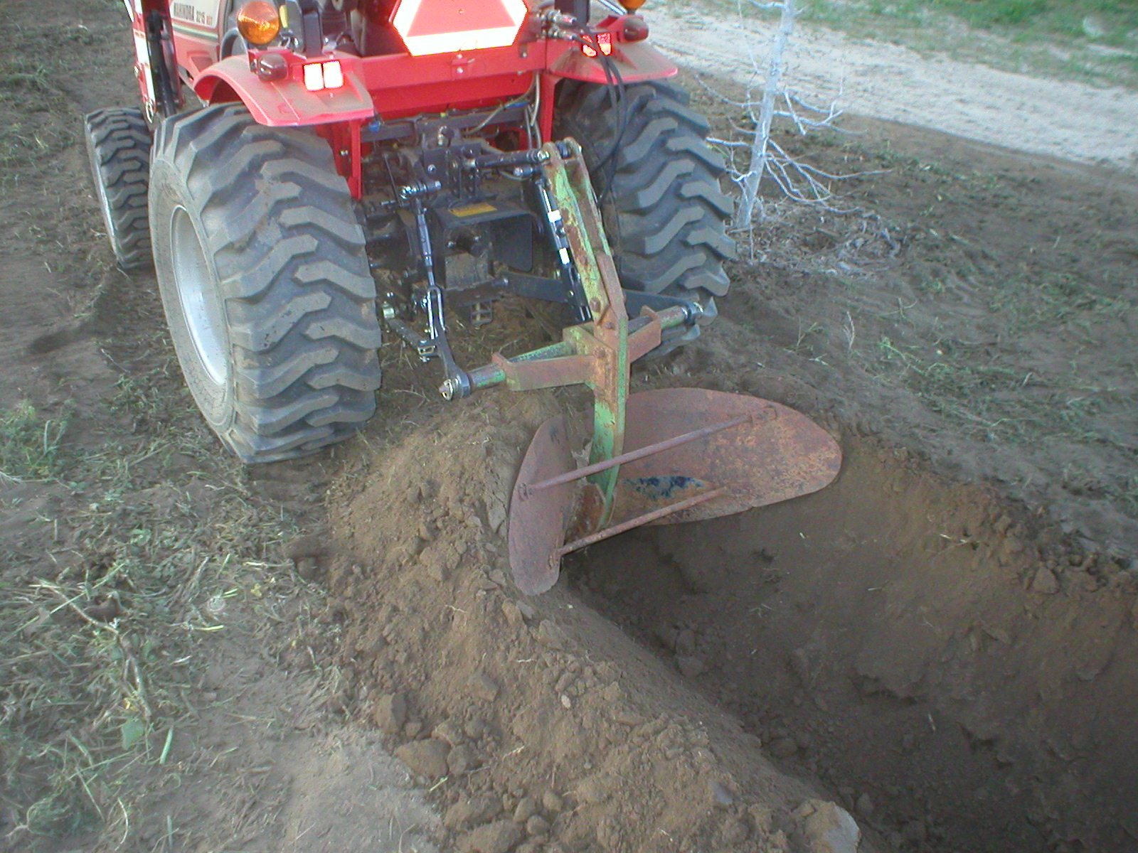

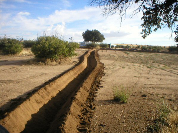

Been there, done that. For our type of ground, this simply CAN NOT be beat for shallow trenches, and we have an actual trencher that goes 5' deep.
I was fortunate to find this ditcher by John Deere. Very old. :cool: It was made for making actual irrigation ditches. 9" wide at the bottom and 19" deep from ground level. the long ditch is almost 300' long, took less than 5 minutes to pull. I simply put the blue tractor in 1st gear low range and idled the distance. If you want the ditch clean-clean, a flat end shovel should be used to clean out the crumbs.
This is one of the best implements I have. Really makes putting in irrigation lines a breeze. :thumbsup:
