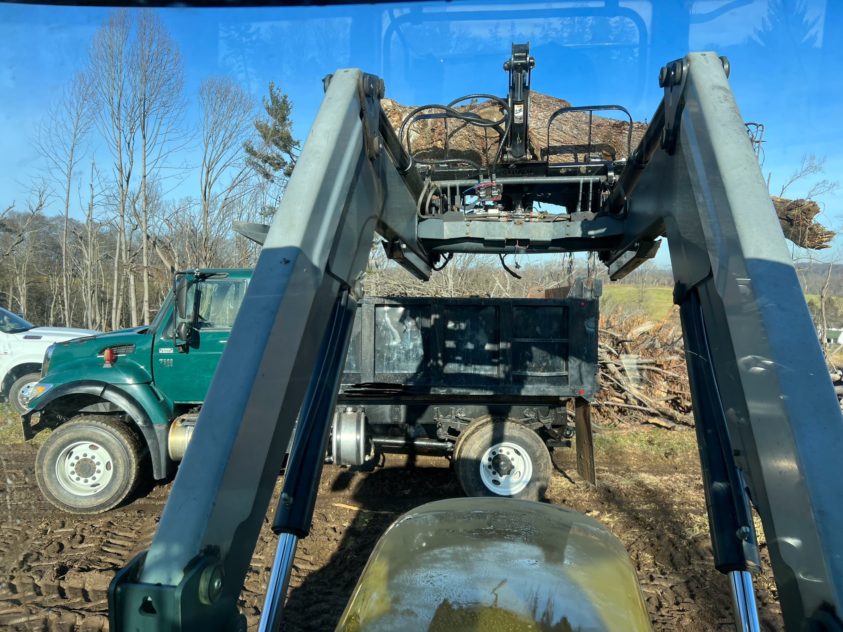

I wondered about height.
You know about the 6x6 dream, I have limited experience in that class truck (in awd), but in reality (and IMHO) if a tandem with inter axle lock is not enough to pickup your big squares in the field, you really shouldn't be there unless it's just the morning dew and a few hours of sunshine would make it passable.
Maybe adding some additional time to the weather guesswork that hay making is and stack near a roadway or somewhere with suitable (flat & hard) 10 wheeler access.
That’s kinda what I think. We’ve had loaded dump trucks in pretty bad places and when they do get stuck I can’t imagine 6x6 changing the outcome all that often. Maybe after the dump truck dumped the load 6x6 would have helped but there’s zero chance it would have came out loaded.
You have to own & operate one to really know. We did 2 winters of sloppy, muddy work with my 4x4 dump. Several days of driving over frozen ground with the upper 1” thawed is really challenging, but the 4x4 (along with the diff lock rear) made it possible to haul logs when tandems would have been stuck. Even my buddy with a Mack tri with lockers wouldn’t venture where I would.
That front axle can get you out of trouble (it can also get you in trouble if you get over confident)
Once the sun gets on this frozen trail, it’s slicker than owl schit.

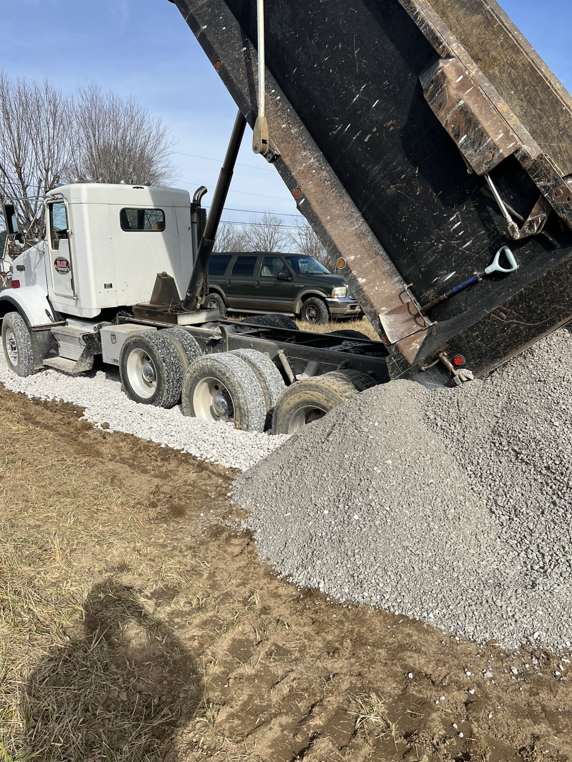

My 2-year search for a hay truck might have finally ended.
At the outset, I wanted a long tandem, 6x6, automatic.
Budget was only $30,000, so as you can imagine, it greatly limited my choices.
Looked all over the country and found many of them, but most were over $50,000. They would also need the auger or bucket body removed and a 24’ flatbed installed. That adds another ~ $10,000.
Also most were grossly underpowered (DT-466, CAT C-7, etc), because they only needed enough ass to pull the truck with a auger or man lift.
So I gave up on 6x6 traction and decided that a 6x4 with full locking tandems would give me the traction I need most of the time.
That opened me up to a lot more choices since so few trucks are 6x6.
Then the battle turned to finding a long tandem 6x4, full lockers, automatic, but now I had more choices in bigger power.
So anyway, I found a 2006 Sterling with a CAT C-13 @ 415/1400 and as a bonus, it has a Allison 4000 series. Most smaller displacement trucks have a Allison 3000 series.
I can buy this for way under my 30K budget. Even with shipping (1,000 miles from me)
The only downside is it will need painted. 310,000 miles on it, but seller showed me a video of engine running. No blowby. He also drove it while face timing me. It seemed to run & shift fine. AC works, has trailer brakes, jake brakes, locking diffs and a PTO. Bed has sliding ratchet straps and tool bin/box. Also has air to rear and pintle hitch for PUP trailer (which I am going to try to find the one that went with this truck).
There’s nothing by some minor surface rust as it has been a southern (Tennessee) truck most its’ life.
I know it ain’t pretty. I will paint cab white or dark green. It will be tagged as a Farm Truck.

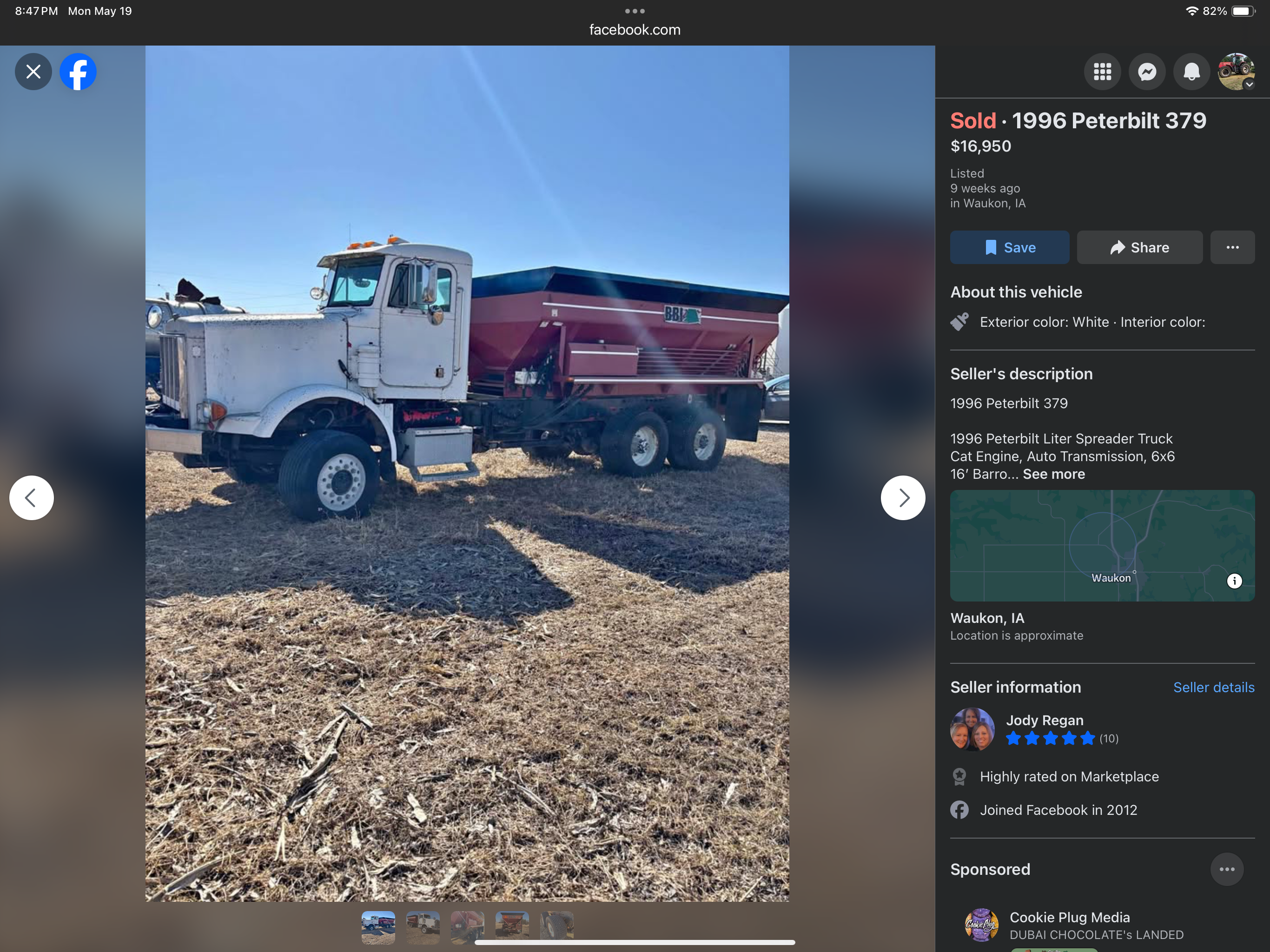

I’ve never seen a 6x6 concrete truck that wasn’t a front discharge. You can’t do much with a front discharge truck because they’re rear engine.
   / Should I buy this truck?
#72
There’s some 6x6 rear discharge still running around. One of our local redi-mix companies has a 4x4, too.
This one was for sale. It was a former concrete truck.
The front discharge trucks are the industry standard now.
Problem with large 4x4 & 6x6 trucks are employees. They cowboy ‘em to death, break ‘em and they’re more expensive to repair.
