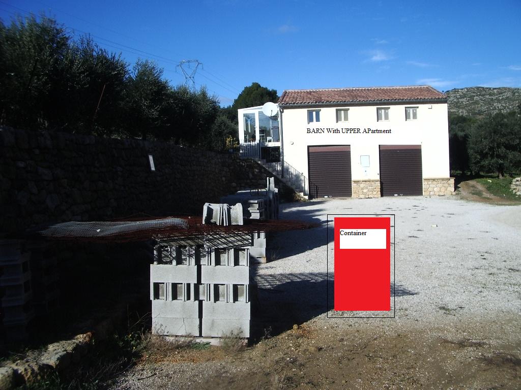

What's in the barn or behind those garage doors?
Could you remove whatever is in there and store it somewhere else and use that space for the mill? Could you put what's in there in the container?

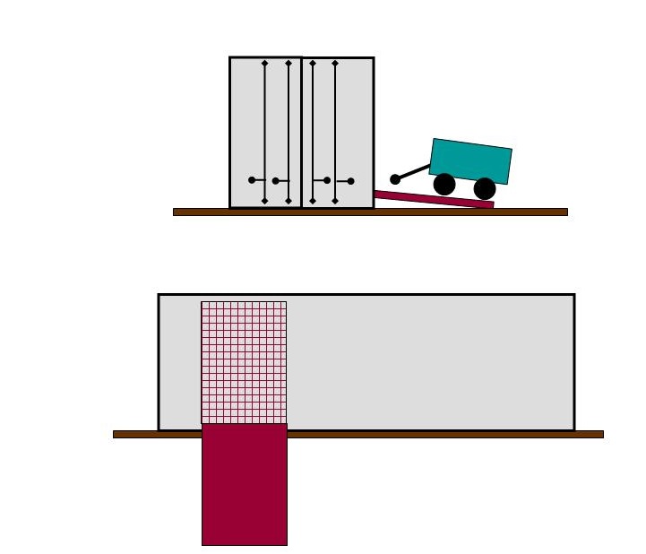

OK rox, here is an outside the box suggestion.
I know you aren't allowed to process olives in your existing garage, but can you store them and heat them in the garage?
If you can do that, the way I would set this up would be to put a warming station in the garage.
Then I would get a 20 foot container. You say the equipment can be installed in a 5.6 meter length, which is 18.67 feet. The equipment can all be installed inside the container. And I don't really think you want to do anything in that container other than process olives. From reading the literature on it, and looking at the drawings, it appears that this mill is pretty self contained. You dump olives in one end and pump olive oil, dirty process water, and depleted olive paste out at various locations.
Set the mill in the container up close to your garage. Get a some wagons which can be used to haul pre-weighed olive crates to the input end of the mill. Dump the olives into the hopper and go back for more. I don't know what your olive oil carts look like, but you either need to get ones with wheels big enough to roll on your gravel, or put them on wagons with big wheels.
Here is the kind of wagon I am thinking of - Harbor Freight Tools - Quality Tools at the Lowest Prices I have exactly this one and it will easily carry hundreds of pounds of material over my gravel driveway. I have also seen ones with wire mesh sides, but don't have a link to them.
You will probably need more than one, but they are inexpensive. You can either pull them by hand, or use some kind of tractor or vehicle to tow them. If you can use your neighbors mini-excavator with forks that would be ideal. Instead of wagons, put the boxes and oil containers on pallets and fork them around.
You don't have to bring the wagons into the container. Dump the olives into the hopper by hand and pump or drain (depends on how the centrifuge works) the oil out into oil carts already on the wagons.
This eliminates dragging anything heavy over the floor and opens up the possibility of concrete, vinyl, or fiberglass over the floor.
I know you aren't allowed to process olives in your existing garage, but can you store them and heat them in the garage? We think so and probably will do this although prolly not 100% legal. Rain is our issue here, we need to keep the olives out of the rain.
Then I would get a 20 foot container. You say the equipment can be installed in a 5.6 meter length, which is 18.67 feet. The equipment can all be installed inside the container. And I don't really think you want to do anything in that container other than process olives. From reading the literature on it, and looking at the drawings, it appears that this mill is pretty self contained. You dump olives in one end and pump olive oil, dirty process water, and depleted olive paste out at various locations. That is it, that is why I made the flow chart.
Set the mill in the container up close to your garage. It is going to be 50ft from the garage, that is why I went out and took site pics to post, to show the site. Get a some wagons which can be used to haul pre-weighed olive crates to the input end of the mill. We already have a wagon very similar to what you show jsut smaller, I think it holdds 4 crates 2 on the botttom and then stacked 2 on top. It has the tires that go over gravel. Dump the olives into the hopper and go back for more. I don't know what your olive oil carts look like, but you either need to get ones with wheels big enough to roll on your gravel, or put them on wagons with big wheels.
This eliminates dragging anything heavy over the floor and opens up the possibility of concrete, vinyl, or fiberglass over the floor. The press itself is still gonna be pretty heavy.

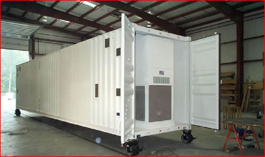

Duro-therm Panels
I'm also thinking of other ideas like fold-down doors on the side of the container that allow access as ramps and also provide more open area inside. If you had a fold-down door you could add a canvas canopy (fold-out) above and maybe curtain walls. You could enter or exit the container by these ramped enclosures. Raising and lowering the ramps could be accomplished with ropes, pulleys, and counterweights for ease of operation (not drawn). They would also improve your ventilation tremendously.

Are the unprocessed olives considered flamable? Is it legal to store them in the garage?
How about the finished oil drums? What are the temperature requirements for storage? Do you have a picture of one of these oil drums? I think you called them "carts" before. I am having a hard time visualizing this. You said 60 liters. I have seen 15-gallon metal drums, do they look like those. Wheels? Dimensions?
We also need to add a floor scale as shown on the flow chart you need to weigh first the olives then the finished oi, 20 ft would be to small. Although I might sotre olives pre press in our existing garage I don't think customers are going to want their drums of oil in the garage, I'll need to keep it inside the container, just for estetiques
Why couldn't the floor scale be in the garage? It needs to be level, and the container floor has to be sloped.
What is the practice with the drums? When you take you olives to the mill do you also take empty drums to hold the finished oil? Where are they stored at the mill? Both empty storage and after they are filled.
