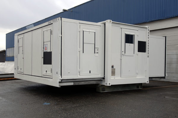

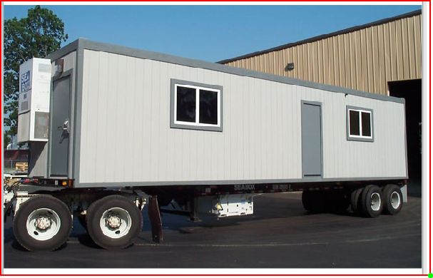

My husband and I would really appreciate your help and advice on our Olive Press/Mill Project. We looked at many options and it looks like we are going to go with converting a 40 High Cube shipping container into the building to house the press. After 3 years we then intend to build a regular building probably on the same site, and move the container and use it for storage. Cost is the driving factor as just the cost for the press is going to be about $85,000, plus delivery and installation etc. Add to that the cost of a building and you can see how we need to economize to start with.
Here is a link to the site and starting photos- In Picasa make them full screen to see the labels
http://picasaweb.google.com/ProvenceOliveOil/Smaller#
We are going for a simple conversion as shown in the pic that has a couple windows and doors. I started off trying to find an expandable container but at $240,000 a pop had to drop that idea real quick. 2 photos of expandable containers are shown, one exterior one interior.
Here are a couple links to Sea Box a company that modifies containers
http://www.seabox.com/v3/modified/examples/
http://www.seabox.com/v3/modified/gallery/
I will start with several posts in order to break out the different pars of the project. In this way all you great TBNers can respond to sections of the project more easily. It took me hours to write this thing up so I could present it nice and organized.

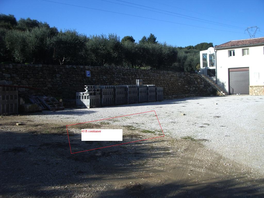

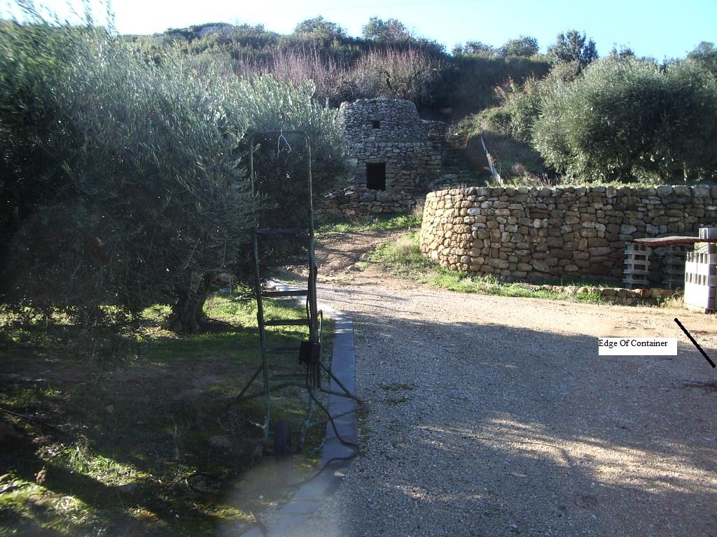

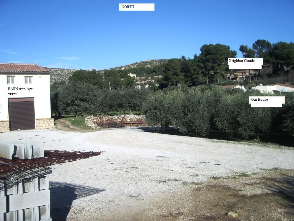

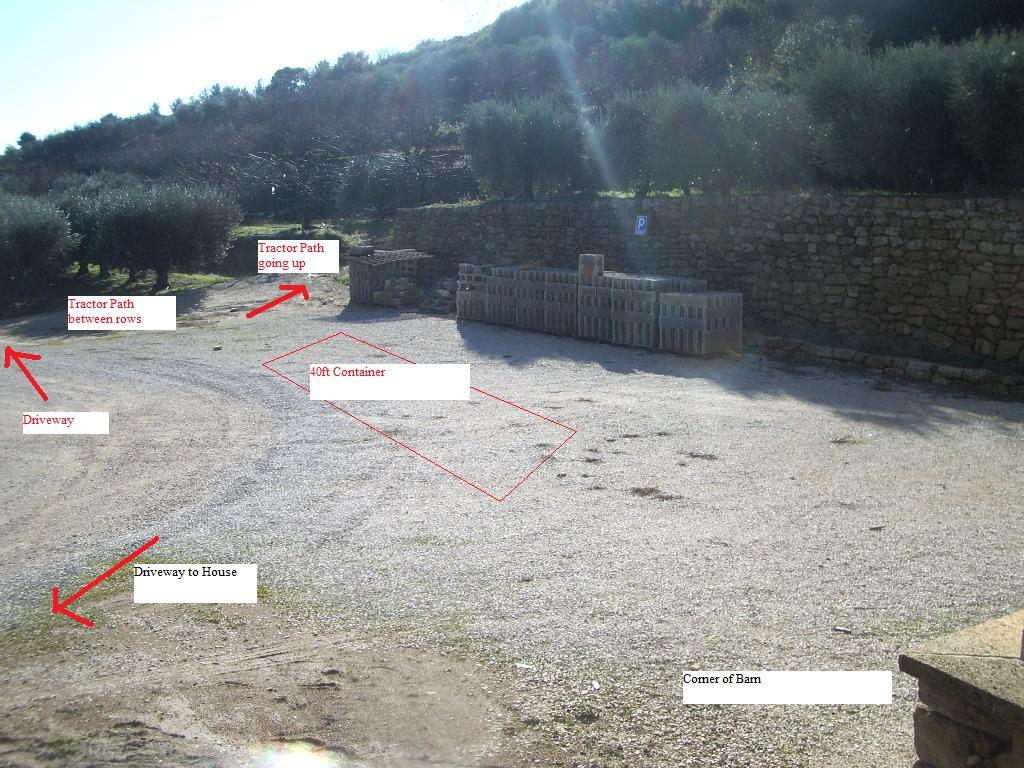

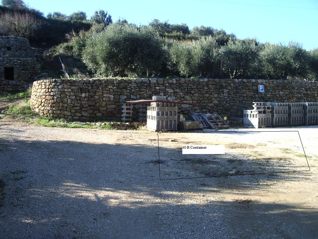

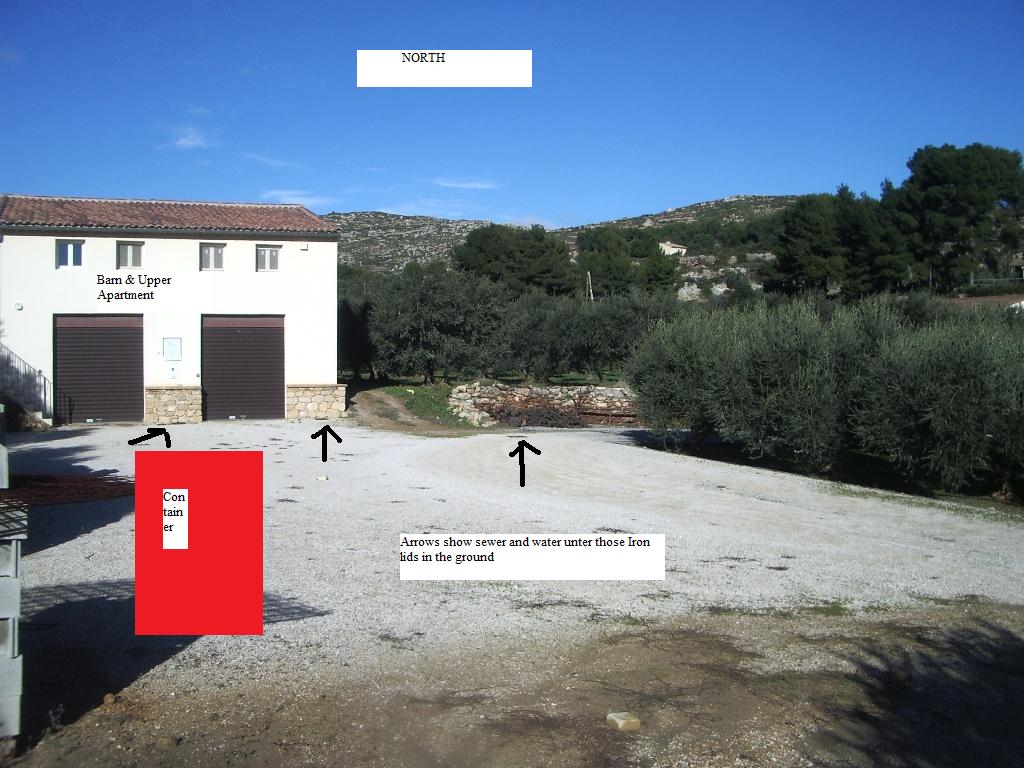

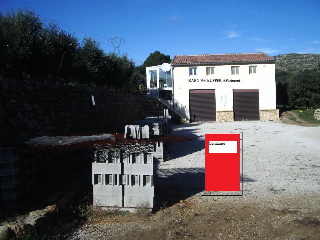

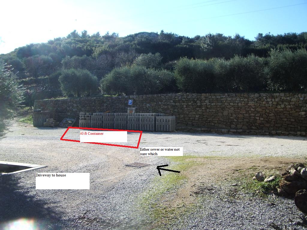

Part 2 of the project The Site
The site is nicely situated with good drainage and ready access to sewer, water and electric. You can see the pics. Perhaps I don稚 know what I don稚 know but if you have any comments or suggestions on the site please offer them. We are thinking to just bring in the container and plunk it down. Well kind of. I guess we should raise it up a little bit to prevent rainwater entering. I am looking for suggestions here. I did see a photograph of a container on wheels.
The olive crates are pretty heavy when filled like about 50lbs. It would be nice to be able to use a dolly to move them into the container building. Our neighbor has a mini excavator with forks so maybe there is an opportunity there to fork them up into the building.
I am going to try to get away with not installing a toilet as we have a nice one in the barn. We値l see if that flys or not, I think it will. I think we will have to connect to our sewer system as we will legally need a sink in the building. We will need to bring in water as well. We will also need floor drains as there tends to be a lot of mess during milling. This information is pertinent to the site I think.

Part 3 of the Project the Container Building shell & cutting into it-
Since the measurements of the mill are given in meters I値l give the dimensions of the container in meters also. Since we have space the outside, the external dimensions are not as important as the inside dimensions so I will only provide the inside dimensions.
Interior Length= 12 M (Meters)
Interior Width = 2.33 M
Interior Height = 2.65 M
Cost- We have a quotation of a single use 40ft high cube container for 3,600 Euros
The single use ones mean it was only shipped one time, they are like brand new, nice paint good floors etc.
Windows and doors and holes-
3cm for electricity
3cm for water
10cm to evacuate olive paste residue
25cm to evacuate leaves
12cm cut in floor for drain
245cm wide for a roll up door
486 Euros is the price quoted to cut the holes
90cm wide x 200cm Tall for a Man Door
100cm x 100cm for a window
390 Euros is the price quoted to cut the holes
But actually we feel we need 4 windows
Installation Price
A Window 150 Euros
A Man door 150 Euros
I am inclined to think we need two roll up doors, 4 windows and one man door plus the cuts to bring in utilities and the holes needed to excrete the olive waste, leaves, paste, water. We would have a door company install the doors, man and overhead.
What tools are needed to cut out the openings? This is a complete mystery to us and we are hoping for a lot of input here. Exactly how is this done? What tools are used etc.

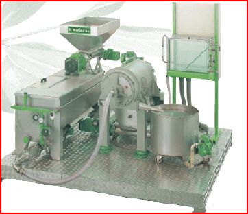

Part 1 of Project Flow chart of olive mill- How does it work from olive intake to olive oil output. Please see the flow attached. Additionally I値l list the steps below-
  • Olives enter in crates
  • Olives are weighed on a floor scale
  • Olives are dumped into a DLE. A machine that removes the leaves and twigs, washes the olives and then augers them up to the hopper for crushing. The leaves exit the building via a pipe.
  • Olives enter the hopper and pass on to the crusher, they are crushed pitts and all, producing olive paste.
  • The olive paste moves to the maloxer which is kind of like a kneading machine, the olive paste is kneaded to tease out the olive oil from the meat of the fruit.
  • The paste and oil move into a centrifuge which spins everything and the paste is extruded into a pipe with a pump and is pumped outside. The oil water mixture is moved to a decanter. (On the flow chart and schematic the decanter is not shown. Shown is a Florintine Vase which we won稚 be using.)
  • The decanter separates the oil from the water. The water exists via a pipe to the outside.
  • The olive oil is weighed. Interestingly the volume is oil is not determined volumetrically, instead the volume is determined by weighing the oil. They know that xx kilos of olive oil = xx liters of oil.
  • The residue olive pasted is pumped outside the building and must be pumped into something. There are a lot of environmental laws on this. What the mills typically do is pump it into a fertilizer spreader and spread it out in their fields. The only fertilizer spread we have is a cone shaped one so I don稚 know if that has enough capacity or not. Plus my husband needs the wagon (connected to the PTO) on the back of the tractor to bring in the olives so we have an unresolved issue on how to deal with the residue olive paste.
  • The waste water from the DLE. This isn稚 very much but we still have to eliminate it. Initially I am thinking of a dry well.
  • The waste water from separating the oil and water mixture. This is kind of toxic water and needs to be handled correctly, there are regs on this. It can be used to spread on your fields as weed control, but we won稚 need weed control in November when the harvest is. We do have 3 plastic tanks at 1,000 liters each and we may just pump it into one of these tanks.
