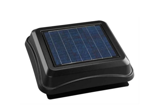

If you do go with a container, be sure you get it off the ground so you have air circulation under it, otherwise you'll have lots of humidity inside and things will rust quickly and leather with mold & mildew. May want to add exhaust fans for the interior. Someone posted some solar powered fans they'd added that looked like would work well. Be sure it is level or the doors will stick.
100% agree. I have used tractor trailers as storage. The temperature change from a hot day to a cool night will cause the inside of the trailer to sweat. I have seen furniture stored in sofa bags sweat and mold. Cutting vents in the front of the trailer is not enough.
I have not tied this attic fan but I will next time I use trailer for long term storage. It is solar powered if you do not have electricity to the drop location. 3Tsgave good advice
