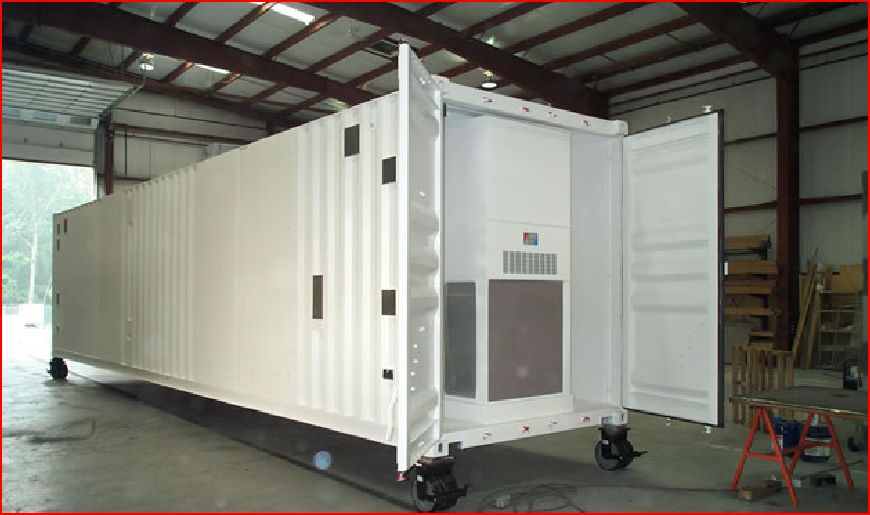

I have been thinking about the concrete and how heavy that is going to be.
One day we want to move this thing and build a building in the same spot. Do you think we should have wheels put on it? Something like this photo shows.
I don't know how we would get it to the next spot as the driveway isn't wide enough for the neighbors lift truck, it is not 40ft wide lol. The lift trucks pick up the container in the middle and move it widthwise, they dont' move it lengthwise. Otherwise when we went to move it we would have to get in a truck, use the lift truck to put it on the truck and then truck it down the driveway which is a lengthwise move, 100ft, and then lift truck it into place. Seems like wheels might be a good idea. What do you think? Could we pull it with our Mercury Mountianeer or our tractor if it was on wheels?

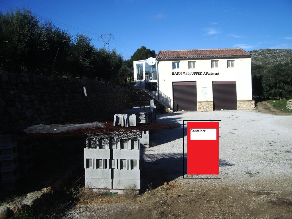

We do have rebar as shown in the pick below. Does it matter if it is rusty?
FYI the cement blocks are special blocks that are made for building a swimming pool every contractor who looked at them said that. When we bought they were supposed to have built a pool but then the husband died and never finished it before we bought it so we have a few pallets of swimming pool block. I think it must be kind of pricey as the contractors were interested in it. I dont' think we'll ever use them, and I would just as soon sell them, as I would want one of those formed pools they bring in by truck, no leaks. It is a point of disagreement between my husband and myself and you can see he is winning the argument as the blocks are still there. Now maybe since we'll havve to move them he'll let me sell them.

Rusty rebar is better but I don't think that is rebar . It looks like wire mesh but I am not really sure.

I think the way to move it would be to jack it up and slide a wheel assembly under it. House movers can move anything in very small spaces. This thing is not very heavy. The 6m container weight by itself is 3080kg
Wheels like the ones in your picture work well on concrete, but I think they are too small to be effective on gravel like you have.
Any decent crew of riggers ought to be able to lift this up a few feet and put mobile home wheels, or something similar, under it even with a heavy concrete floor inside. It might cost something. I once watched a crew of about 5 move a 3 M wide x 10 M long steel vacuum chamber with about 5 cm thick walls (very heavy) out of a building and onto a truck in less than 3 hours. I don't know what they charged, but 15 man hours can't be that expensive.
I am just wondering if there isn't something which would be both lighter than concrete and removable for the floor. Maybe fiberglass with wood blocking underneath?
