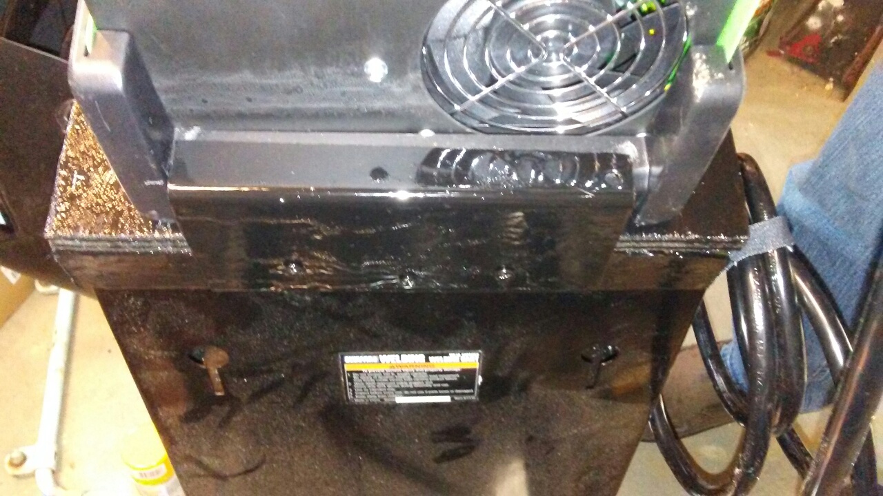

I realize your machine will be different but here's how I secured one of my migs. It may give you some inspiration. It's a "tilt and slide" design. The first photo shows the self seating "tab".
I haven't had a welder yet that I couldn't secure without VISIBLE constraints. :)
Terry

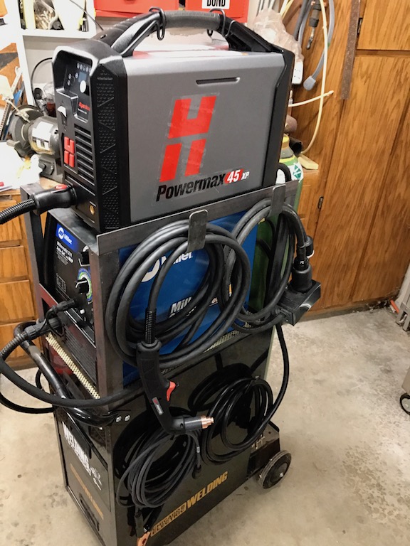

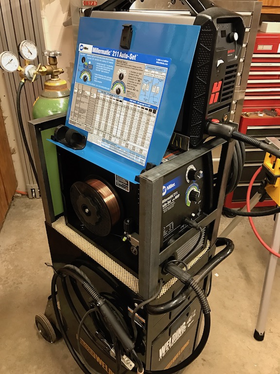

That's kind what I'm grappling with. I'm pretty sure I can lock the back down but don't really want to drill holes in my new machine. Maybe I could use the screw on the left side of the case and something underneath the door to Velcro it into place in the front.
I have the HF bigger brother welding cart which I love. I needed a place for my new plasma cutter so I built a removable 'cage' over my welder to trap it and also support my plasma cutter on top that is snug fit. Also added a couple more hooks for leads and power cords. I had to position my welder nearer to the non opening side so the door would clear the flange on the cart. My design also allows the door to swing to the full open position by offsetting the plasma to the non opening side. Offsetting the plasma cutter also kept it from blocking the access and view of my tank and gauges. I really wanted to stack because my shop space is a premium. Still need to paint it once it warms up outside or I get some serious heat inside the shop!

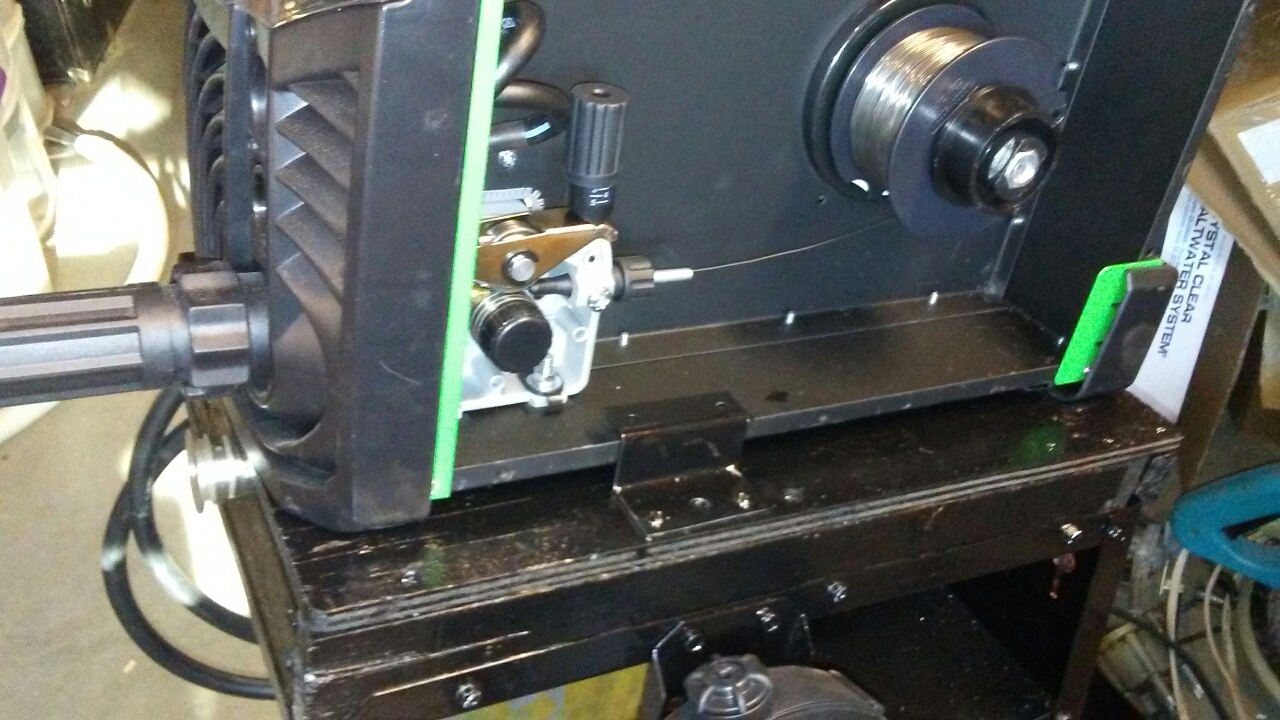

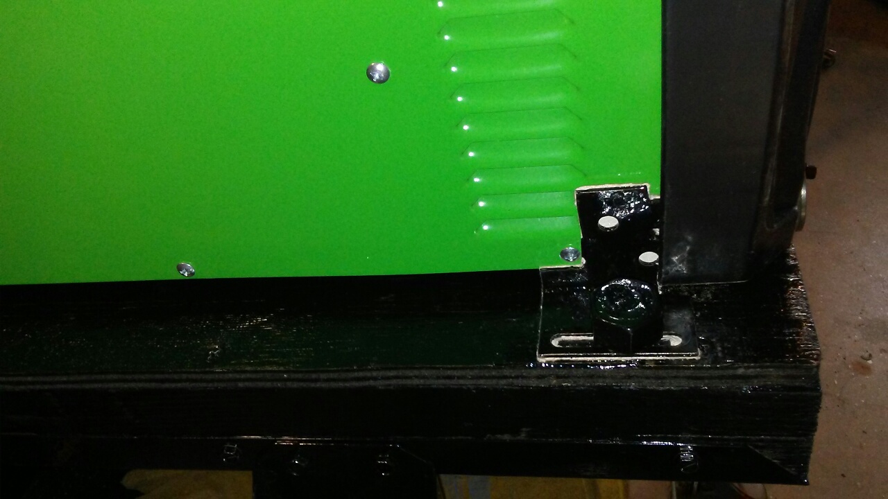

I liked how someone else modified their HF cart because the welder did not fit. They made a platform that was high enough to add a drawer out of wood. I did something similar which allowed me to screw some metal pieces for ease of locking the welder down. There's an angle iron type piece in the back that the rear of the welder fits under then I slide it to the right so the door side fits under another (door still latches fine). Lastly I have a piece on the left side that slides into the face cover, this piece is locked down by a bolt that has a large nut welded to it for easy removal. That is hard to make out because of the shiny black paint. I really like having the drawer to put parts in. I can fit a couple 2 pound spools of wire in the back.
