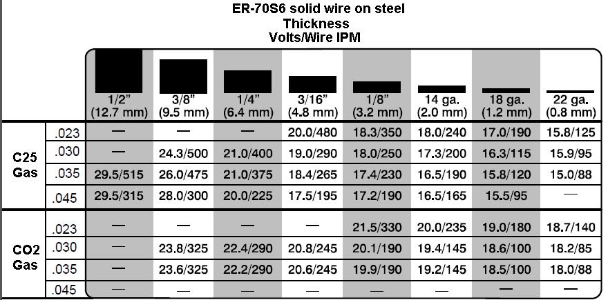

So, I like the new welder and have gotten good at thin metal. I tried to do some thicker stuff but ended up with balls of metal instead. This welder did not come with a chart like I see on the inside door of some. Any rules of thumb? Examples of rules needed.
-how much to jump up on power/wire speed as the metal gets thicker? Example is double the thickness of metal and do what with the power vs wire speed?
-balling means? (as far as I can see it is too much power for the wire speed)
-the balling seemed to happen when welding with the tip up, when I did it with the tip down the weld was decent but probably cut in too much.
-at what point do you need to go thicker wire? I have .023 right now. Change when wire speed is close to max?
I realize what I need to do is spend time using it but I don't always have extra time compared to the project at hand. The weather also has not been cooperating. Thanks in advance for your thoughts.
/ Sheild gas thoughts? #73
Mike, here's a clarified version of the chart from my MM252, maybe you can get an idea from that - but before it's gonna mean much, you will need to "calibrate" voltage and wire speed - otherwise those knobs won't tell you much unless you wanna keep a notebook like "got best results with .023 wire on 1/8" steel with knobs set at 2 and 5", etc -
Another option - if your manual tells you more about what those knobs mean, the chart below should help - otherwise, keep reading -
With the "calibration" method, you would first disconnect the drive roll so wire doesn't feed - it should still be "hot" when you squeeze the trigger tho, then with a volt meter between ground lead and the mig wire, you should be able to read the voltage at each # on the knob and write those down ("1=16volts", etc...) In reality tho, those will be "open circuit" voltage; in use, the voltage will probably be a bit less.
To calibrate wire speed you would hook the drive roll back up so it feeds - then, starting with wire just barely sticking out of the tip, set the feed knob to "1", squeeze the trigger for EXACTLY 6 seconds and stop - measure the length of wire (in inches) and multiply by 10 - that is your IPM at "1" - repeat for each knob setting til you have a chart of wire speeds at each knob #.
From there, hopefully your LWS carries the Miller "slide rule" Mig calculators, they're only a few bucks - it's a physical version of the chart found here, only better
MIG Solid-Core Welding Calculator - MillerWelds
Hopefully this will give you an idea - personally, with that welder I'd consider just sticking to .030 wire - I've welded 18 gauge with mine using C25 gas and .035 wire, .030 should take you down even thinner... Steve

Very good info, never thought to measure the voltage on the unit but logical. As for the thin wire, it's works great for car body panels which is what we use this for the most but I will have to buy some thicker stuff too.
