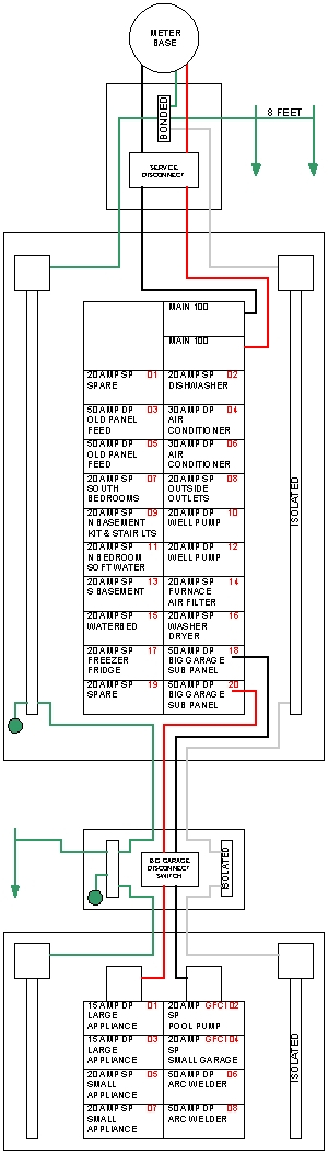

Getting ready to do a shed project that has the following parameters:
1) Power to shed will be from an exterior, post-mounted meter and breaker panel.
2) Distance from panel to shed anticipated to be approximately 50'.
3) Shed needs two circuits:
a) 20A dedicated to an HVAC split system (can be either 240v or 120v) and
b) 20A circuit for three outlets.
My question: Does this application require a subpanel in the shed? The NEC is a bit tricky to interpret for a specific case: It seems that if the HVAC is 240v, it is not considered a parallel feeder with the second 20A/120v line, and both circuits to the shed can be wired directly to the external breaker panel, without a need for a subpanel.
I don't have a problem doing a subpanel, if it's required by code, but the shed will be a temporary setup, and since I have a breaker panel nearby with ample capacity, so I don't want to overkill this, if I don't have to.

Yes, a sub panel will be required. NEC 225.30

I'm not saying this is the case with the OP, but in some areas it's against code to run more than one circuit to an outbuilding. Two or more requires a sub panel.

And that's where the NEC gets confusing. There are a variety of exceptions to NEC 225.30, and I'm trying to understand if they apply.
Ultimately, I'll put a sub-panel in if I have to. Just want to make sure that's what is required.

My thoughts are if you go with no sub panel, and I may have missed or be incorrect about some things, you're going to have to at the minimum:
- take up 3 breaker slots in the original panel.
- one single pole breaker.
- one double pole breaker.
- one cable with 2+N+G out to the shed for 110
- one cable with 3+G out to the shed for 220
- anything else that I can't think of.
If you go with a sub panel:
- take up two breaker slots in the original panel
- one double pole breaker in original panel
- one sub panel at the shed
- one single pole breaker at the shed
- one double pole breaker at the shed
- one larger cable with 3+G from original panel to shed
Pros:
- you'll take up 1 less slot at the original panel.
- no 110v cable from house to shed needed.
- room for additional circuits at the shed in the future (big plus for me)
- only 1 wire to run
Cons:
- one more breaker to purchase
- one sub panel to purchase
- may have to purchase an additional ground rod
- heavier feeder wire to shed will cost more.
- two cables have to leave the house and enter the shed
- it may be the only legal way to get 2 circuits to the garage in your area
Anyhow, just some things to think about. It's always nice to have power in an outbuilding. And it seems like I'm always wishing I had an additional outlet on mine.
Good luck with your project. ;)
   / Shed wiring question #17
Got me thinking about how I wired our garage. This is a diagram of the entire setup from meter, through house, to garage. Kinda grainy, but you get the idea.
   / Shed wiring question #18
@rbstern Why penny pinch on this one? Why wouldn't you just put in a sub panel? I would put in a sub panel and future proof your options, as @MossRoad did.
