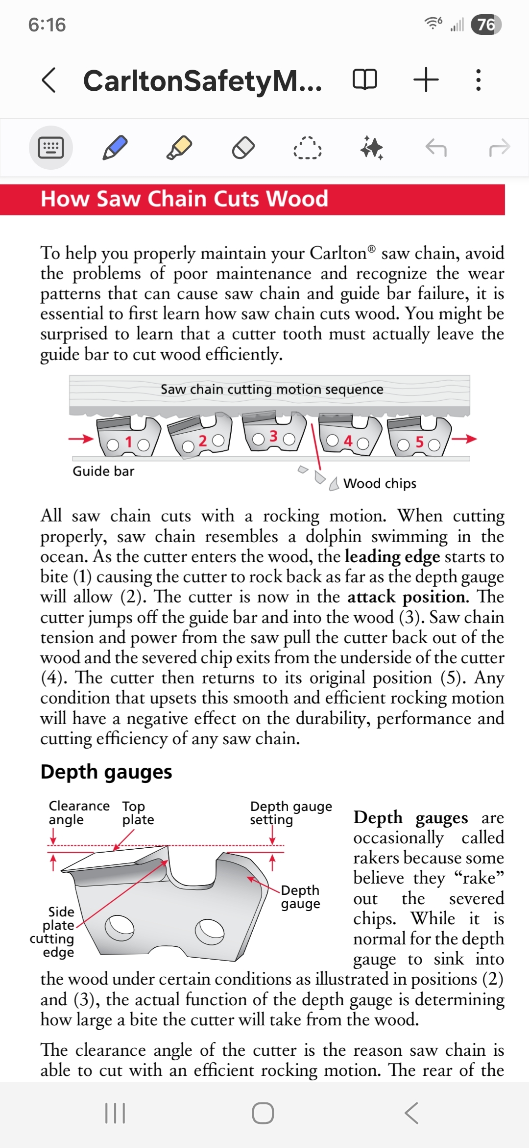

I would differ on that. A band blade and saw chain are completely different. On a chain, each tooth acts independently based on it's depth tooth height. Three teeth in a row isn't relevent. Tooth lenghts can be all over the place as long as the depth for each is set correctly.

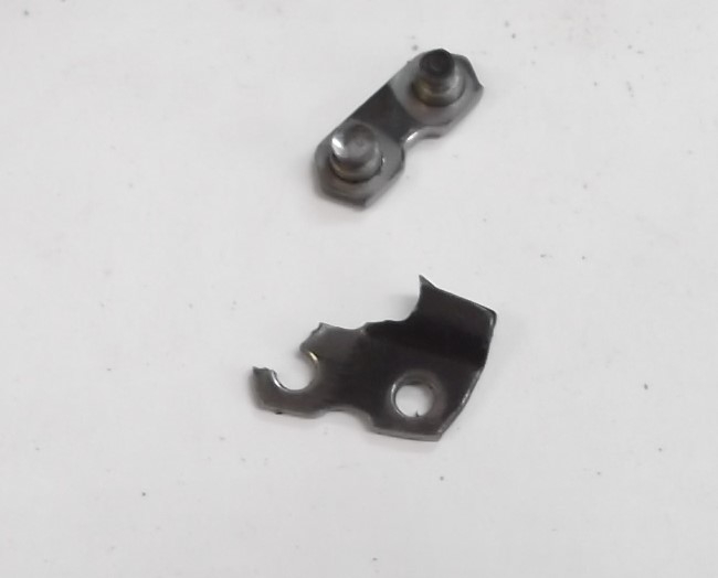

Always inspect your chains too. Found this a coulle times on chains that come in. For me easy peasy. Break and mend.
