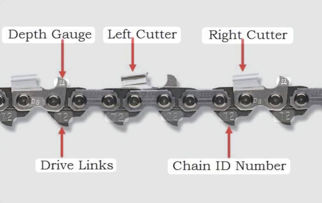

Years ago my wife & I took a small engine repair class at a local community College that a friend was teaching who owns a local sales & repair business of chainsaws, mowers...basically all lawn care products.
He said the depth gauge needs to be cut down a bit each time it's sharpened which makes sense, but said a lot of professionals cut the depth gauge down to the chain. I tried it and it cuts very fast.
Has anyone heard of this?
Down to the chain sound crazy, I don't buy it one bit and I have never heard anyone doing that and I have been around my fair share of '' pros ''. Most ''pros '' will on a brand new chain bring down the raker right off the bat (including myself) with 3 stroke of a file, then after every 3 or 4 sharpen I will take them down. They do run on a more aggressive chain then most but not all the way down.

It's easier to show than tell. Plenty of good videos on Youtube on the subject. I did tree work for a living for over 20 years, FWIW. A few things to keep in mind:
-A vise can help keep things in place while you sharpen. I got so used to sharpening saws in the field that I don't bother using a vise, but if you're struggling, a vise can make the difference.
-Sharpen often. When I was doing tree work full time, a ground saw would get sharpened at least once a day, sometimes three or four times if it was being used to cut firewood rounds. A climbing saw, that didn't see dirt, might only get sharpened a couple times a week.
-Be very careful with powered sharpeners, Dremel tools, etc. I know some people swear by them, but it's very easy to get the tooth too hot and ruin the temper with those.
-Safety chain sucks and is a hassle to maintain.
-Keep the file at a very slight upward angle.
-Don't forget about the rakers. They need to be filed down as well. Not every time the teeth are filed, but they should be checked every so often. After a while, you can develop an eye for how far down they are and should be, but, generally speaking, they should be around .025" below the teeth tips. A bit more works fine if you're cutting softer wood, a bit less for harder.
-Stihl chain has a line stamped into the tooth that shows the optimal tooth angle. That's handy and in case you weren't aware, you don't need to have a Stihl saw in order to use Stihl chain.
-Pferd makes great files.

Long time ago - I hadnt been using a saw very long - the idea of taking down the rakers was brought up. I went home and took an angle grinder to the rakers,,, The problem is that when they are not taken down fairly uniformly the chain will grab where the rakers are down too far. The saw can be hard to controll. What I have learned since is to file the rakers down with a flat file a uniform number of strokes. Three or four is generally enough. Then file the teeth so that you dont mess up a tooth taking down the rakers
I always knock my depth gauges down a little below spec when sharpening each chain for the first time, which allows the teeth to take a bigger "bite" and cut much faster. It's why you see me always arguing for larger saws on smaller bars, since pulling a more aggressive chain does take a lot more horsepower... you ain't gonna pull that chain around a 20" bar buried in oak with a 50cc saw. :LOL:
But I only knock mine down to .032" to .036", whereas standard spec is .025" to .026", so my bite is only 25% - 40% more agressive than stock. Even that amount of change makes them very grabby on smaller diameter wood.
Taking the depth gauges right down to the top of the links is going to cut a little faster in a long kerf, if you have the horsepower to pull it, but would make the thing totally unusable in any cut lacking a flat kerf at least 3 cutters long (e.g. 1.5" for 3/8" chain). Rock that chain a bit in the kerf, or put it onto a branch that's only 4" diameter with a curvature too great to catch 2-3 cutters, and it's just going to grab and stall.
You should not be using a standard flat file on your rakers. A raker file, like this, Pferd Depth Gauge Raker Files - 15050P, has smooth sides so that it doesn't damage a tooth, should you scrape it by mistake. The raker height is based on the height of the finished teeth, so you can't take them down properly before sharpening the teeth.
