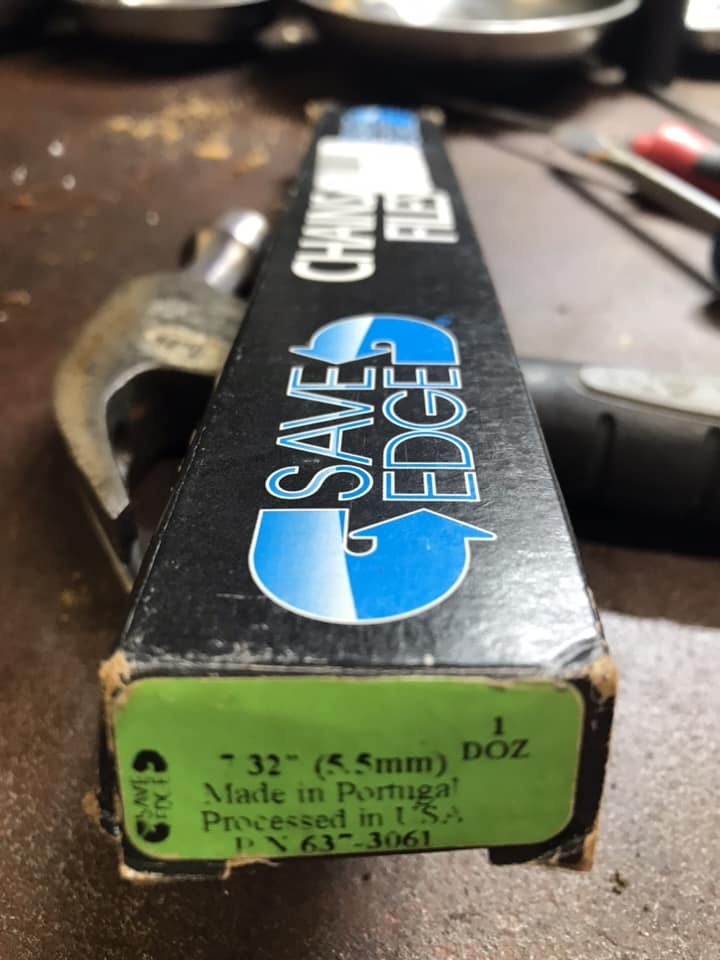

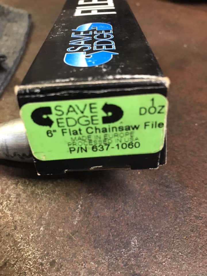

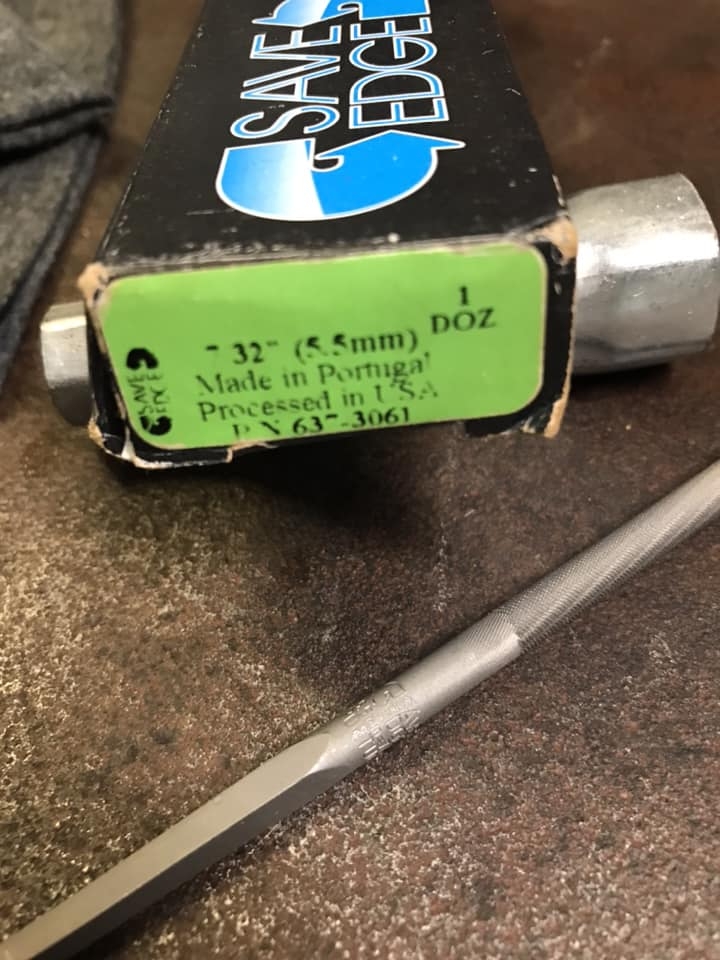

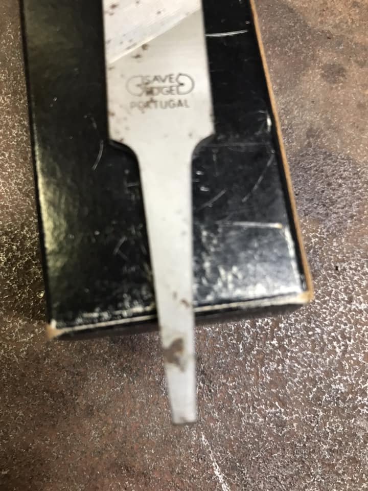

View attachment 5256003View attachment 5256004View attachment 5256005View attachment 5256006
Made in Portugal. Cool. Probably made by the Tomé Feteira factory, which is only 10 to 15 miles away from me. In there, in the top with the best files in the market.
