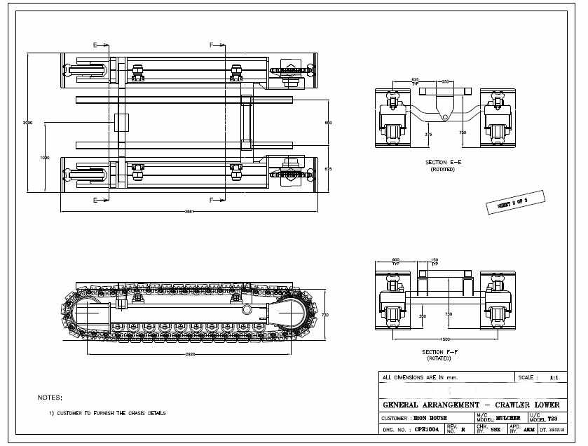

Just ordered the new oscillating track base for my mulcher project . It is 16 weeks ex factory and then shipping but Ive got some healing to do anyway . Everything is brand new on the machine so far , so now I don't want to spoil it by using a second hand engine so will choose a new one . I am having the track plates drilled before they are heat treated so that I can fit Urethane or rubber track pads so crossing roads will not be an issue .

Tried to read the dimensions on the design draft for the chassis and couldn't make it out.
How big is it?

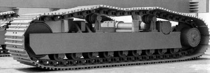

Thank you Hookblock , it's even self powered . It's hard to believe how hard it is to find an excavator track base , they are snapped up quick for mounting drilling rigs on .
AKfish , it is 3 metres/10 feet long . It was a bit longer than that but I now want to overhang the engine a little more rearward to counter balance the cutter head and take some weight off of the front idlers , so have cut it back .

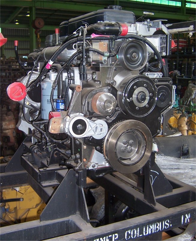

I have a few engines to check out when I'm back on my pins . Both the Cat and Cummins 24 valve are around 300hp and are light weight . The Cat comes as a Yacht pack , it comes complete with a forward/reverse transmission ready to just drop in the hole . A Jack shaft from the trans to a carrier bearing at the front of the machine and then a 2500 series PTO shaft with CV's to the head .
