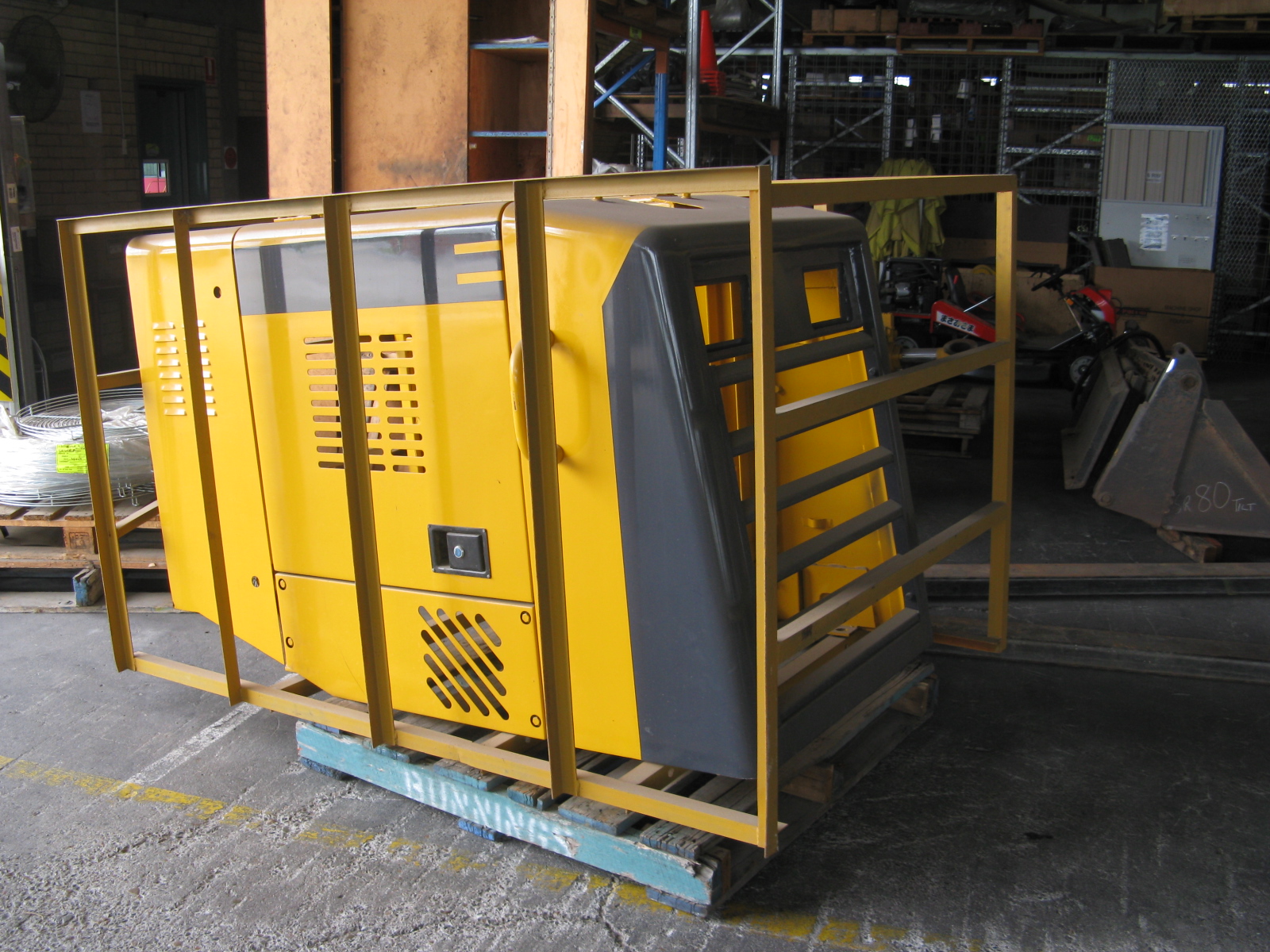

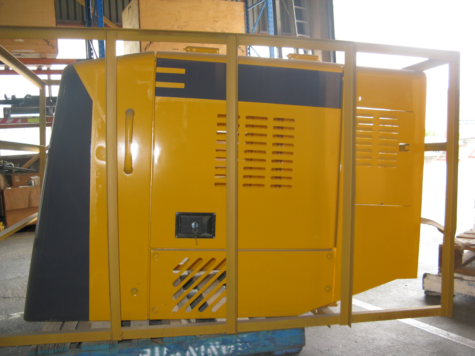

I was thinking today , what am I going to do for an engine hood ? Just checked my emails a minute ago and the company I bought the cabins off had sent some photos of a Loader hood I may be interested in......Just now finished doing a bank transfer so I did not miss out . It's even painted the same colours as my excavator , how goods that . All I need now is a bit of luck at the truck auction and a reply about the track base .
I just hope you dont underestimate the challenges of a CAN bus system or CPU controlled engine... Or that the components you buy, arent electronically controlled. ;)

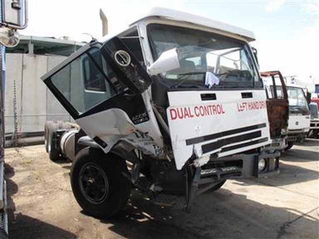

The damage details on thier online auction site said damage was only on the right and left side of cab and broken glass and the appropriate photos to back it up . Yesterday I had arranged for some other photos myself as they are all shonks . I was shocked to find the photos revealed a broken flywheel housing and a broken bell housing as well as other major damage . I emailed them and told them to disregard my bid . So i'm still looking when I get back on my feet so I can see for myself . I'm still getting used to this new age , no one can be trusted .

Oww, you really know how to post serious damage photos. They give me goosebumps just thinking about them :)
You dodged a nasty brick, there! :eek:
