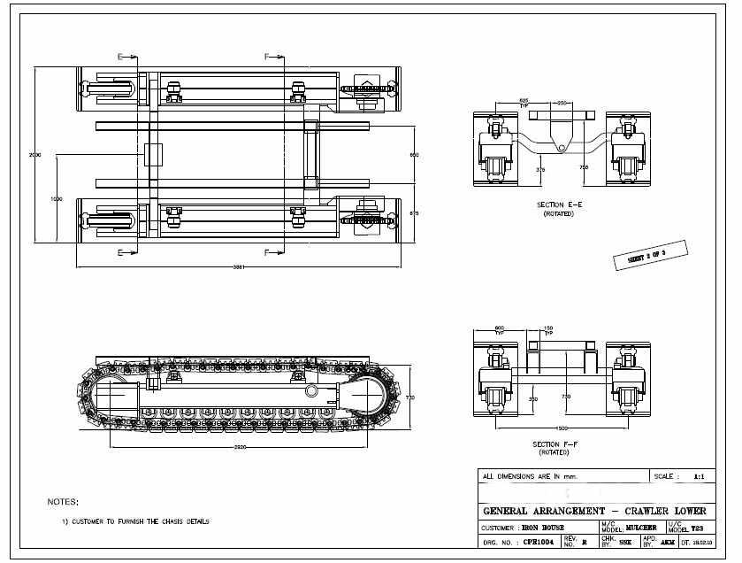

Just ordered the new oscillating track base for my mulcher project . It is 16 weeks ex factory and then shipping but Ive got some healing to do anyway . Everything is brand new on the machine so far , so now I don't want to spoil it by using a second hand engine so will choose a new one . I am having the track plates drilled before they are heat treated so that I can fit Urethane or rubber track pads so crossing roads will not be an issue .

Tried to read the dimensions on the design draft for the chassis and couldn't make it out.
How big is it?

Thank you Hookblock , it's even self powered . It's hard to believe how hard it is to find an excavator track base , they are snapped up quick for mounting drilling rigs on .
AKfish , it is 3 metres/10 feet long . It was a bit longer than that but I now want to overhang the engine a little more rearward to counter balance the cutter head and take some weight off of the front idlers , so have cut it back .

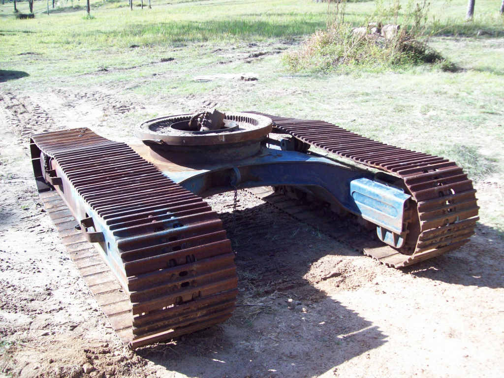

I'm sorry chaps , Ive been away from the site for a while .
After the accident and subsequent loss of earnings , I had no choice but to cancel my order for the new track frame . However , I have since bought a low hour excavator track base from a machine that was involved in a fire . I will cut 700mm (27.5") out of the center section next week so as to make the tracks 1900mm(75") overall , the 2000mm(79") wide mulcher I will build for it will then clear a wider area for the tracks to enter unobstructed . This makes for a steady forward pace as you don't have to keep reversing too take another bite to clear the tracks . I have also just bought a tip/dump truck that was involved in an accident and has a broken dead axle that I need to repair . I cant seem to help myself and slow down and heal , my gammy old leg aches of a night time and keeps me awake so I should be listening to my body but am to stupid for that .
