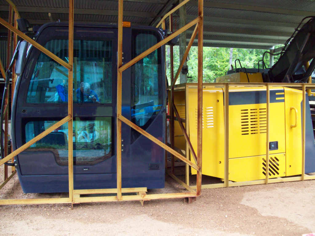

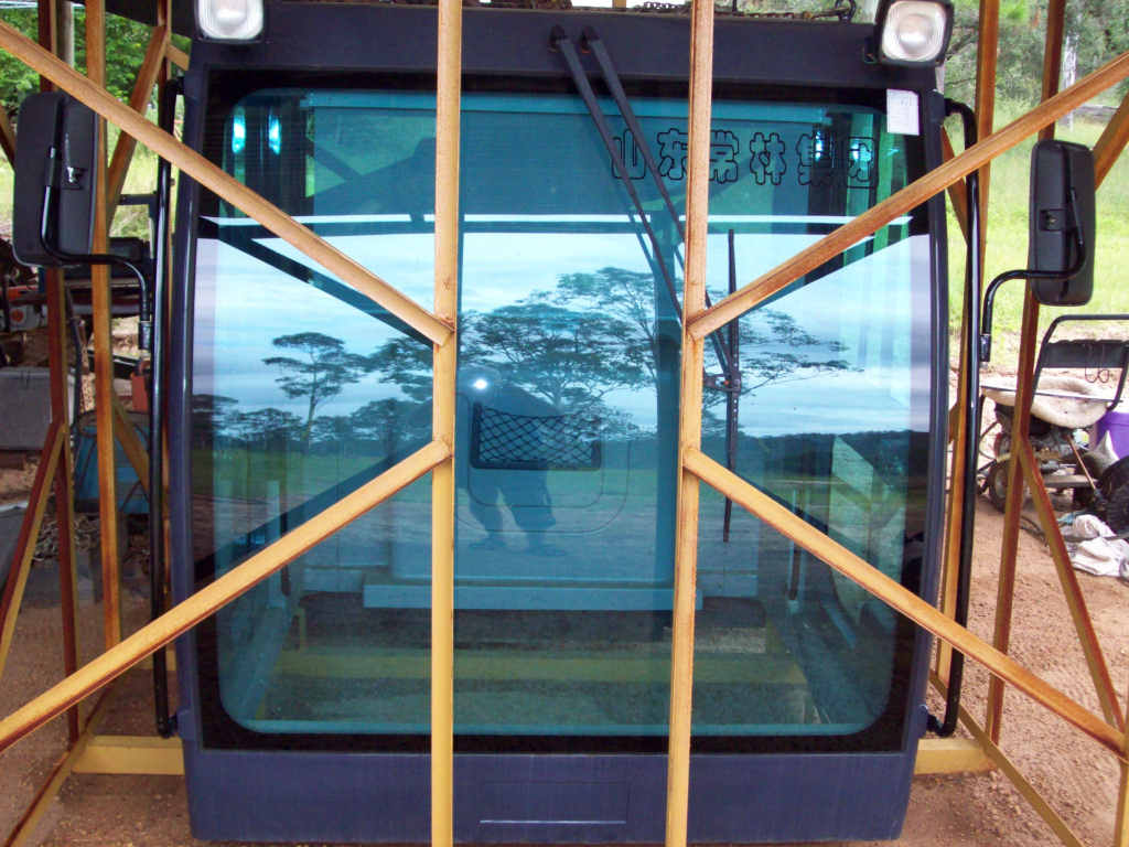

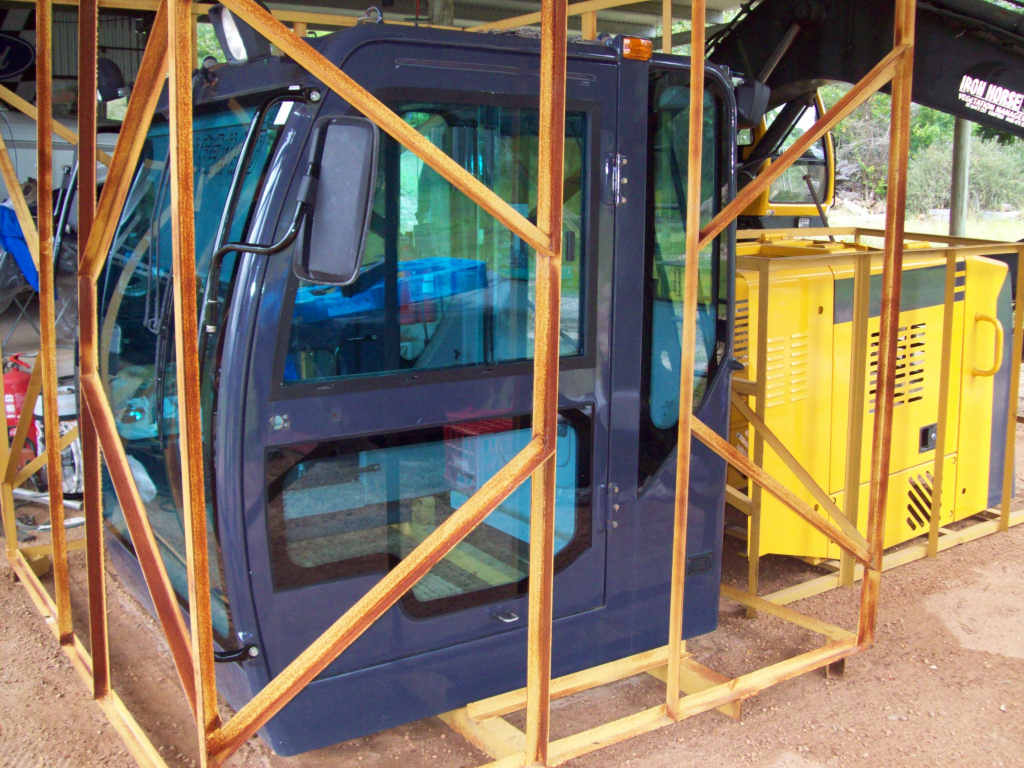

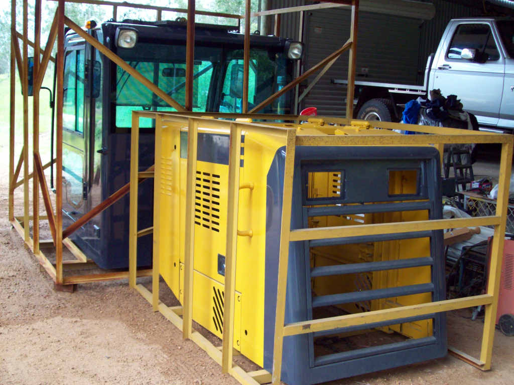

I havn't done anything to the machine as you would all imagine , but I have some photos of the cabin and hood together which may wet your wistle for a while .:D It gives an idea of what it will look like when finished .

Getting a little bit more back to normal? The combo pics look good. I see you ordered the custom logo lettering :D No blackout window tint? :)

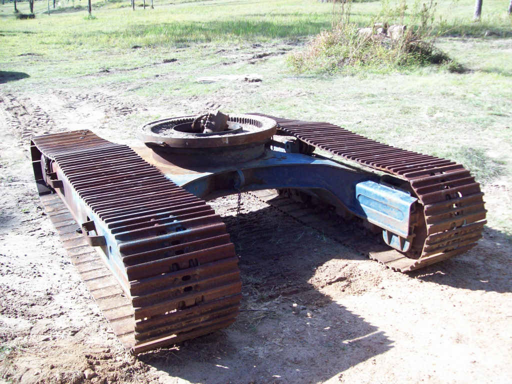

After the accident and subsequent loss of earnings , I had no choice but to cancel my order for the new track frame . However , I have since bought a low hour excavator track base from a machine that was involved in a fire . I will cut 700mm (27.5") out of the center section next week so as to make the tracks 1900mm(75") overall , the 2000mm(79") wide mulcher I will build for it will then clear a wider area for the tracks to enter unobstructed . This makes for a steady forward pace as you don't have to keep reversing too take another bite to clear the tracks . I have also just bought a tip/dump truck that was involved in an accident and has a broken dead axle that I need to repair . I cant seem to help myself and slow down and heal , my gammy old leg aches of a night time and keeps me awake so I should be listening to my body but am to stupid for that .
jayste , the new F250 cabin I used was from the US and was LHD , it was a huge job to bring that wheel across . You blokes that drive on the wrong side of the road cause us no end of headaches when we bring your vehicles over here .:confused2:
Thank you also Renze and MarkV , I know how it is when your wanting to see more done and it feels like it's taking forever so I hope to ad some more pics soon .
