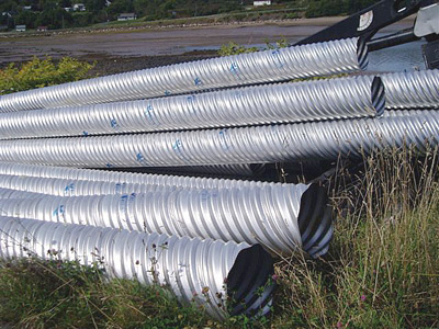

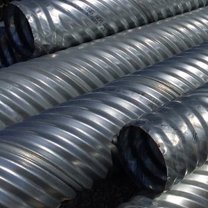

The pontoon cylinders need to be larger diameter and you need more, shallower screw vanes.

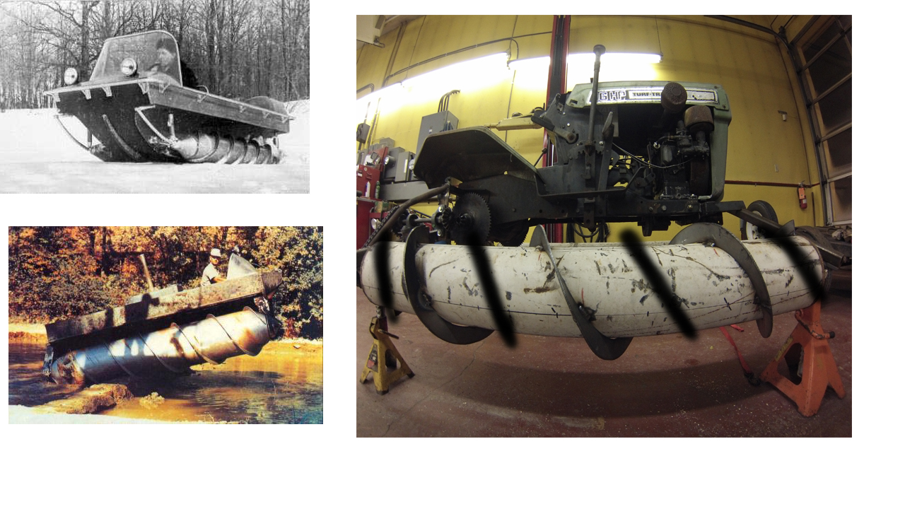

   / Screw drive garden tractor
#71
yeah I've seen that one, i don't think there is a video of the top left machine sadly....
