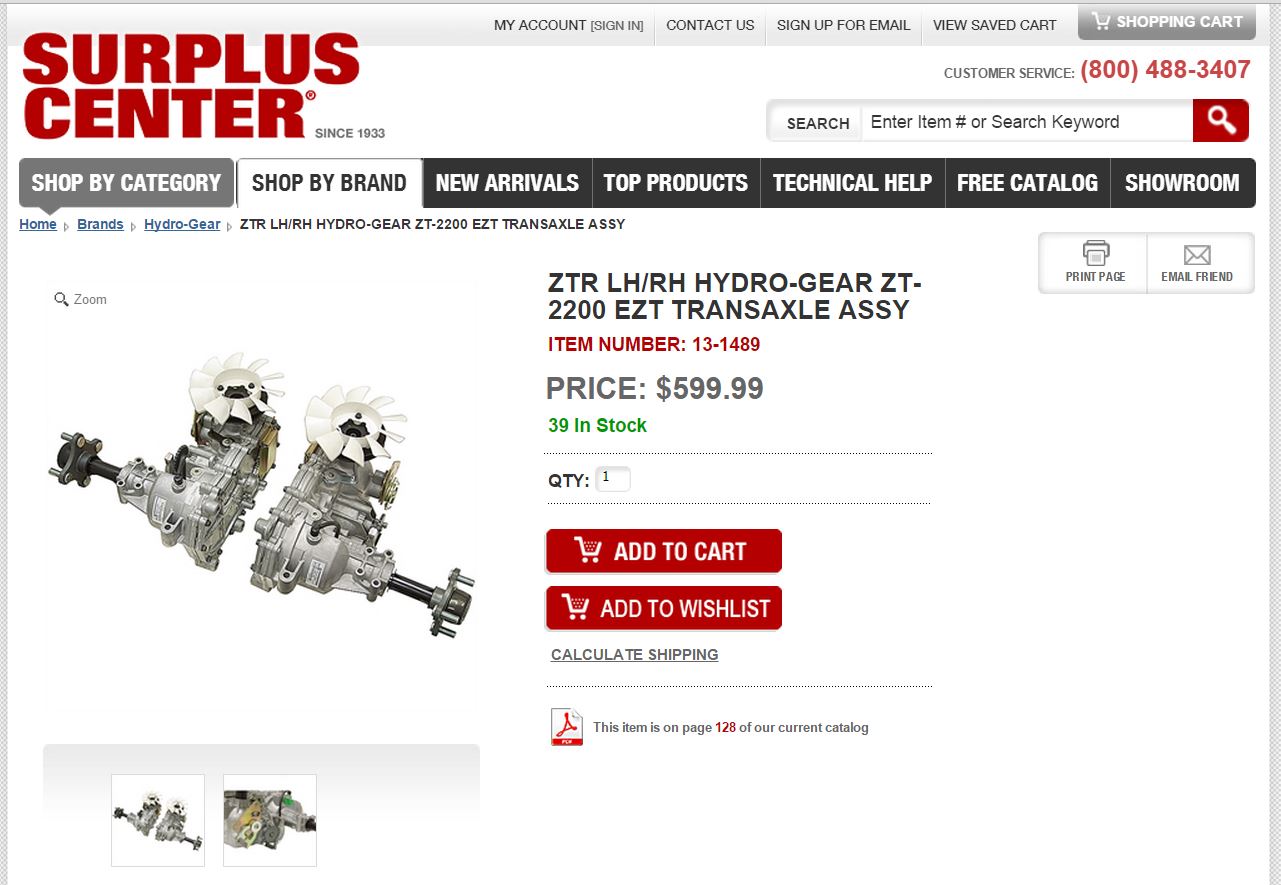

Looks like Surplus Center sells the ZTR transaxles for $460-600 per pair (Surplus Center)
Aaron Z
Don't need a pair. Left and right drives are independant.
That sounds like a pair to me. A pair of shoes is one right and one left.
Here is a pair of ZTR transaxles.

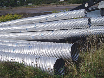

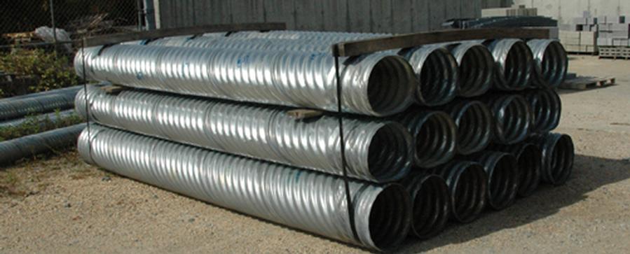

For pontoons I wonder if you could just take some culvert (the stuff that looks like a screw) and weld some ends on it to make it float.
   / Screw drive garden tractor #27
I don't think culverts are actually "screws." I believe they are just convoluted, so they would just spin with no forward propulsion.
   / Screw drive garden tractor #28
<img src="http://www.tractorbynet.com/forums/attachment.php?attachmentid=410360"/>
All the ones I had seen 'till now were one housing. The two separate housings would be better, as you could turn them to have the output shafts inline with the screws. Then just a few sprockets to couple the output to the screws.
There are three levels of those transaxles (from lowest to highest quality):
1. One housing for both sides
2. Separate housings
3. Separate pumps and wheel motors
Not all culverts have a screw pattern, but I've seen some that do.
Example:
   / Screw drive garden tractor #31
Some are made this way.
Too slow again, jjsjeff posted while I was looking at google images.
   / Screw drive garden tractor #32
Example:
<img src="http://www.tractorbynet.com/forums/attachment.php?attachmentid=410380"/>
<img src="http://www.tractorbynet.com/forums/attachment.php?attachmentid=410383"/>
<img src="http://www.tractorbynet.com/forums/attachment.php?attachmentid=410384"/>
Well I stand corrected... in that case, those look like they would work nicely.

I'm guessing they wouldn't work very well for more than one reason. The most serious is ou'd need to find righ and left hand culverts. To travel, the pontoons need to rotate in opposite directions. Otherwise, the tractor will travel sideways.
