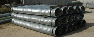

   / Screw drive garden tractor #54
I'm guessing they wouldn't work very well for more than one reason. The most serious is ou'd need to find righ and left hand culverts. To travel, the pontoons need to rotate in opposite directions. Otherwise, the tractor will travel sideways.
The shipping costs would be a killer. You'd have to get one fr south of the equator!! :D

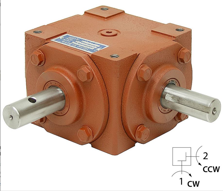

   / Screw drive garden tractor #60
Too bad these cost so much: https://www.surpluscenter.com/Top-Products/1-1-32-HP-RIGHT-ANGLE-GEARBOX-13-1423.axd
