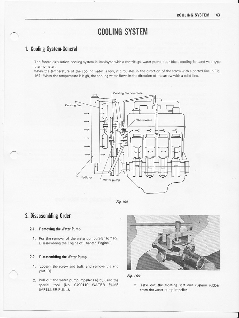

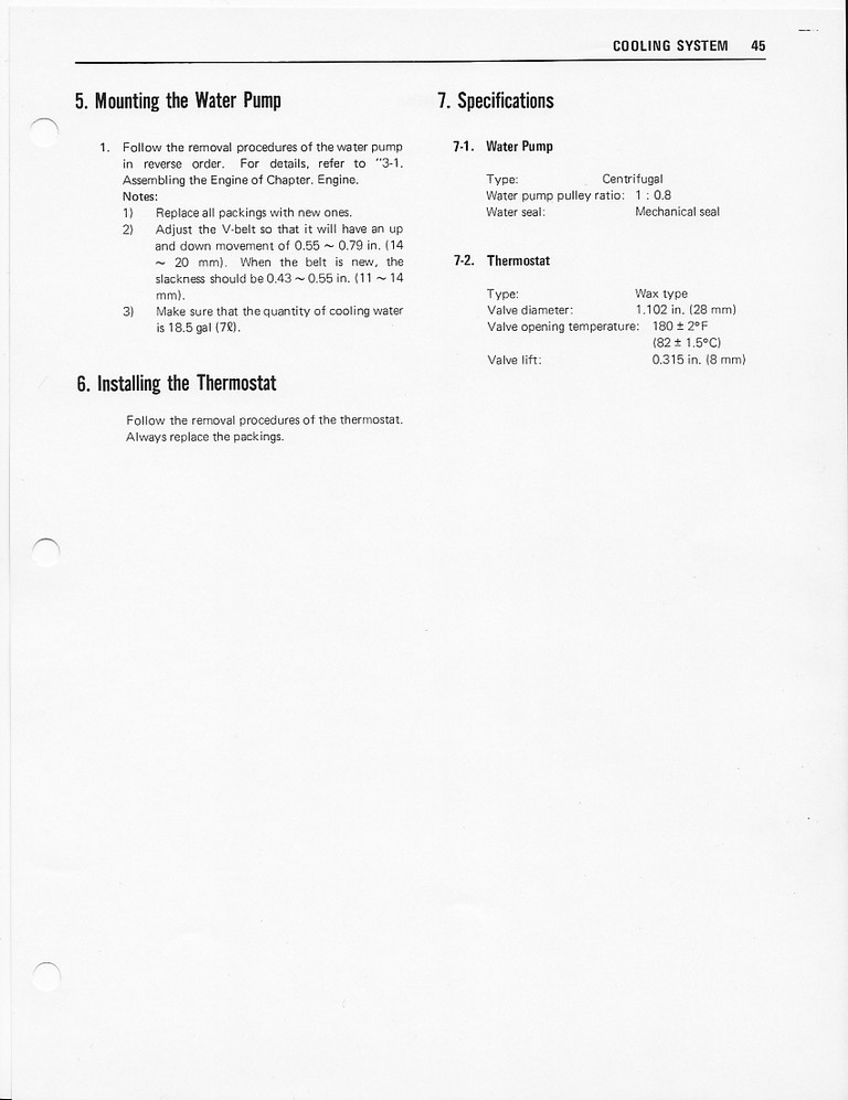

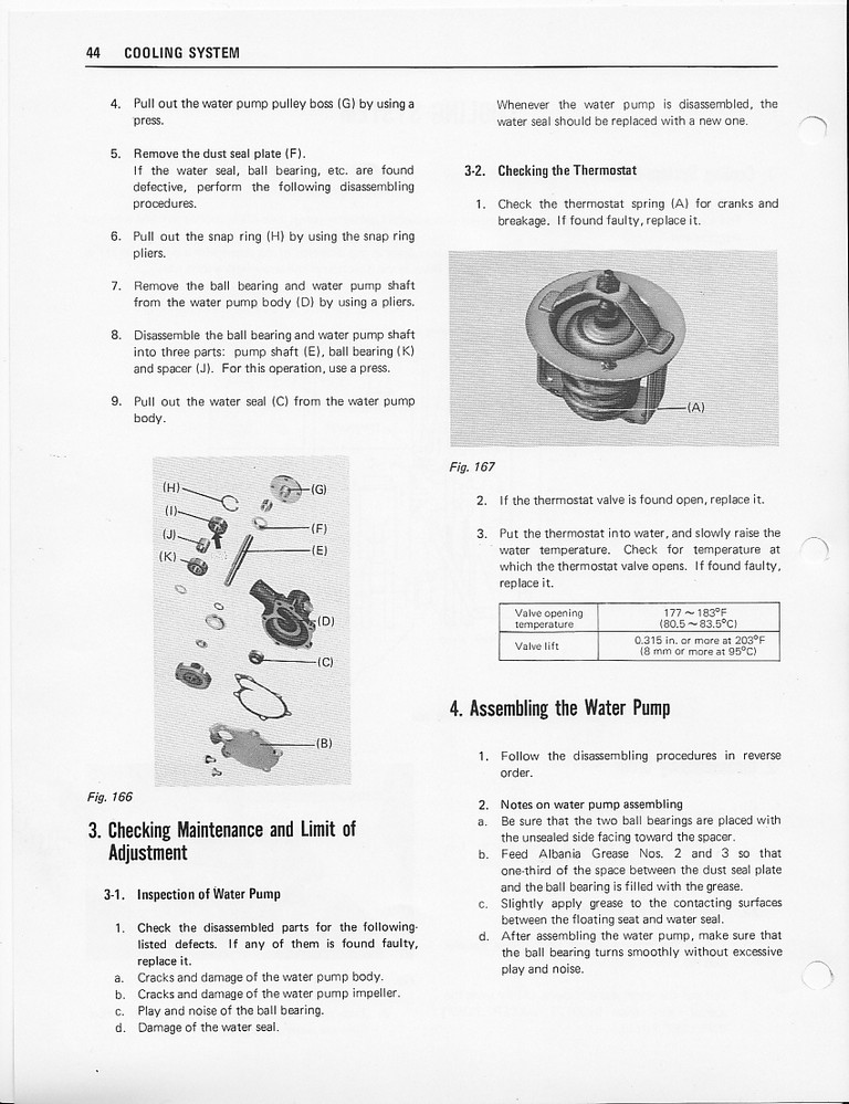

This is what sum total of the repair manual on the subject. Three pages. I hope this works as attachments 'cause I never tried it before.
The sending unit is on the fitting at the intake manifold.

No one has mentioned the radiator cap. It must be correct and tight. They are rated at certain pressures, and allows the water to go above 212 degrees without boiling.
I believe I would add another sender unit or mechanical sending unit to double check the temp.
In hot weather you really don't need a thermostat. They are designed to allow the engine to heat up to the correct operating temp.
Are there any bubbles in the radiator with the radiator cap off with engine at operating temp.
Is the hyd radiator separate from the water radiator, or is it on the bottom of the radiator?
